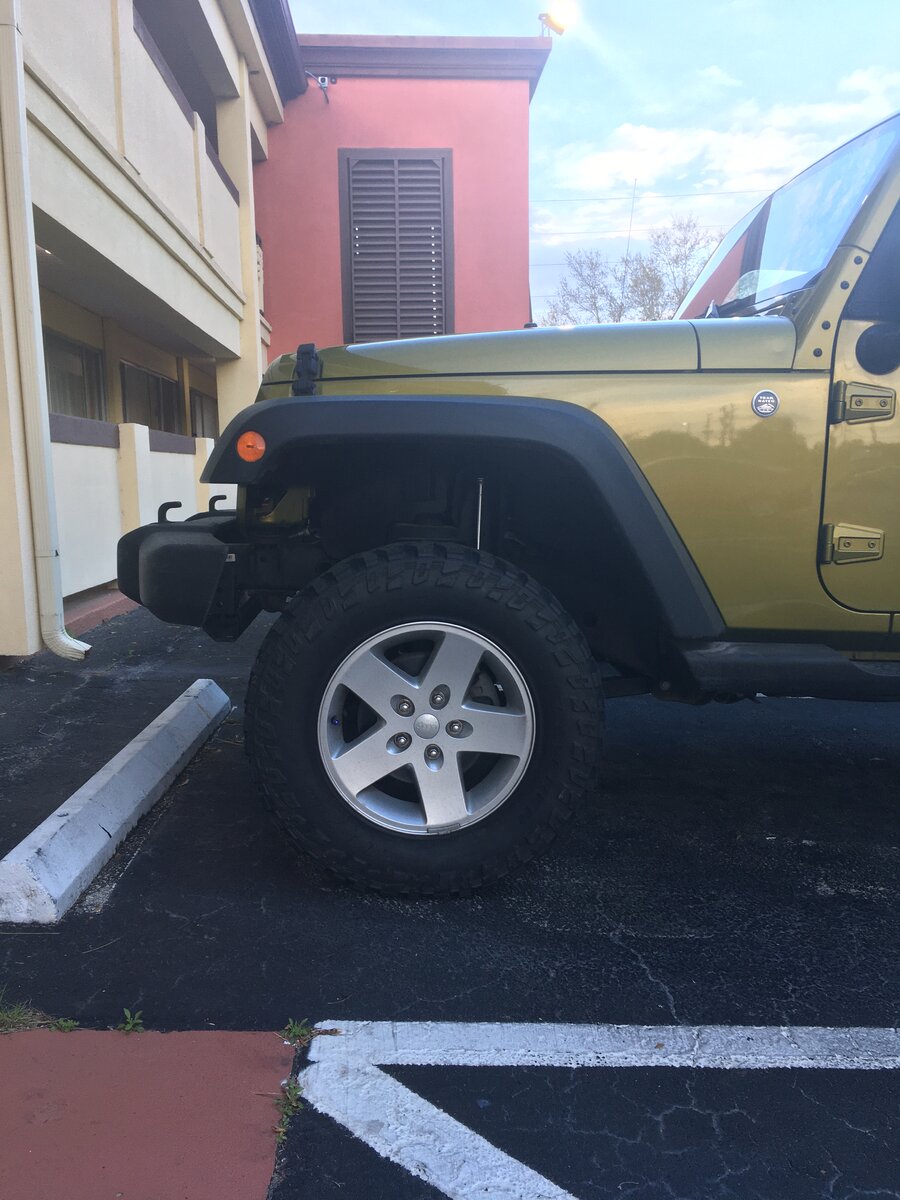

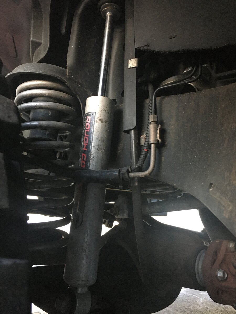

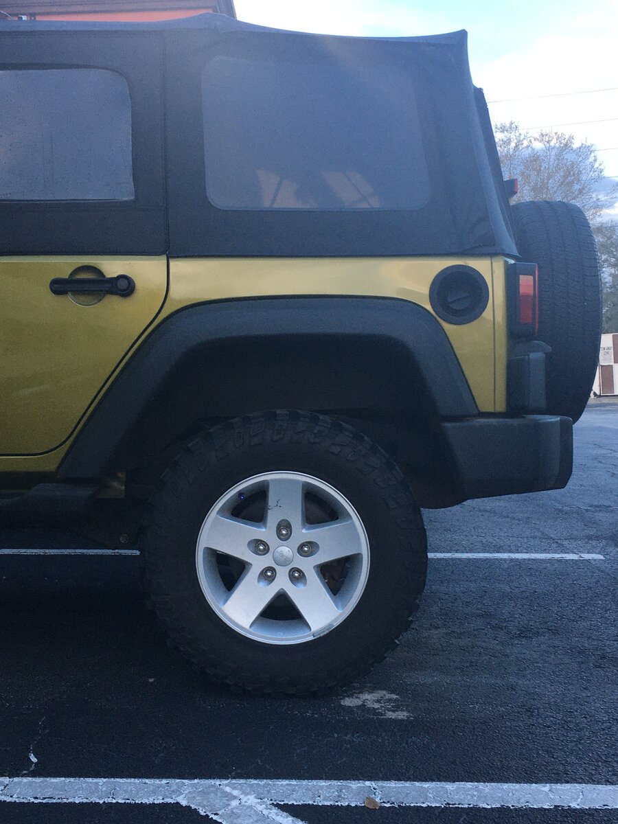

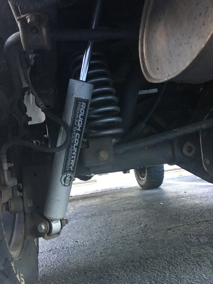

I've posted in the other discussion threads but never here so I figured this would be the correct place for my question. I bought my Jeep used and I know it has a lift but unsure of how much. It looks like I need a new front drive shaft but don't want to purchase one until I know the correct lift height of my Jeep. From what I can tell, everything is stock except the shocks and springs. The tires are 32s. I added some photos to help with this query. Thanks in advance Jeepers!!!
You always come through BLACKJKU!!! Thanks, I asked a question in that thread by the way. What is top of the "spring perch"? Is it the spring itself or the housing the spring sits in? Not that would matter much, we're talking 8ths of an inch probably.
According to the red arrows it's pointing at the lip at the top and the flat on the bottom side. You could always get the measurements of both of the locations to verify your findings are the same.
Measured this morning. 12 5/8 - 9 3/8 = 3 1/4” lift. I thought that was an odd lift height. I looked up rough country 3 1/4” lifts and the do sell it. Man, it’s weird they didn’t upgrade the drive shaft or anything else such as control arms. The Jeep drives great so I don’t suspect anything out of whack. Maybe they didn’t off road? I know I have to replace the drive shaft because I off road often. Thanks for the help again.
