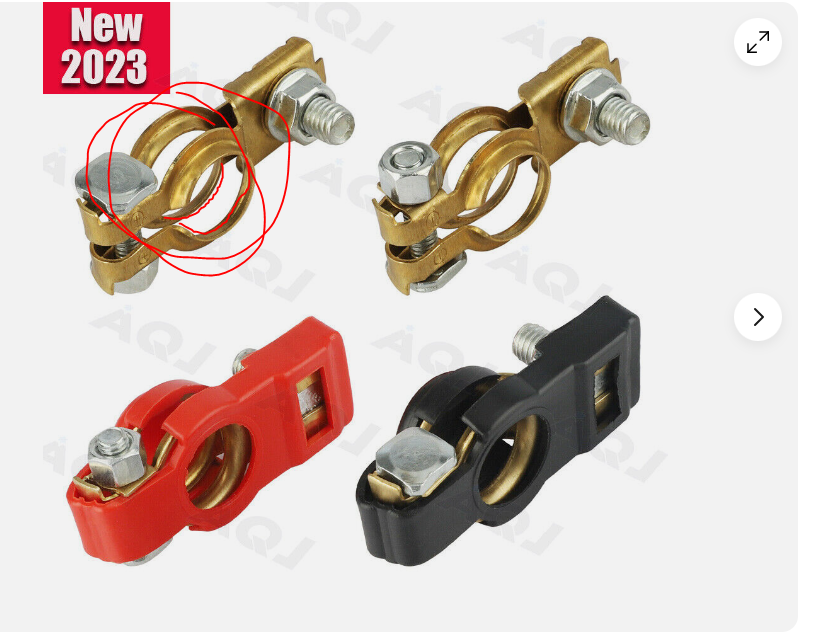

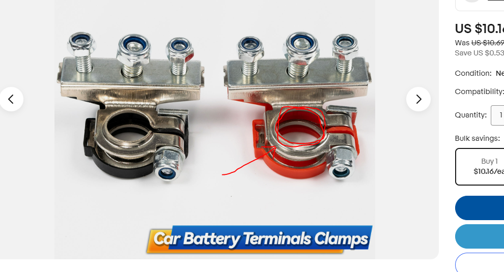

Also what do you think about these terminals? I have a lot of accesory wires so this seems good
https://www.ebay.com/itm/3145985553...d=link&campid=5337789113&toolid=20001&mkevt=1
Or I could go with something like this https://www.ebay.com/itm/3348522542...d=link&campid=5337789113&toolid=20001&mkevt=1
IMO, these options are just as terrible as the factory clamps due to the limited contact area between the clamp and the post.
Notice the only areas that actually contacting the post are the EDGE of the area circled below:
Cheap folded metal instead of a solid clamp like the one I posted previously.

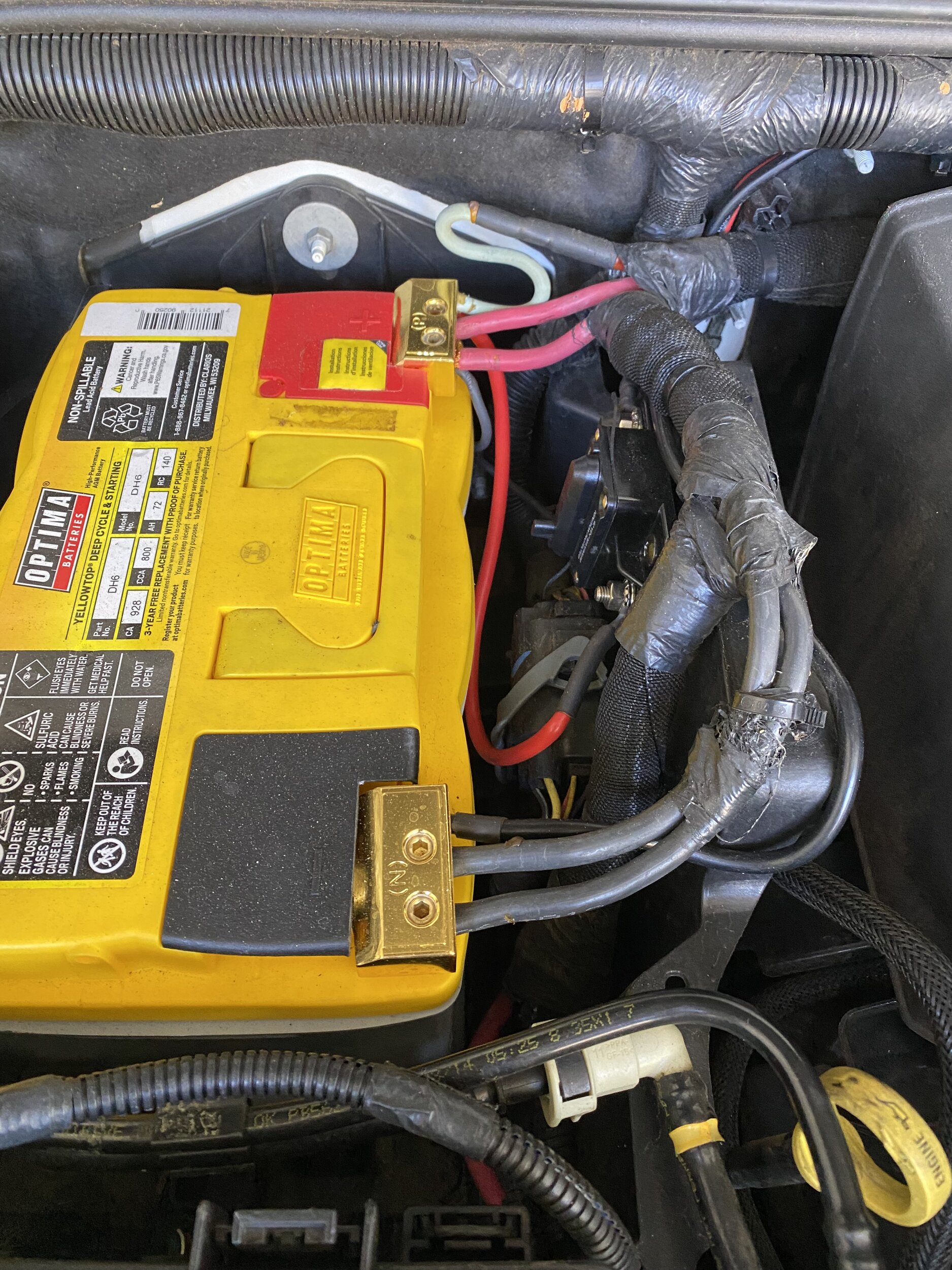

Would you mind posting a pic of how yours look with the new terminal ends? Or link if it is already posted elsewhere... Thx!
These are the clamps that I used:
https://www.autozone.com/batteries-...US:EN:AD:NL:1000000:GEN:pdp&vehicleId=2871501
They also have a matching one for the negative post that I didn’t see listed.
I trimmed the terminal covers to make them fit around the post/clamp assembly as best as I could, but I would prefer to have an actual cover like the silver clamp I referenced earlier.
You can see the #8 wire (appears to be hanging down) that I ran to the circuit breaker and the distribution block on the other side of the engine compartment for all of my accessories.

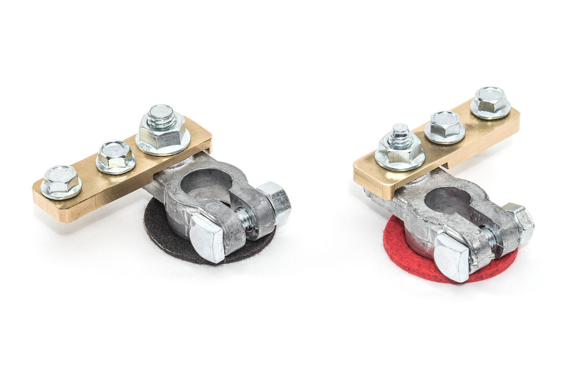

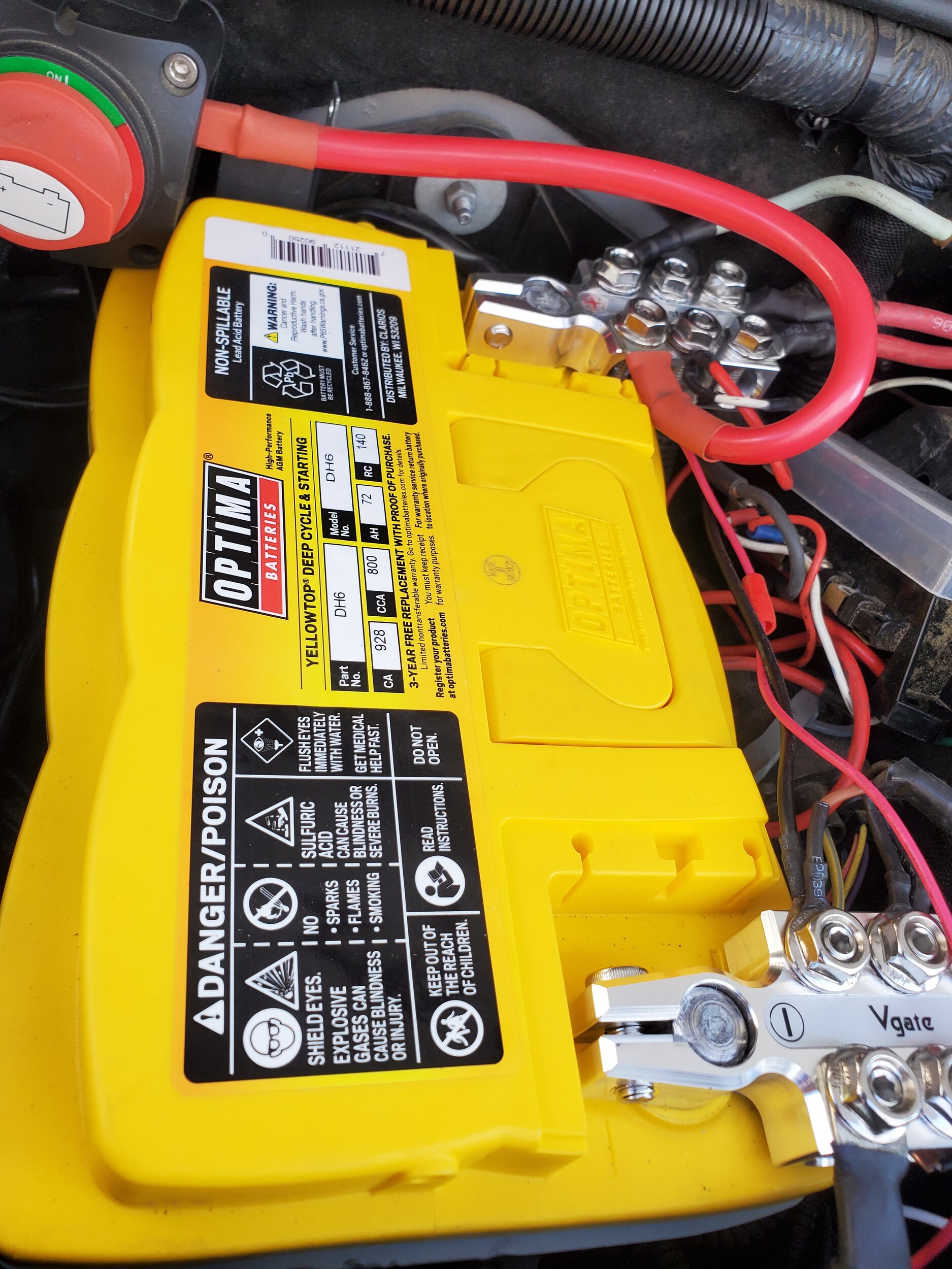

I'm running Yellow Top with Vgate terminals.
I bought a pair of these but haven't installed them yet. I thought they would be plug and play, but looks like I'll have to cut, strip, and crimp new terminals to the existing battery cables. Still debating if it's worth the effort since I haven't had any problems with my existing clamps.
It was worth the effort for me. The terminals are worth every penny.
