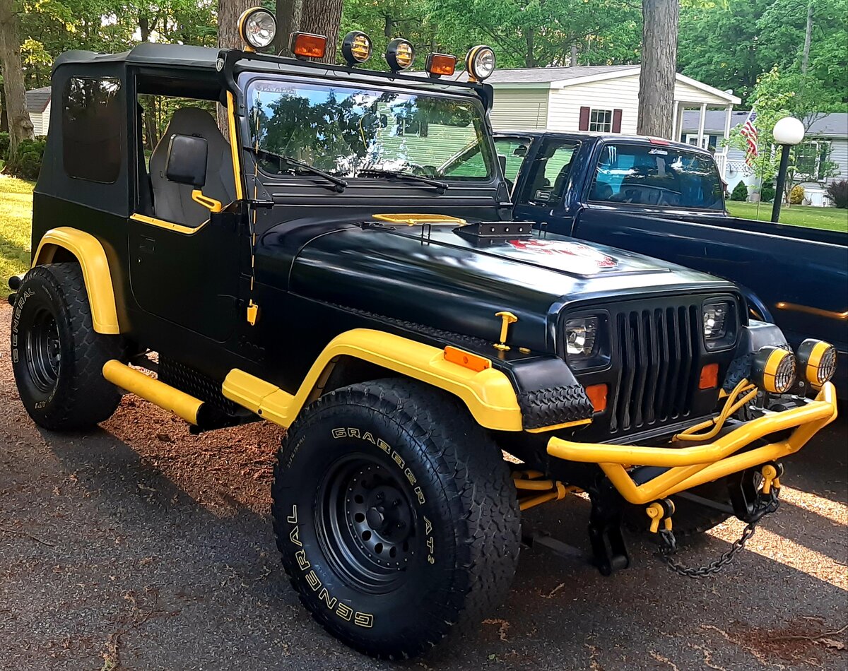

I bought this 95 YJ to restore and play with 1 1/2 years ago. Spent countless hours working on it and repairing everything I could and replacing what I had to. It sat for almost 5 years , so you know I had my hands full... So my trans goes in my truck so I had to put it on the road at 85% finished.. she is no show jeep , but she is definitely a one of a kind.. my problem is , she runs great for a while, then seems like something is holding her back, almost like the E-brake is on while you are giving it throttle, if you put it to the floor she bucks or dies out , but only SOMETIMES.. theres times she will climb hills fine, then theres times 18 wheelers and Prius's are passing me up them. Can't use 5th gear rarely ever. Even on a down hill if I put it in 5th I loose speed..so far this is what I have done to her.
