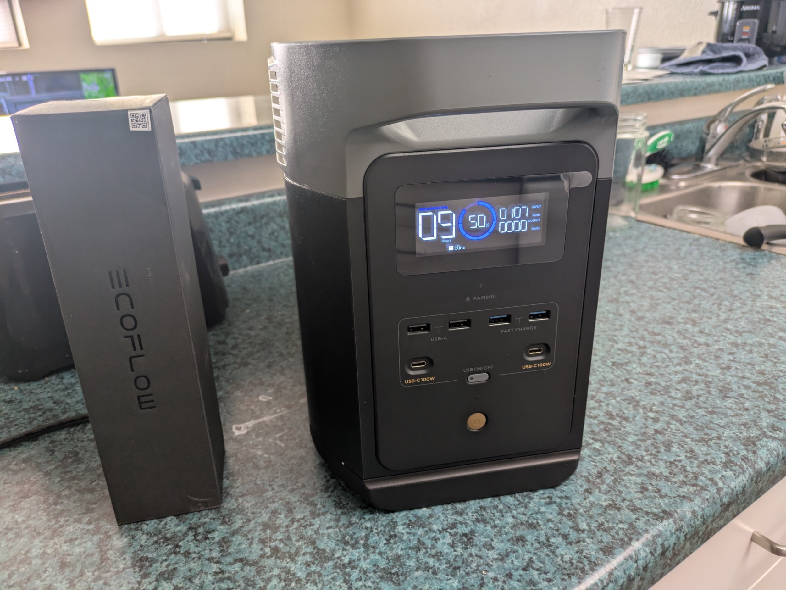

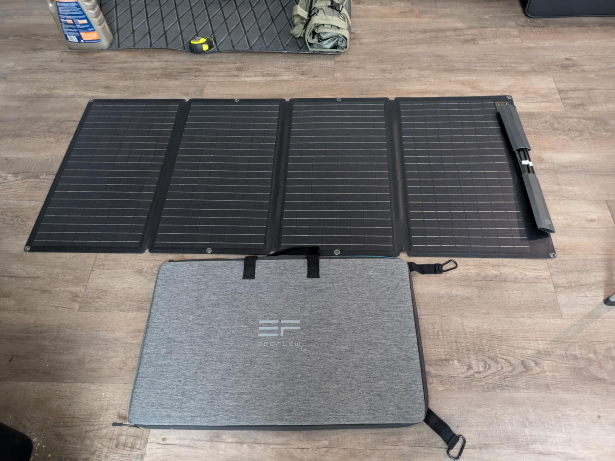

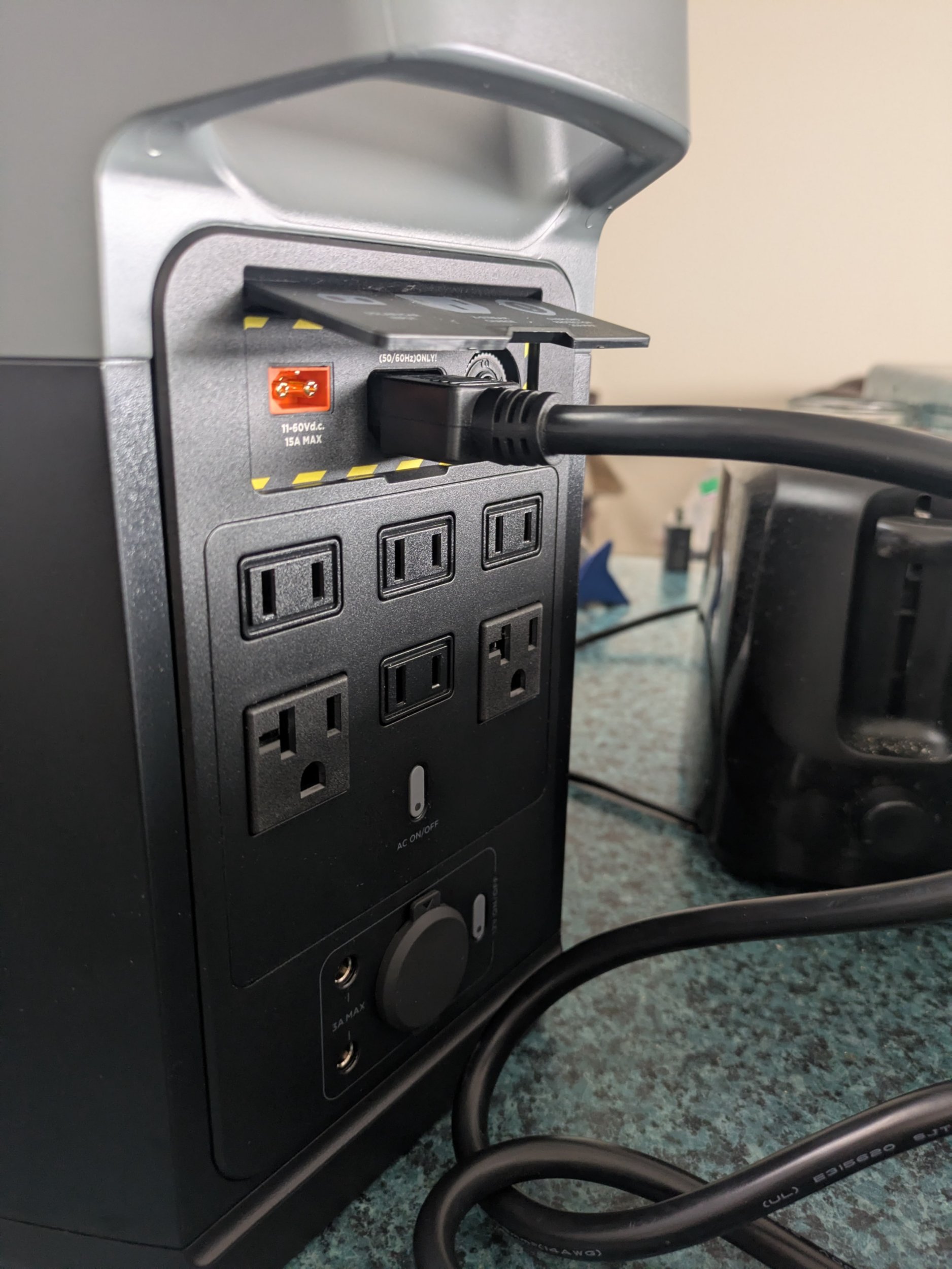

I picked up and Ecoflow Delta 2 battery and solar panel setup on a black friday sale for super cheap and will be mounting it on the second slide out next to the fridge. The next couple days are sub zero temps around here so I am going to wait a bit for it to warm up before putting it into the jeep.

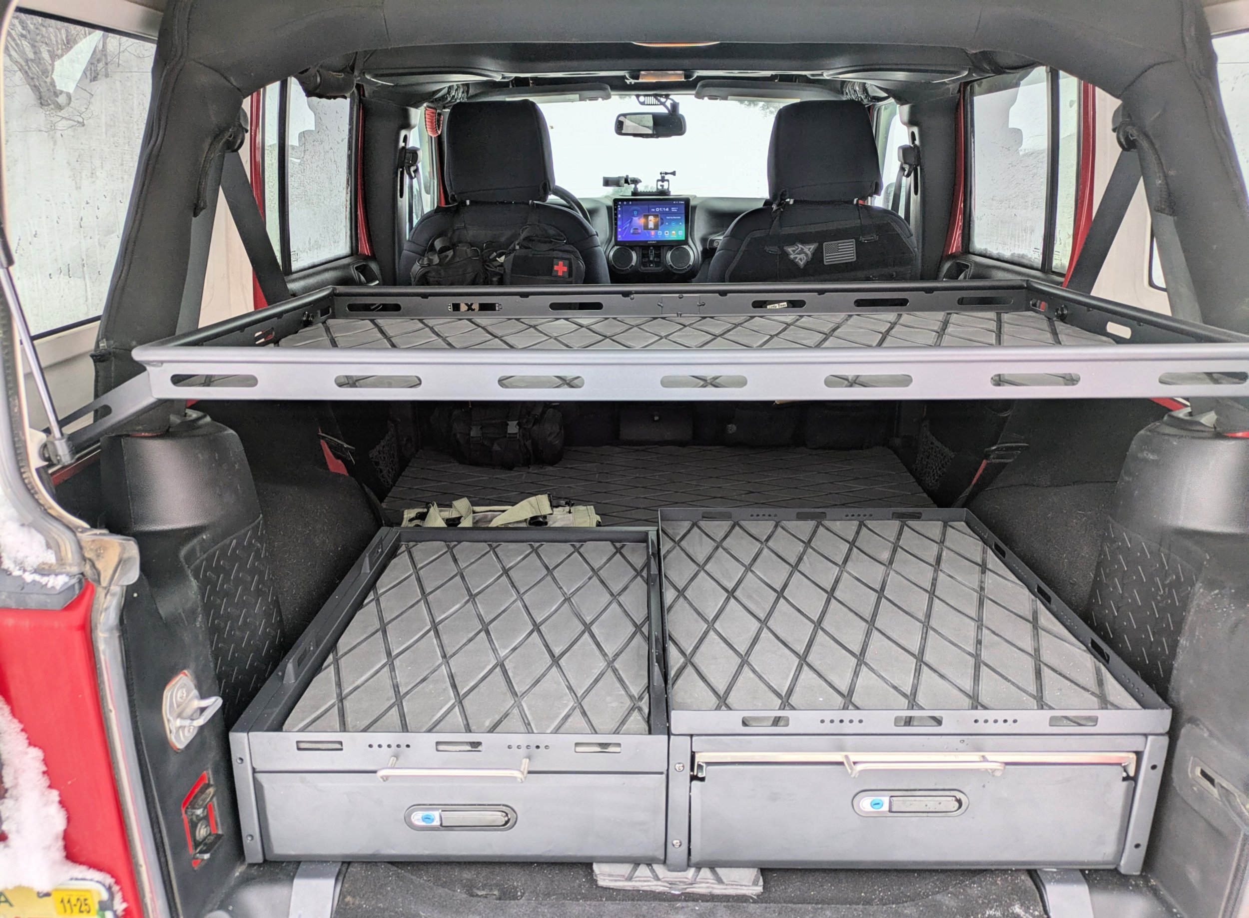

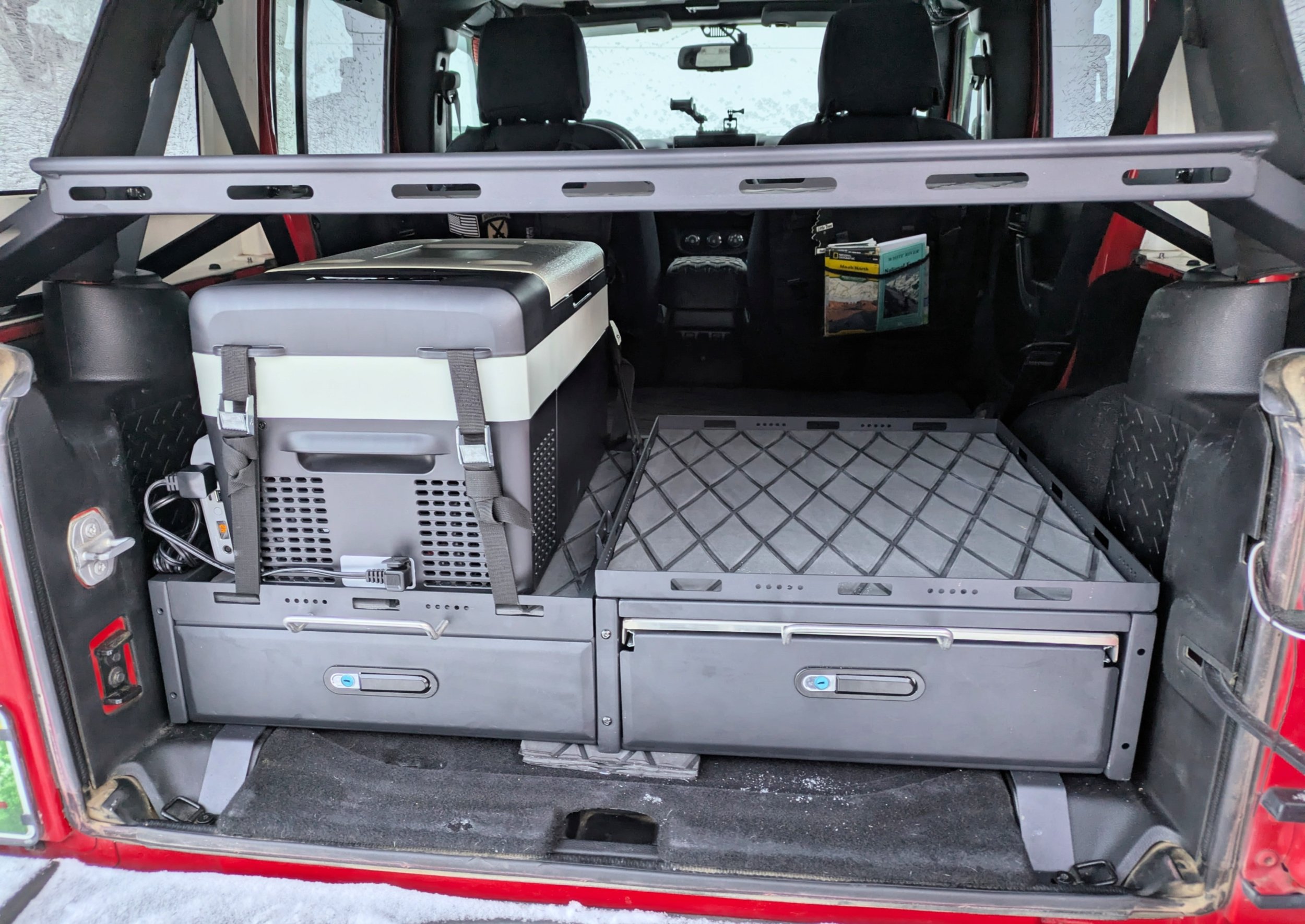

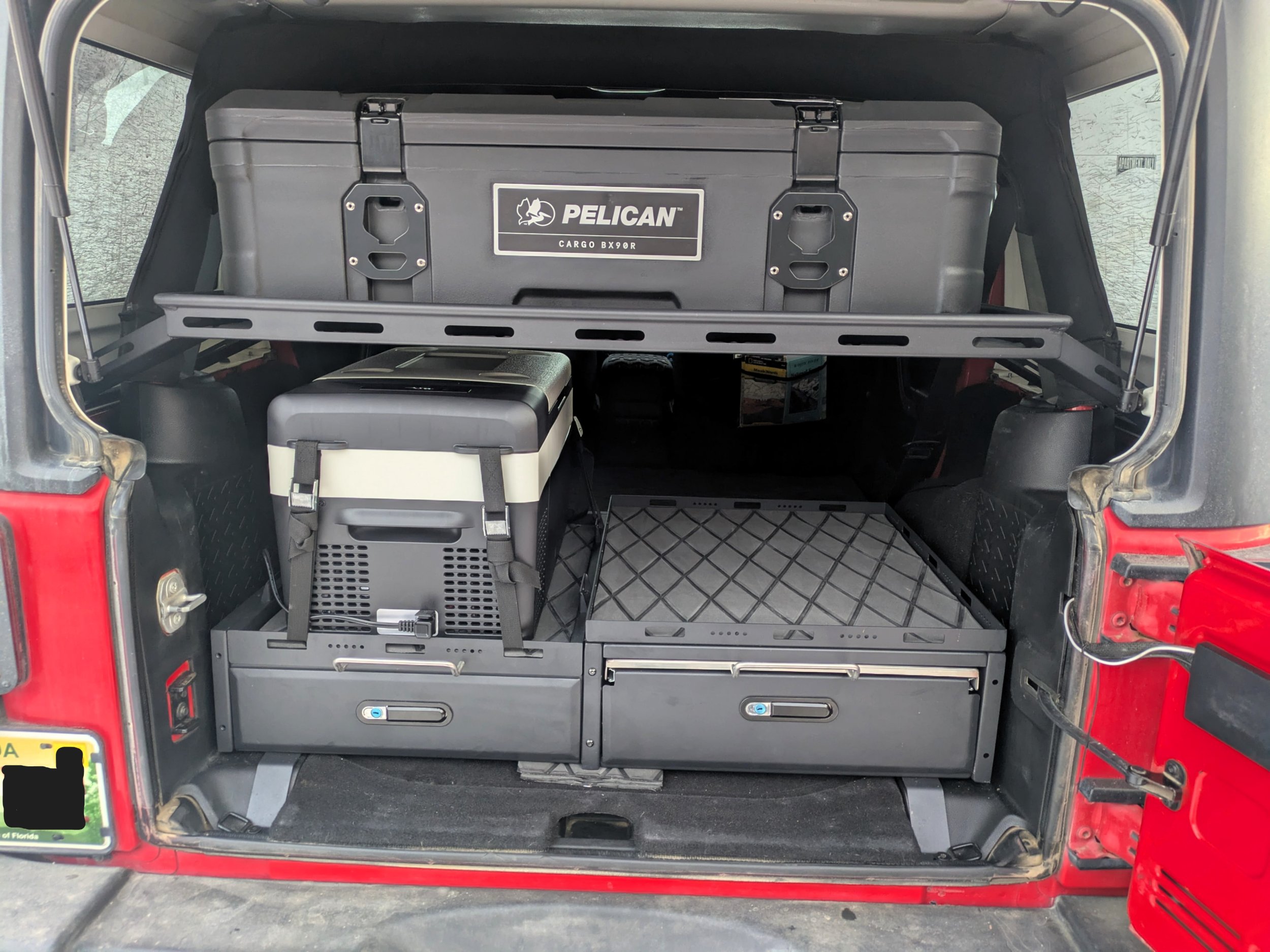

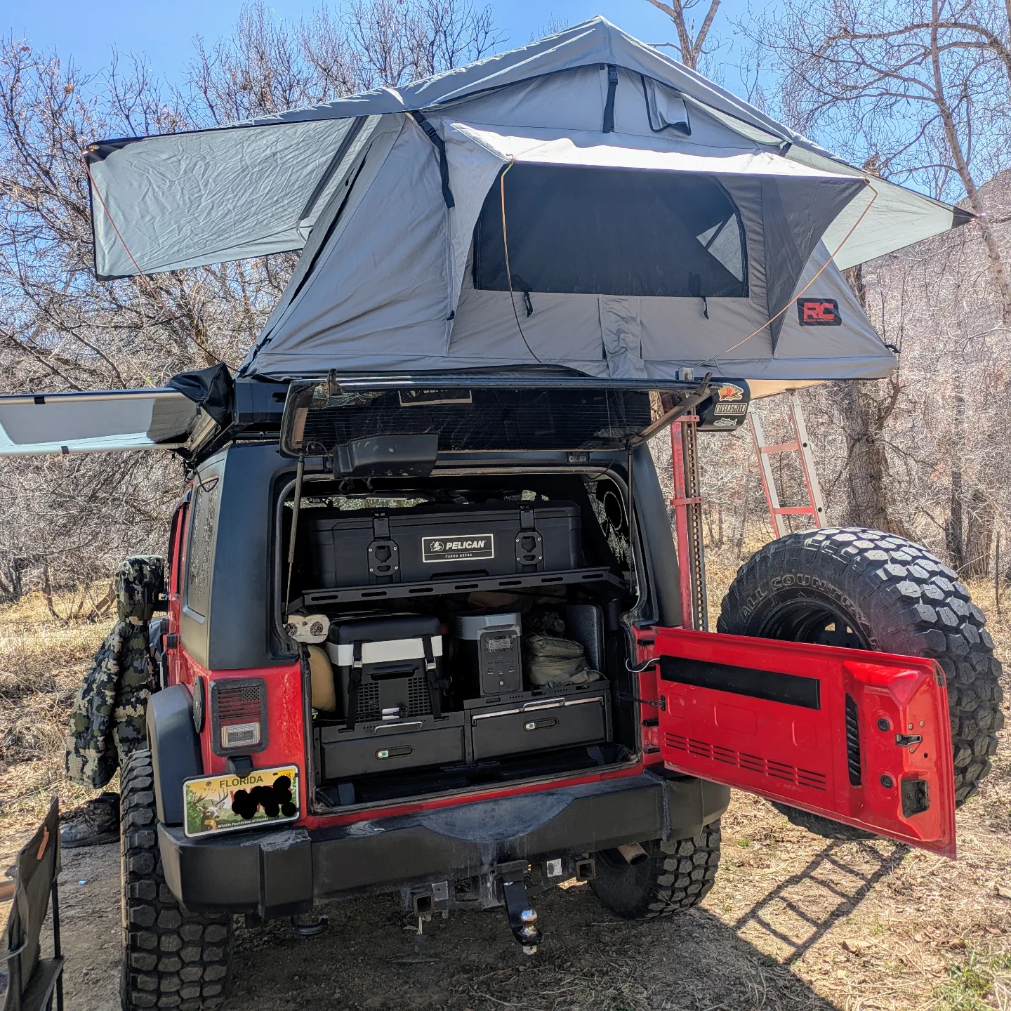

Got my Pelican cargo case in the mail today. I will say these are much lighter than the normal pelican boxes I am used to but still quality built.
Its almost a perfect size for the top shelf and still able to open most of the way. The Ecoflow will be mounted in the open space on the right drawer this weekend.
Really like the drawer/shelf system. How do you access the fridge? Does it slide? The power supply looks like it has plenty of uses and plenty of power. 85ah is a good number for overlanding, especially with that solar panel. Lunch time is a good time to soak up some power, an hour or so and you should be topped off.

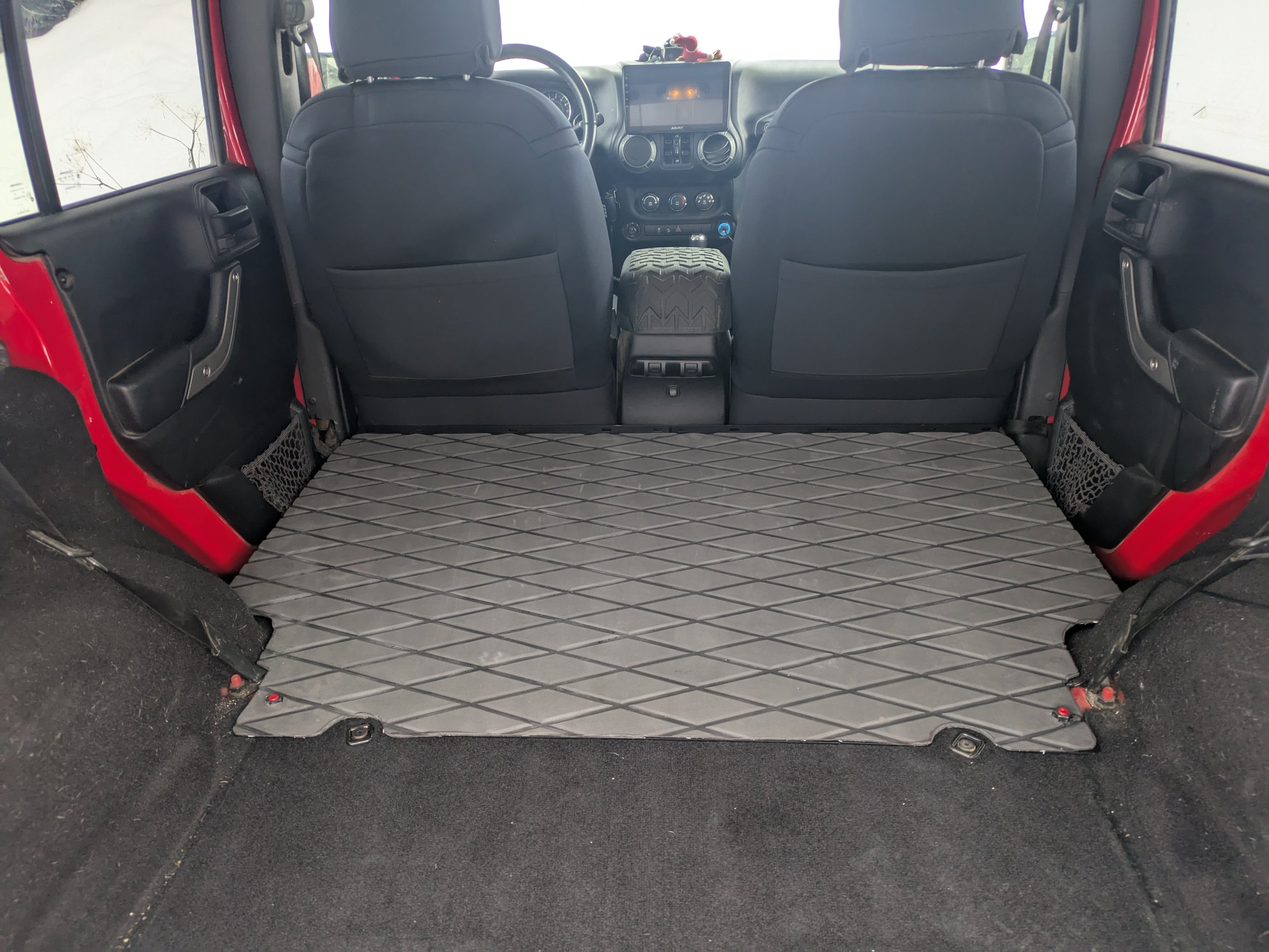

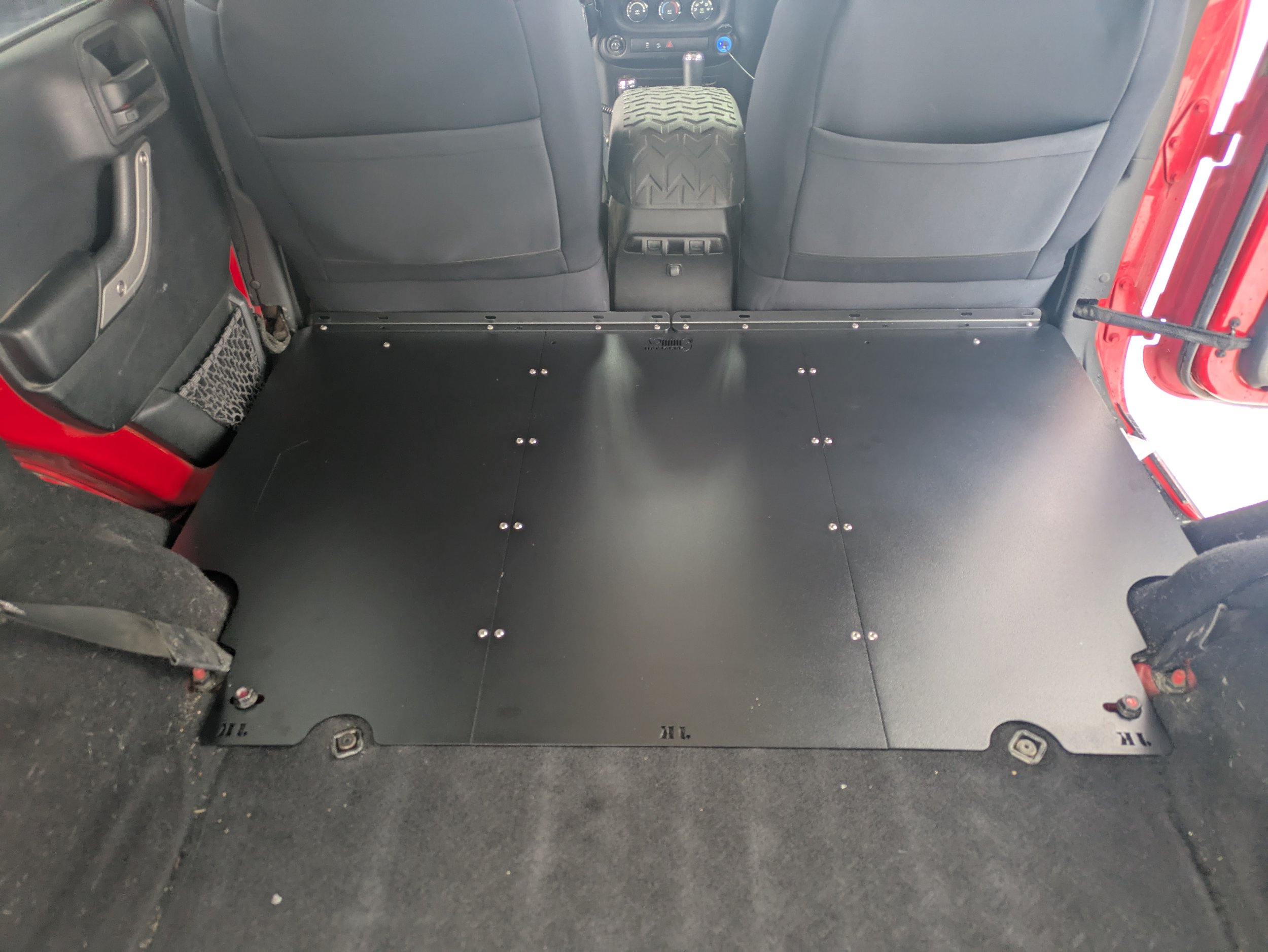

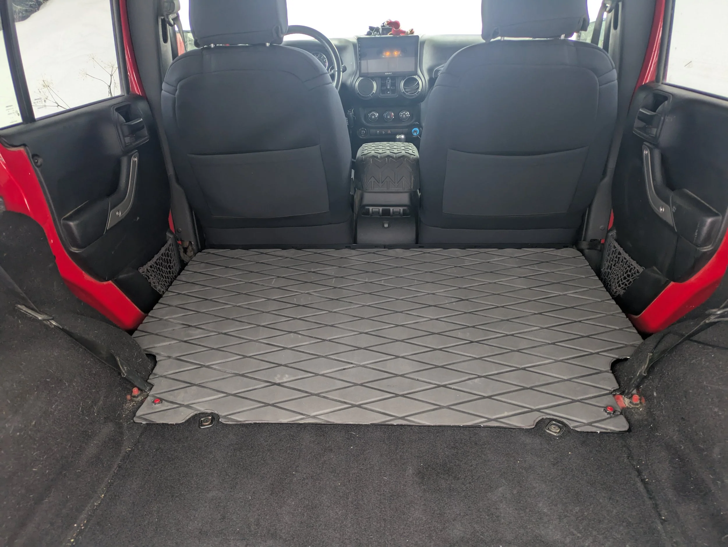

The seat delete platform is made by springtail solutions and is made of aluminum. It bolts to the existing seat hardware without any modification to the jeep. I did place some boat deck foam on top of it to help with noise and stuff sliding around.
The fridge is indeed mounted on a slide out and is easily accessed. I wish it came out just a few more inches but it does clear the upper shelf as is. Definitely excited to test out the solar and battery setup during easter jeep safari this year in Moab.

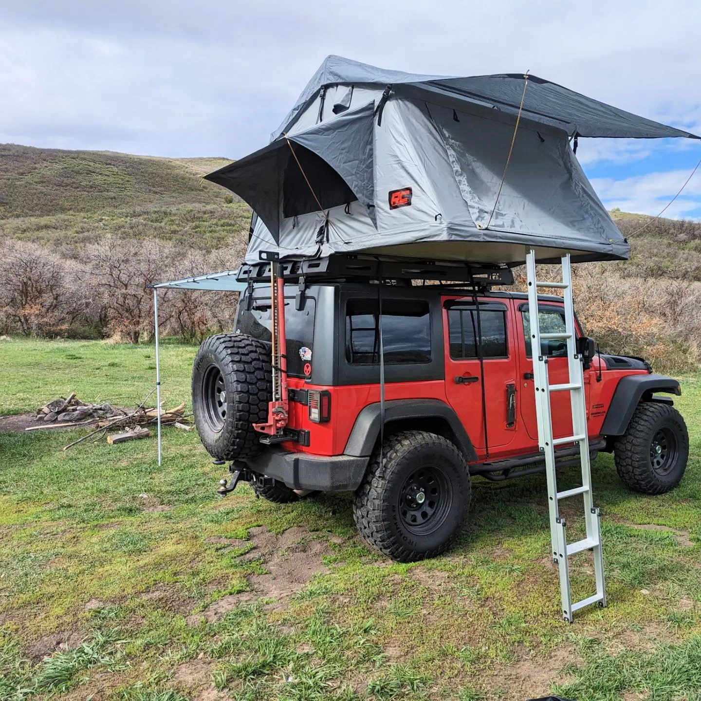

How do you like the Rough Country roof rack and RTT? I've been looking at this same setup but have been on the fence on buying or keeping my inside setup.

I actually love the combo. If you are rough on your gear or frequently have more than one person in the tent I would probably go with a rack with a backbone system rather than mounting to the rain drip rails.
Ive had the rack and tent for over a year and used it a couple dozen times and have had no issues. I have caught a lot of greif for mounting a tent to a rack that attatched to the drip rails as there is some confusion on static vs dynamic weight loads of these hard tops.
I'm 6'1" 250lbs and have had a second person in the tent on a few occasion and have never experienced any issues with mounting points. I was assured by Rough country via email that this setup would work if I stayed within the tents weight limits which was like 450lbs.
For the price you wont find a rack and tent combo at a better deal.

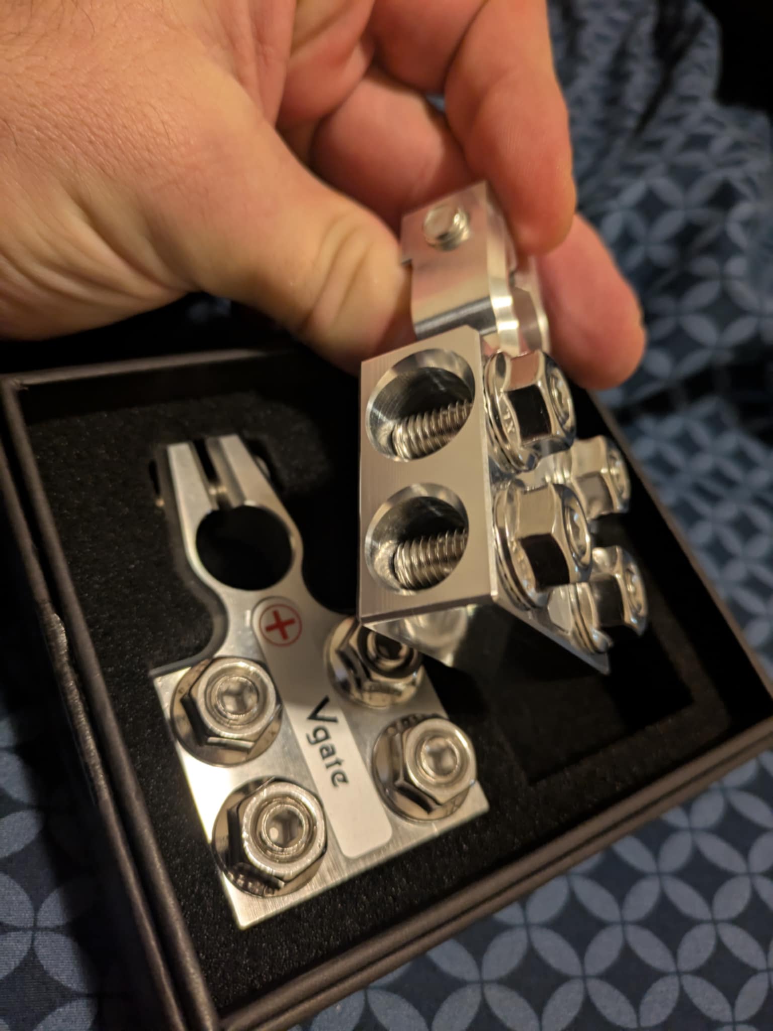

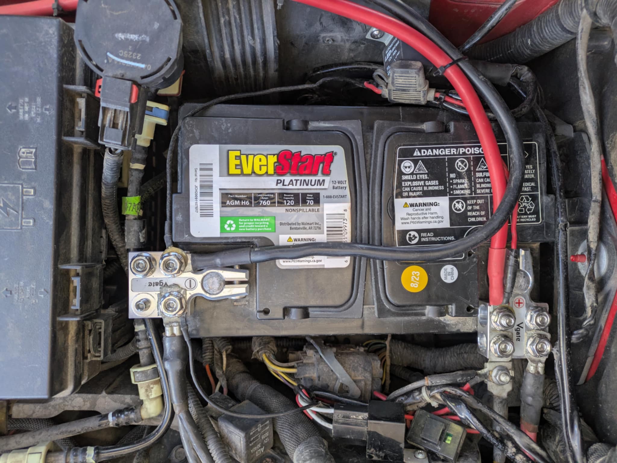

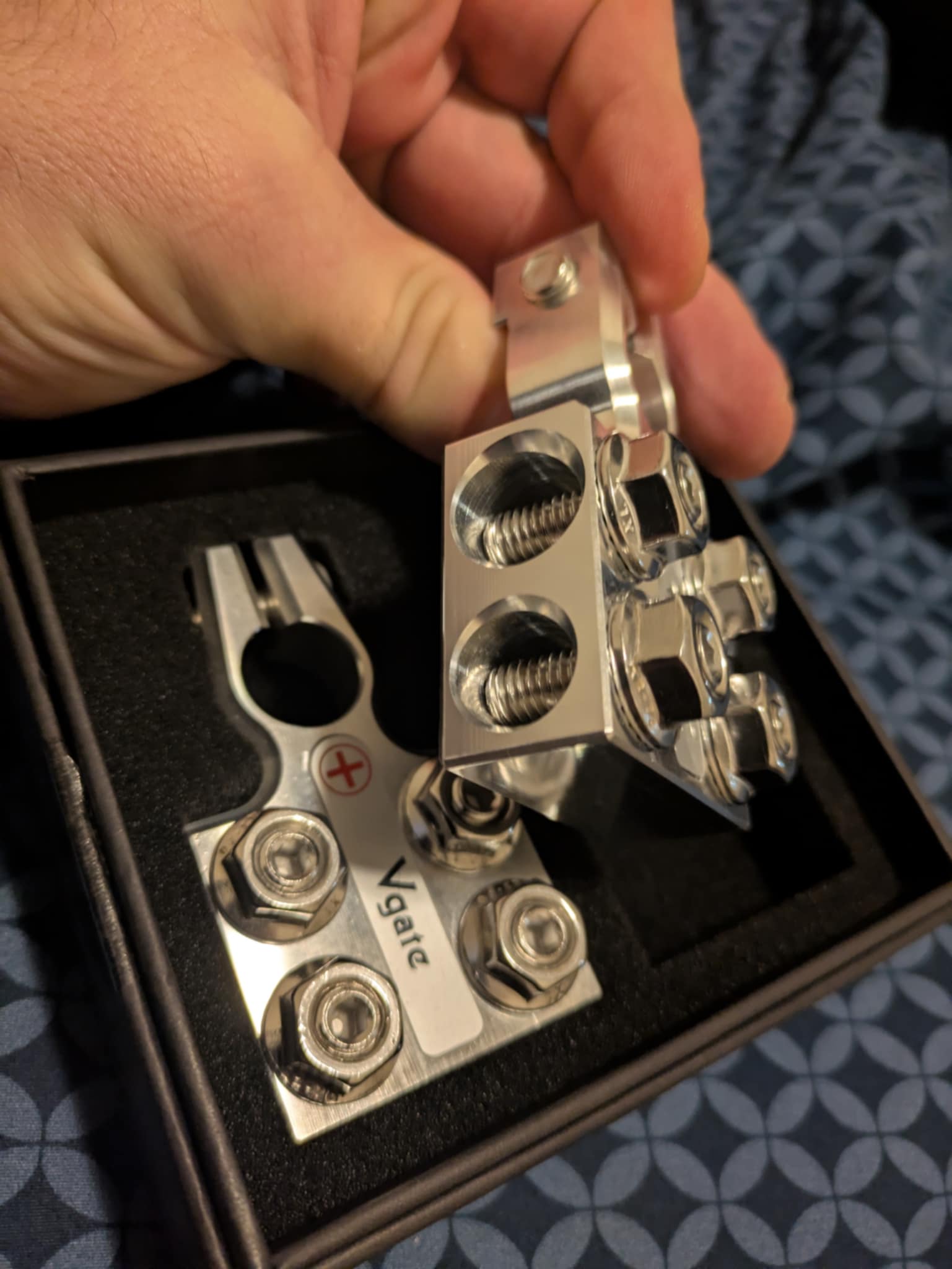

Where did you get the terminals??
I got them on amazon. Overall I like them but wish the allen key on the negative side was oriented correctly to tighten it without cutting down an allen key or turning the terminal to one side.
You also have to modify or replace the existing wire connector to fit the new terminals which took me about 10 minutes.

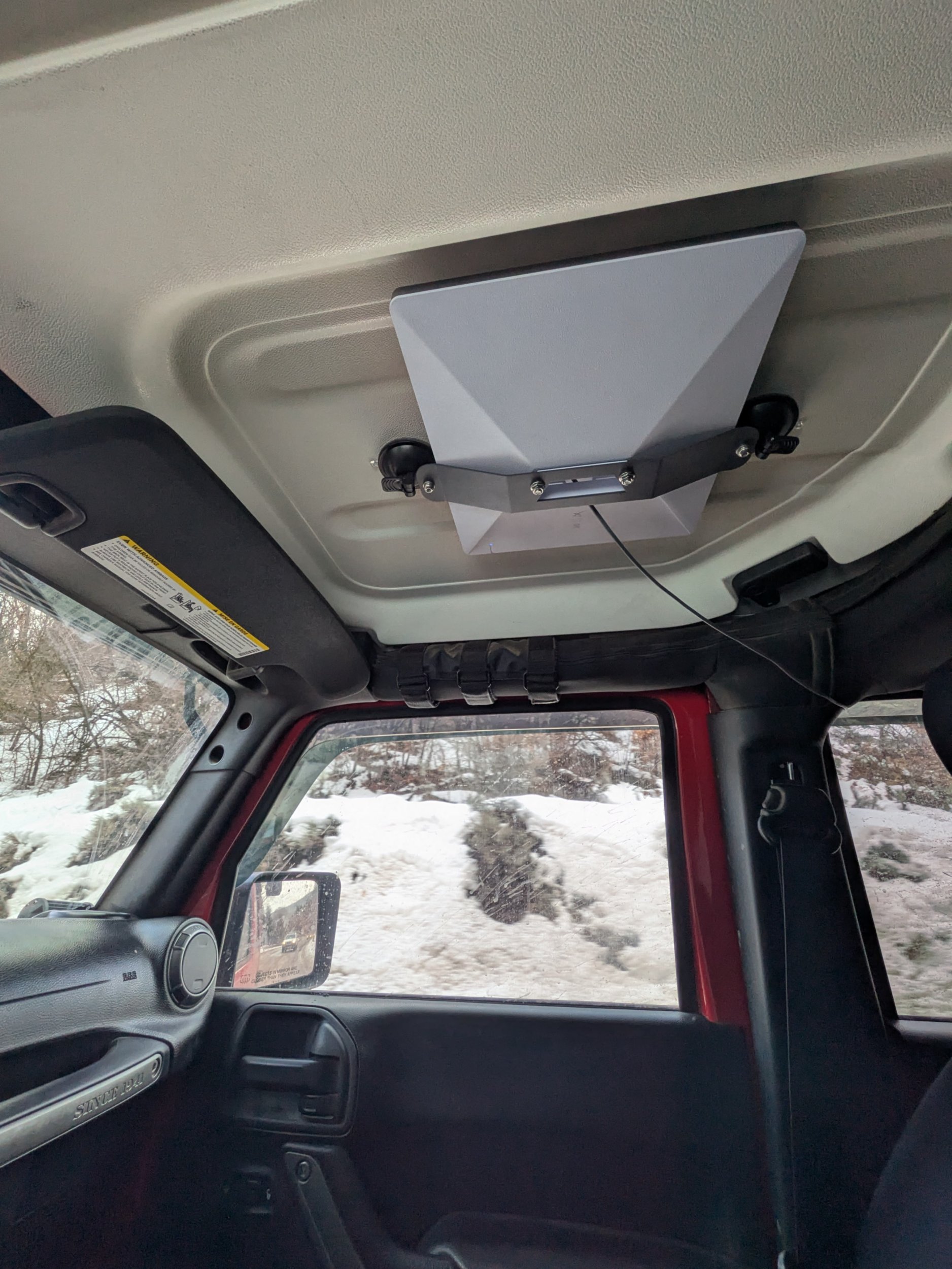

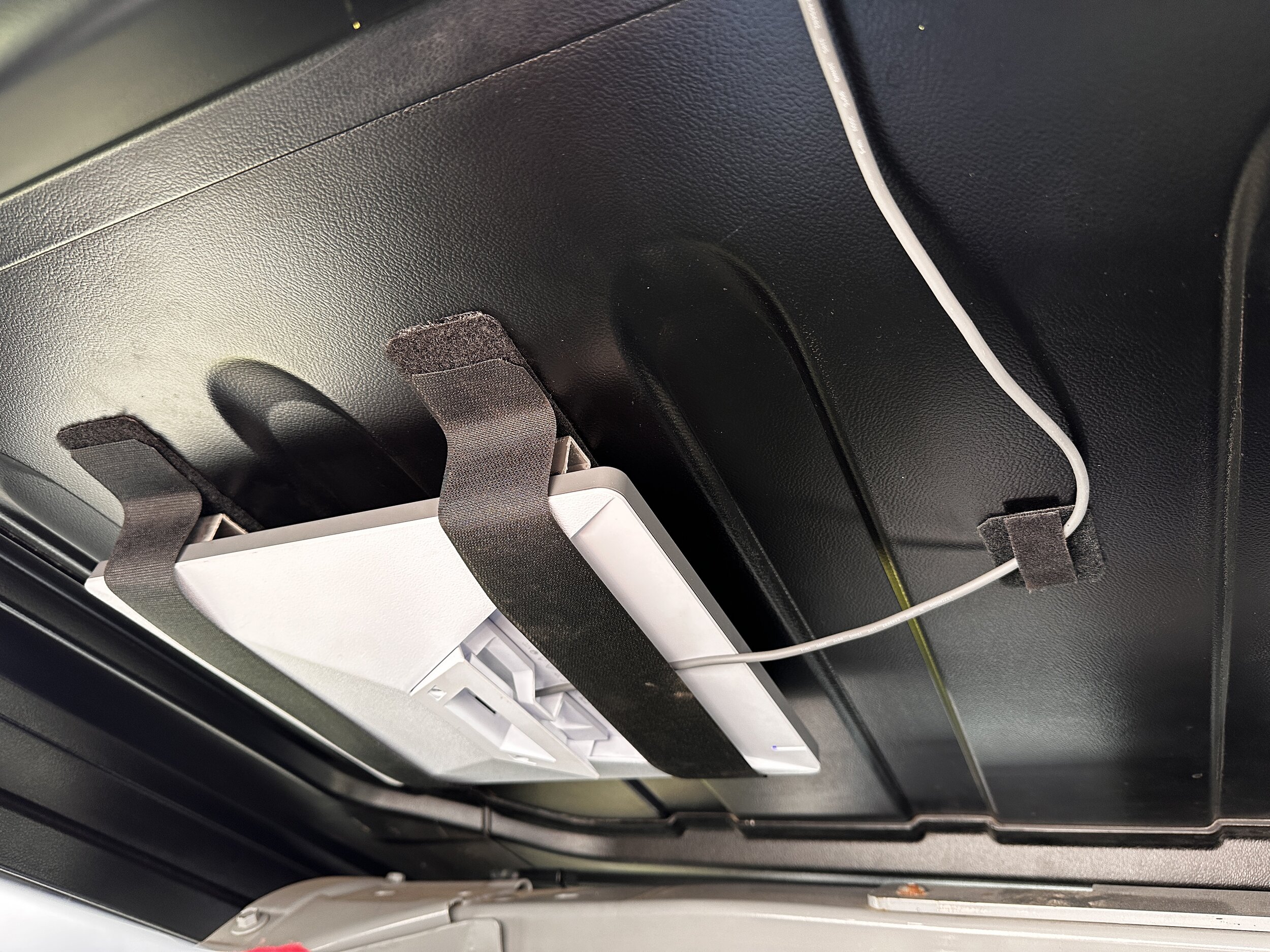

Got my starlink mounted up and tested over the past couple weeks. I redid the wiring but wanted to make sure it worked through the freedom panels before mounting it permanently.
Im averageing about 135 mbps up here in the mountains which I cant complain about at all. So nice to be able to connect no matter where I go.
Reactions: WSS and JeepJeezy
Nice! Yes the starlink works with no obstruction through the freedom panels and the hardtop. 135 is spectacular. It tracks good too. We did 70-75 mph in remote so call and got 85mbps. When sitting still, we got 100mbps.
Originally, I had it velcroed flat against the top, my top is black and gets a little hot, I bought some Delron square tubes and put them in between the top and starlink for a little air gap. Works fine and I think it breathes a little better

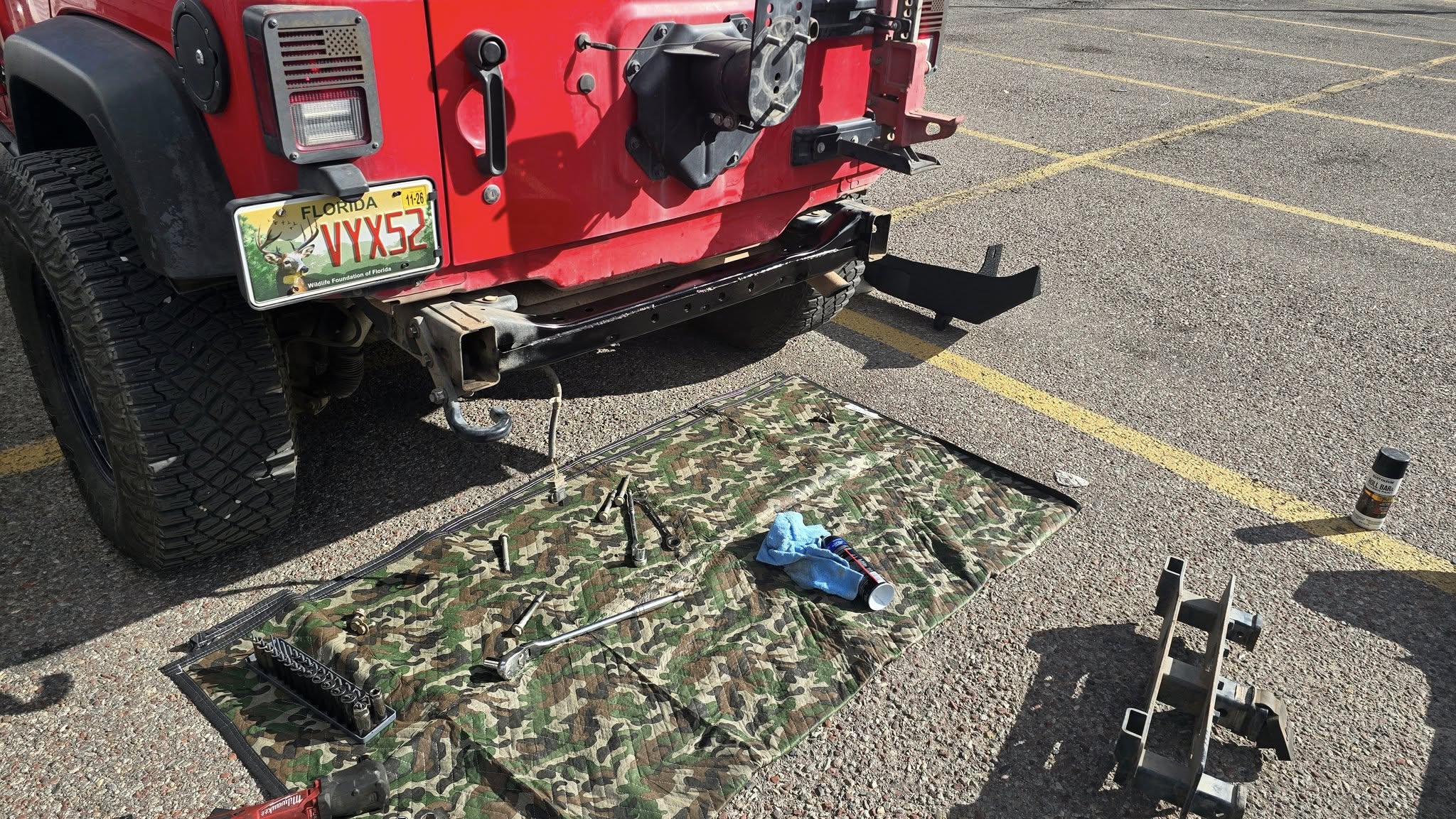

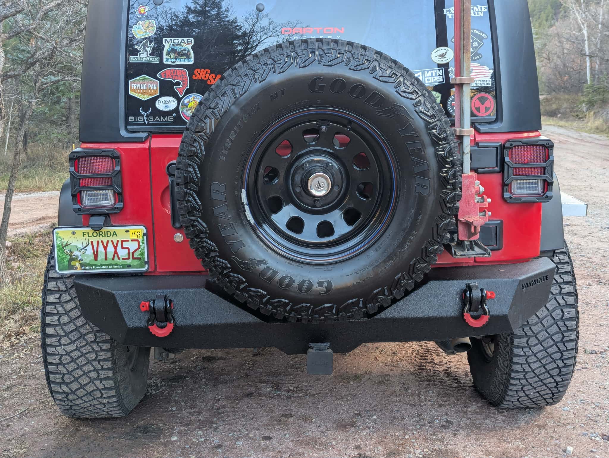

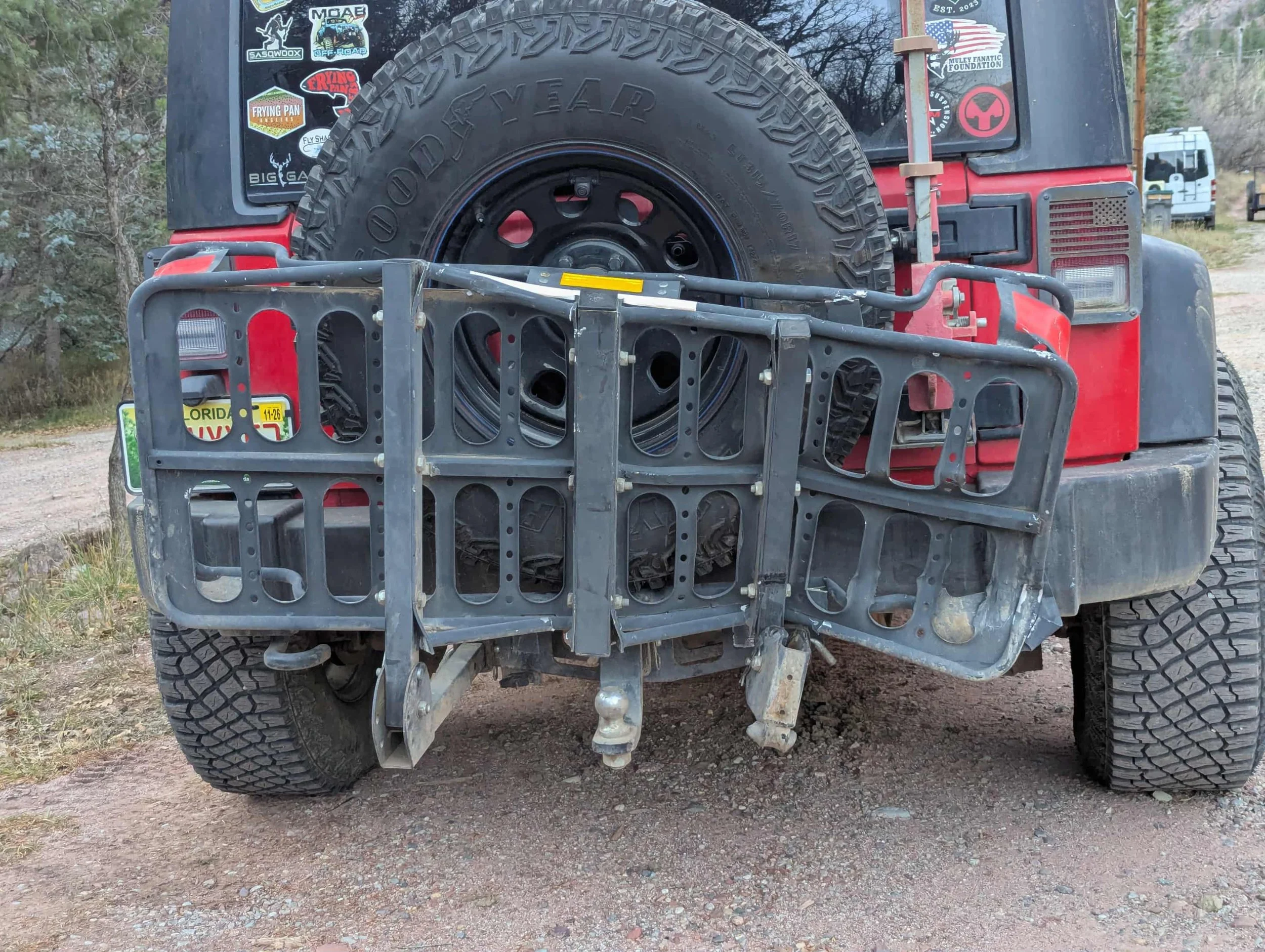

The jeep had a minor rear end accident this fall. Luckily I had my quadratec bumper carrier on and it took most of the force. Very slight dent on the plastic bumper and crash bar but otherwise the jeep was unscathed.
I ended up getting a decent insurance payout and was able to get an aftermarket bumper for cheaper than the OEM plastic thing.
Looks better and has more clearence in the rear.

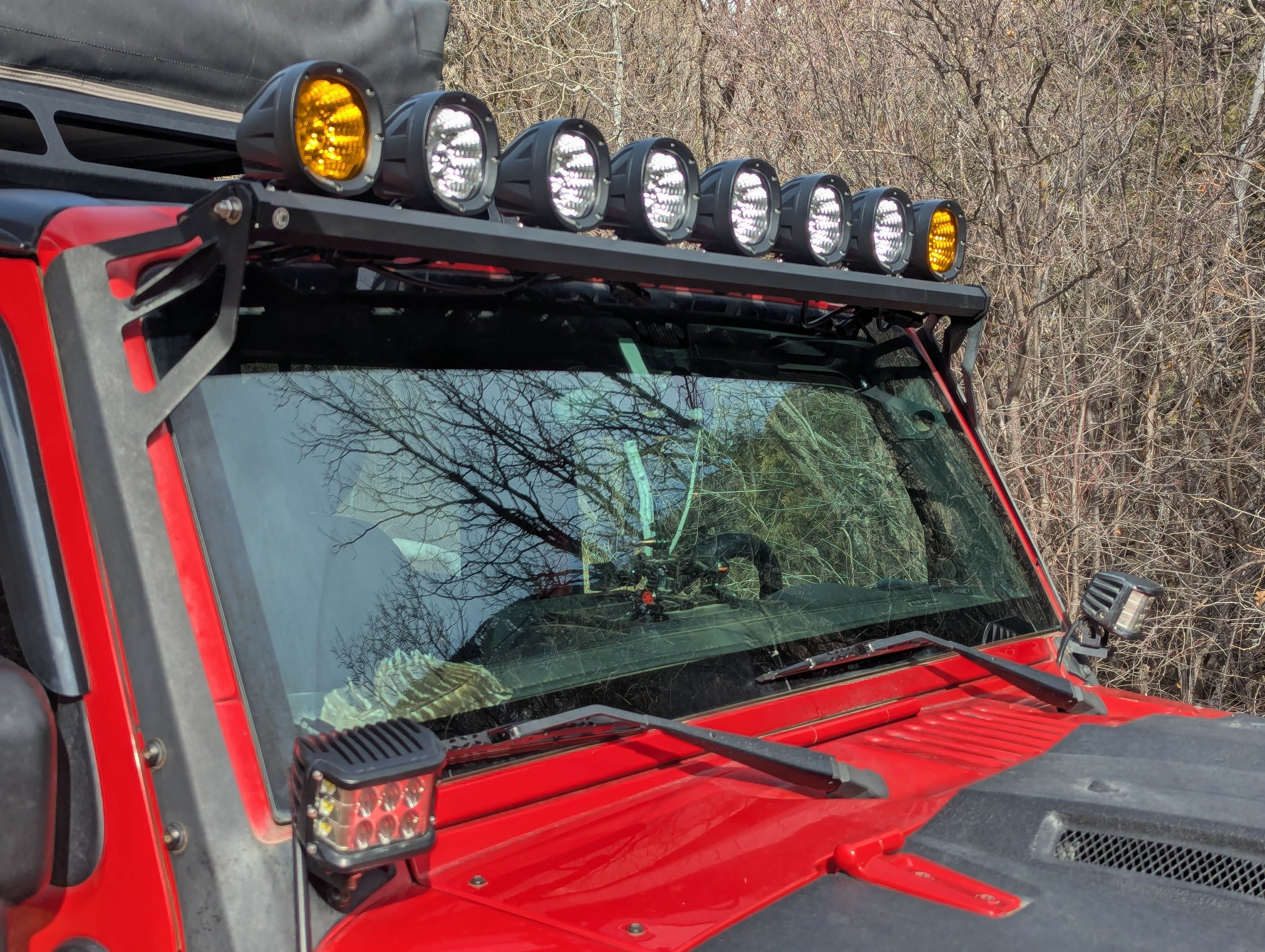

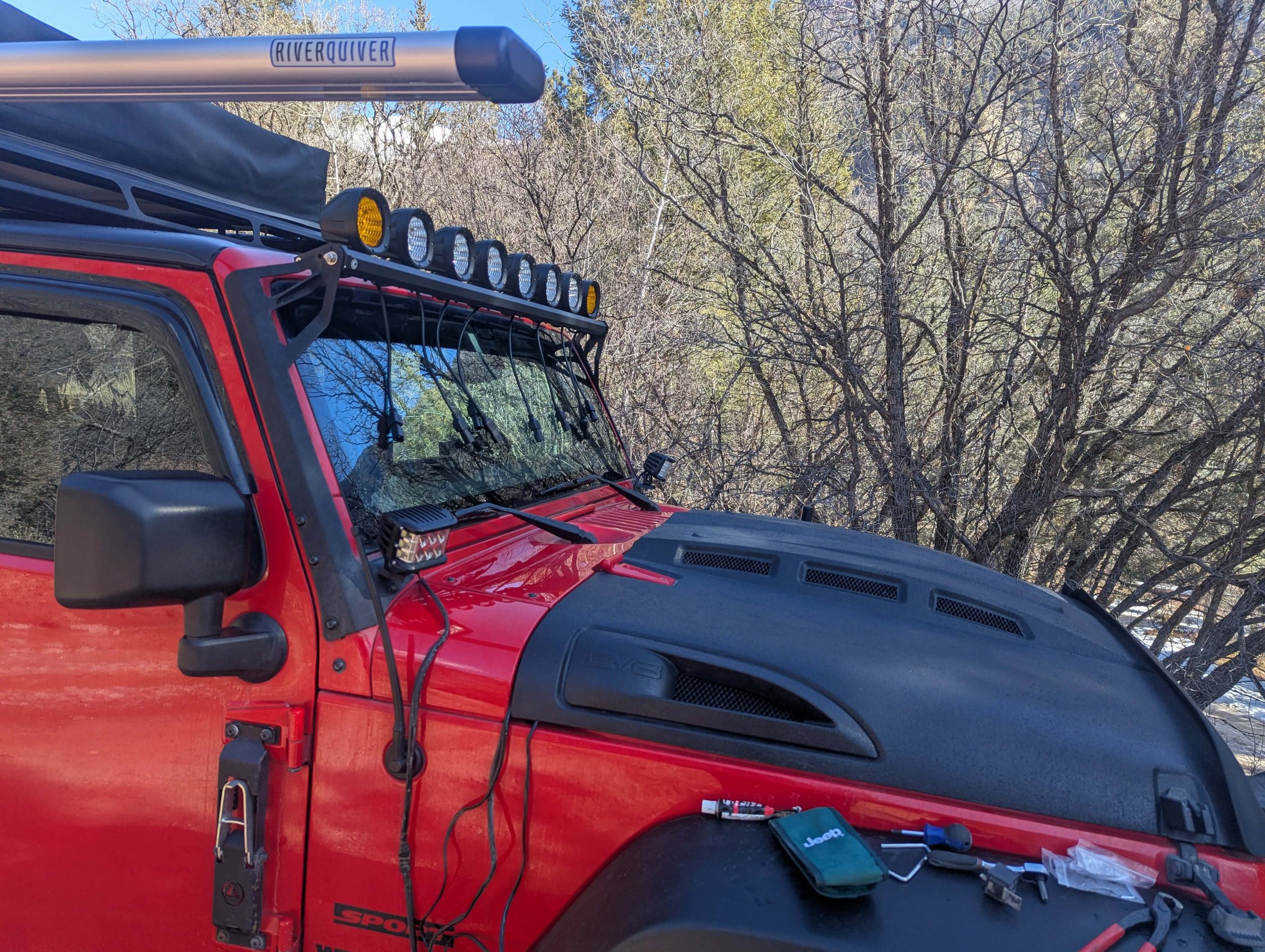

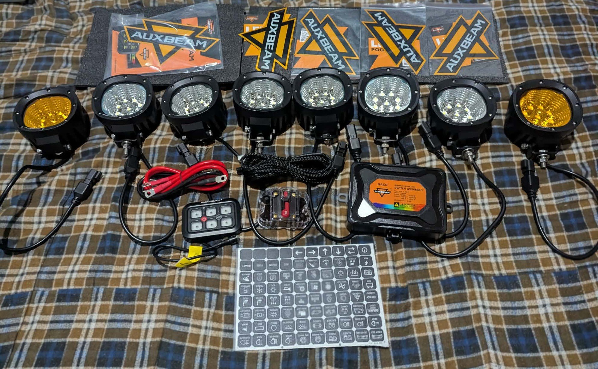

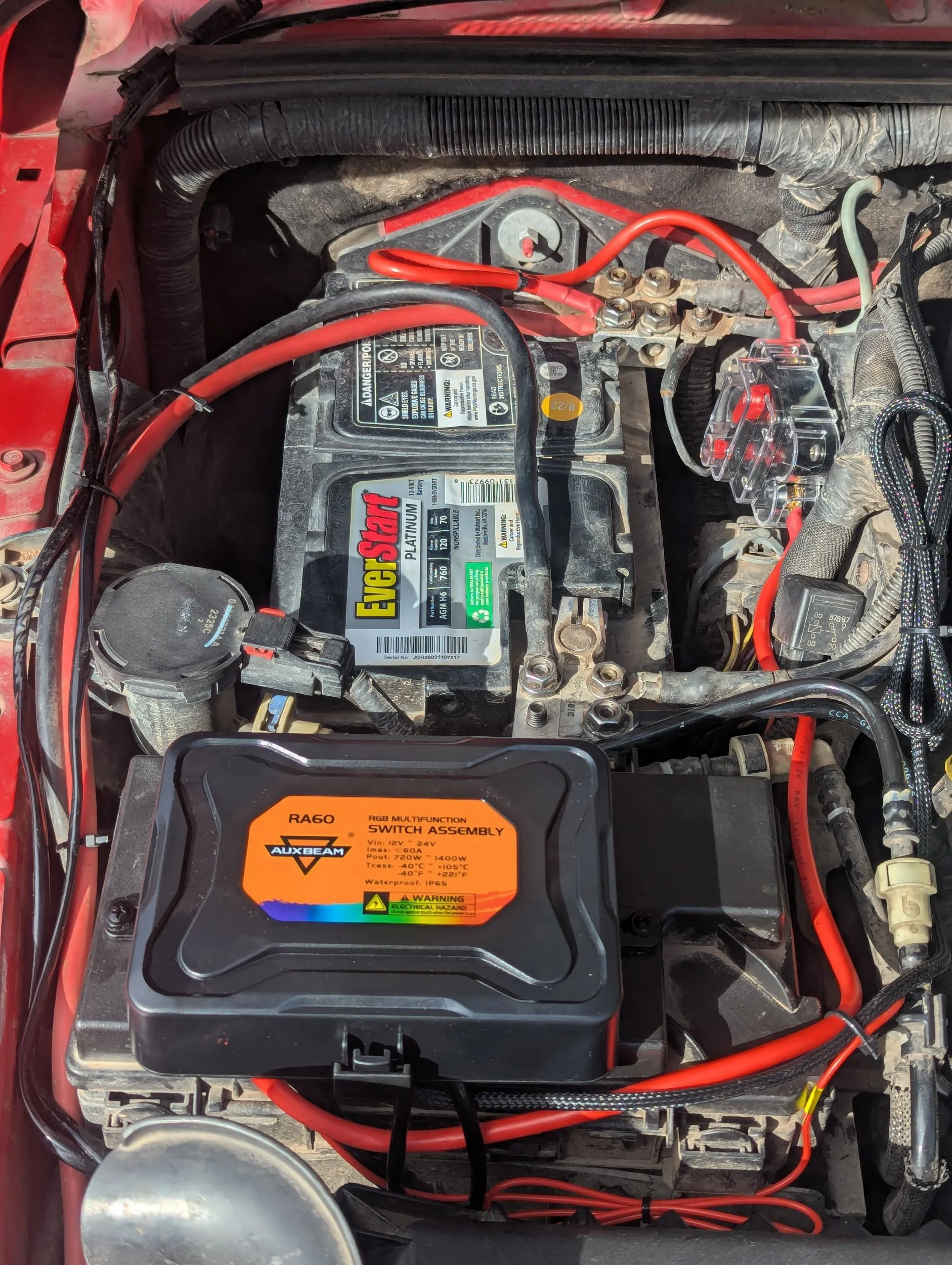

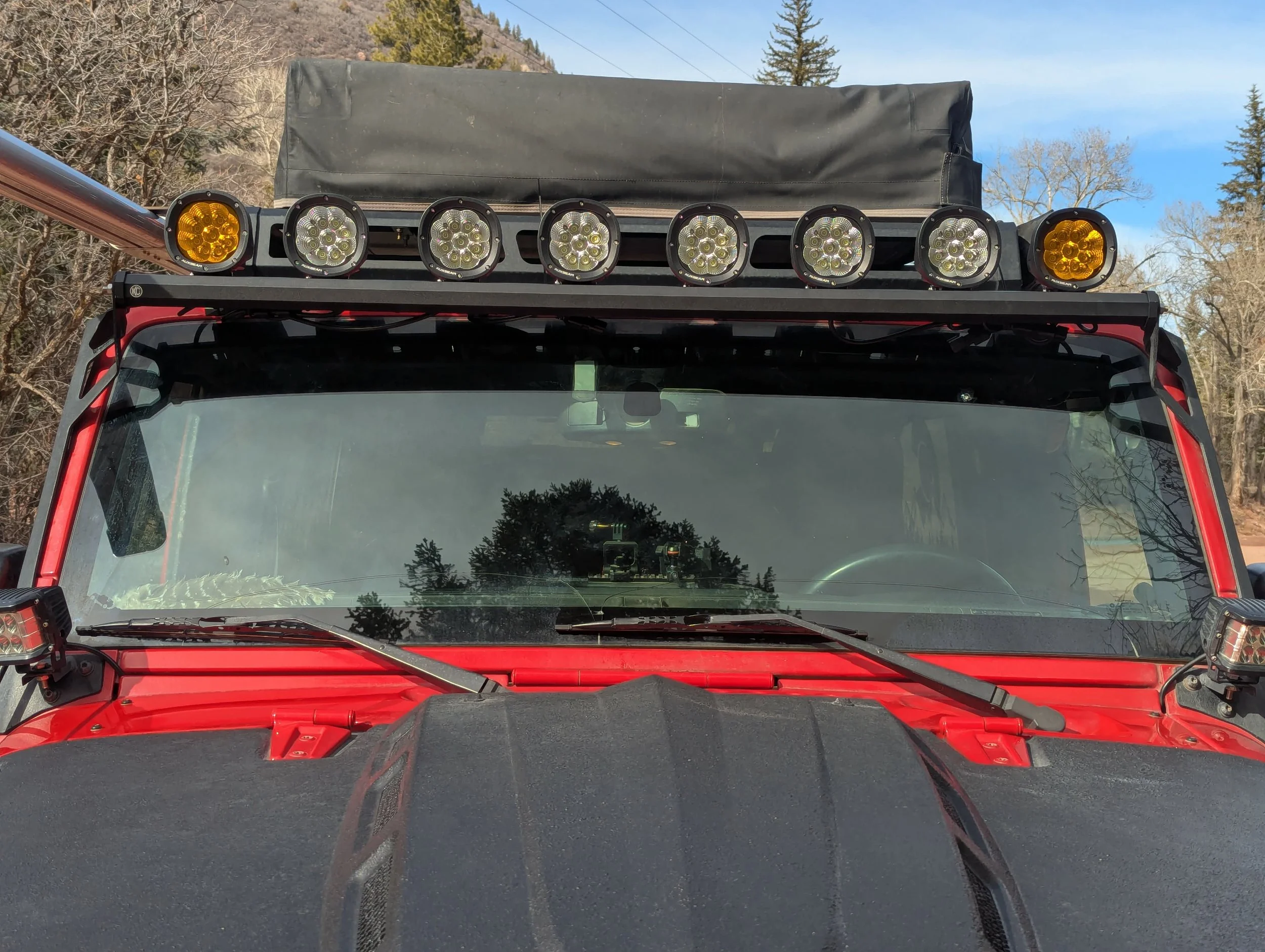

My cheap old amazon lightbar has been losing LED's since I got it. I think there were 3 out of the 120 still working so it was time for an upgrade.
I ordered 8 x Auxbeam P4 4 inch Flood beam pods and a KC Hiltes 50" universal flat bar mount as well as a new Auxbeam Ra60 lighting controller to upgrade everything.

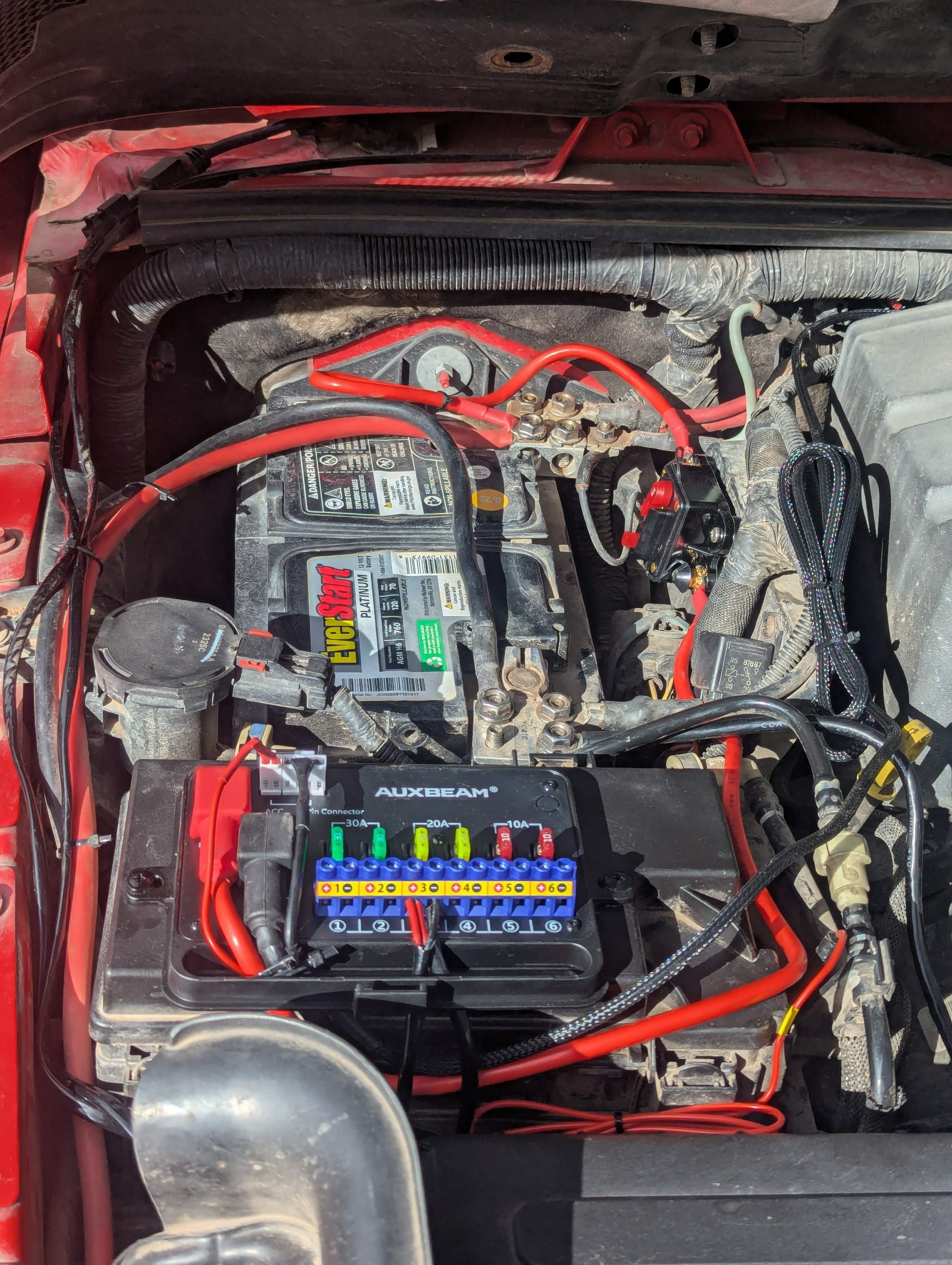

Im not the best with electronics but was pretty straight forward. Could use some more cable managment but ran out of zip ties otherwise looks good and works even better.
Looks good! Now we need to see some night time pictures of them in use. I'm ready to replace my cheap light bar and thought of going the route you went.
