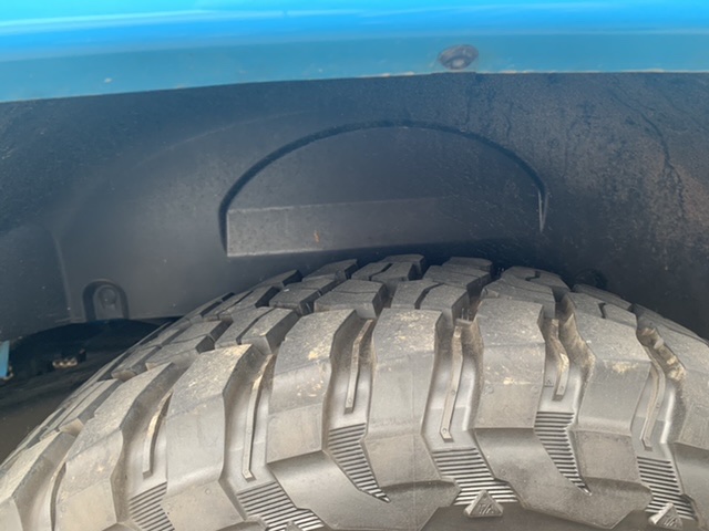

What does the side of the tire state for max psi? Can you take a picture of the tire tread for us to see?

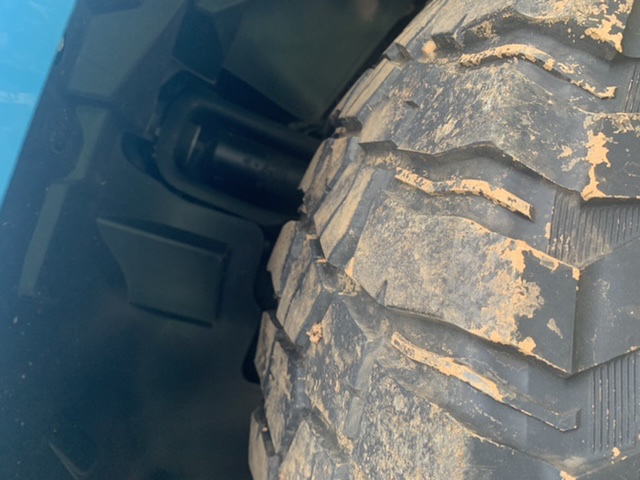

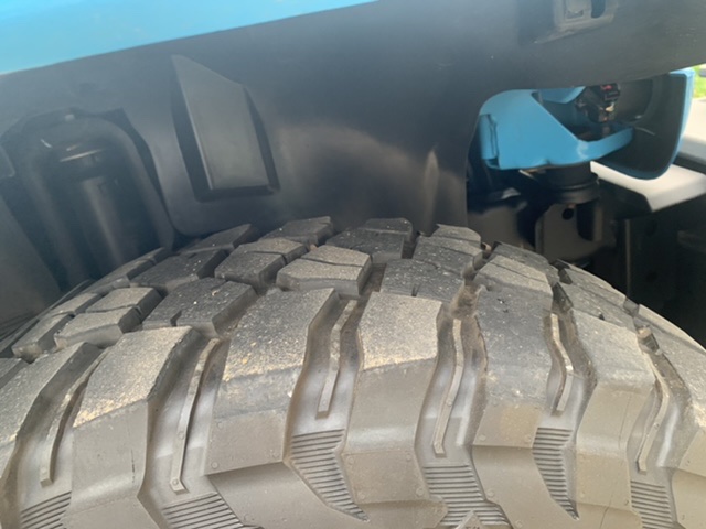

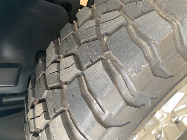

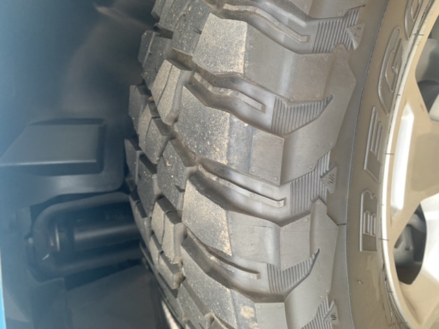

Those definitely look like they're cupping. That's where you're getting the "rough" feeling. Maybe take it to get aligned
