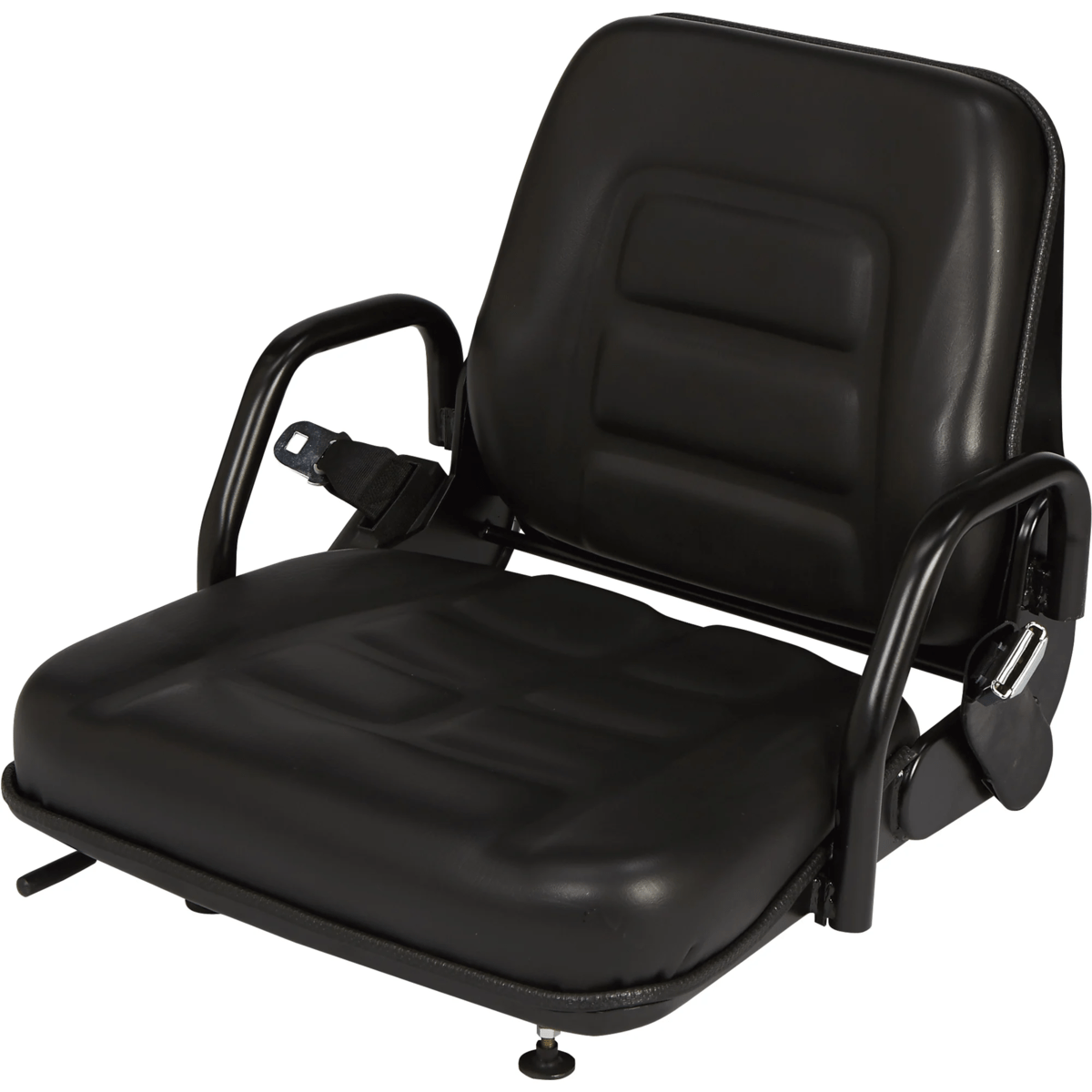

Throw away what you have and get a pair of these. They're really all that you need. They're made for a forklift, so you know they're durable.
