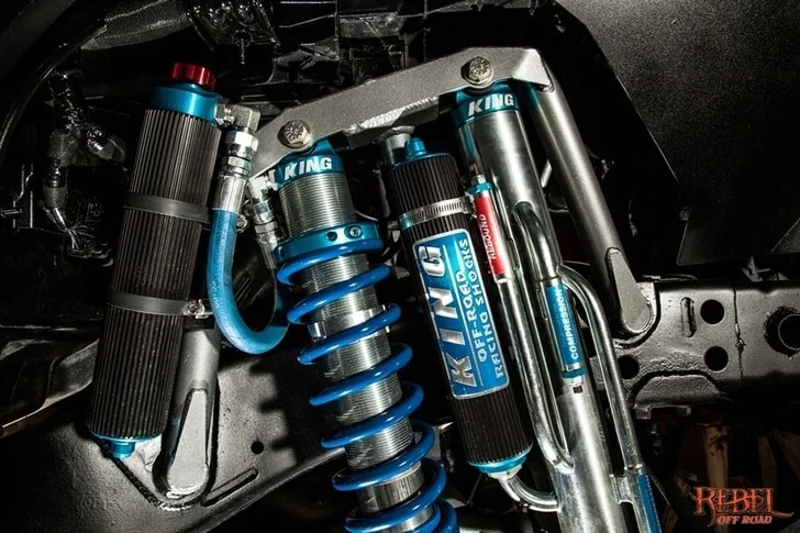

My first though was to beef up the suspension. While in my days with the SCCA, I learn from many of the drivers about what suspensions they used to beef up their touring cars. I wasn't into off roading, but many of the conversation led to this type of off roading and some of the touring cars were actually used for rally racing. I guess I would have to start with upgrading the bushings and control arms, then move onto the shocks or even a dual shock set up. Like the one seen via rebel offroad.

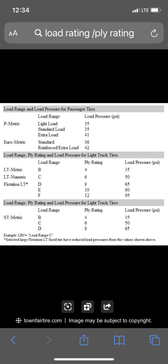

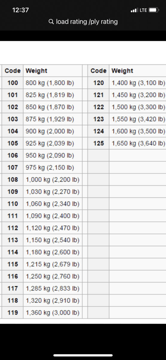

I'm finding it very difficult to source or even compare 35x12.5R18 with a C rating. You happen to know the difference between a letter "load rating" versus a numeric "load index?"
I have looked at several tires that show me, for example, a 118 or 123 load index but I don't know how or if that equates to a C or D load rating?

I have P285/70R17 116T. These are rated at 2750 lbs at 44 psi. Basically a C rated tire. I come up with this comparison by the tire max air pressure. Max pressure of a C rated tire is 50 psi.
You will have to try to stay with a P metric or a 6 ply LT tire to stay in the C load range. Read tire sidewalls and talk to a trusted tire guy/gal. Most LT tires are designed for full size pick up trucks. The kind we used to see on Sunday afternoon coming home from the cabin loaded with firewood.
One more piece of info. For an aggressive tread for a Jeep you will be looking at an ET(extra load) tire in P metric. 41 to 44 psi max rated. Of course you can air them down to 28psi for a good tread contact pattern and better ride.

Oh yeah, in an 18" tire you'll never find a C rated. With 17" you would.
The higher the load index is, the stiffer it will ride, so while I don't believe is a 118 is a C, it's going to ride better than the 123 for sure. Well, at least on a lighter vehicle like our Jeeps.

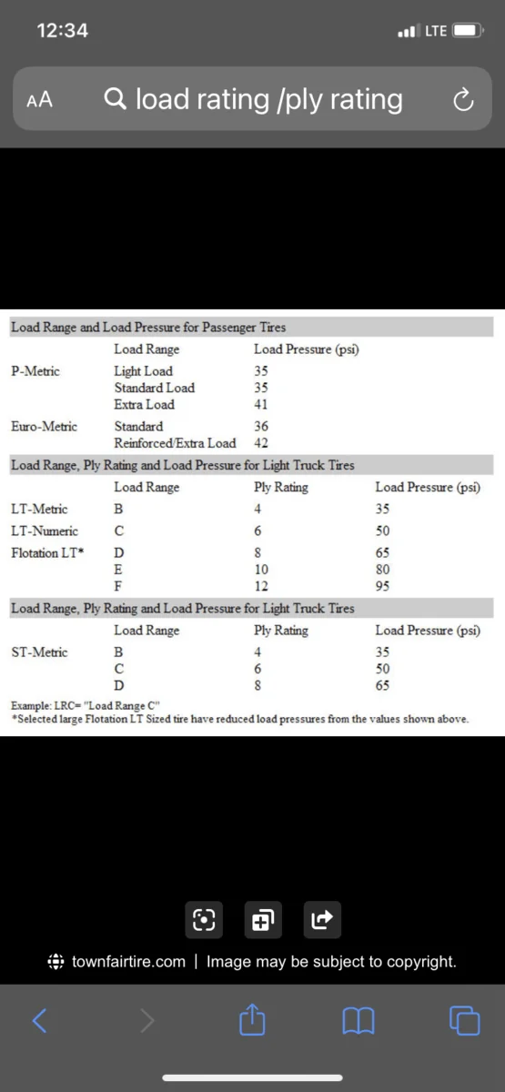

What tire are you looking at? I may be able to help you figure out what you’re looking at.
305/70R18 is pretty close to a 35X12.50R18. With that sizing you may find a C or D tire. Tho you may have to settle for a D rated.
