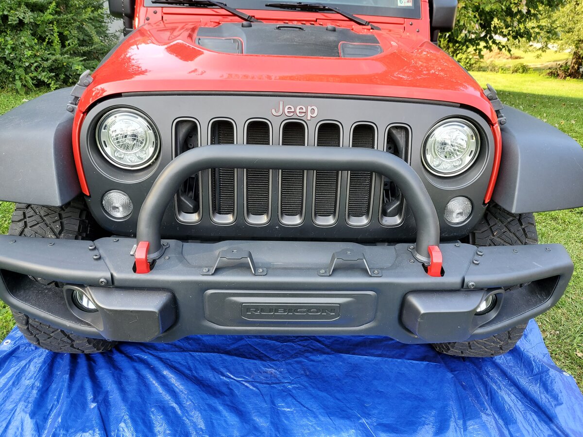

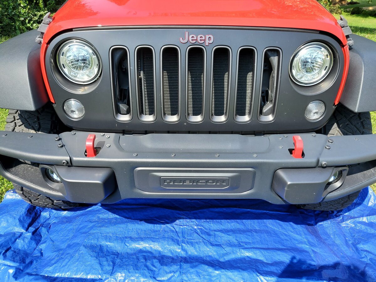

I installed a Maximus-3 Classic Hoop today and have mixed emotions about it. The hoop itself is solid and looks great but it almost completely blocks the tow hooks. The reviews I read said this was NOT the case and they could fit a strap between the hoop and the tow hook but I'm finding that not to be the case. I can get a D-Ring to fit in the passengers side hook and use that if needed but, because the hook is canted slightly, the drive's side won't fit. I can get the thinnest part of my 18,000 lb strap to fit in the hook and loop it around through the end and use it that way, too. I guess I'm just disappointed that this is an issue, it's easily fixable if the hoop were just tapered in at the base a bit to allow room. Here is a link to the review I read and before and after pics.
