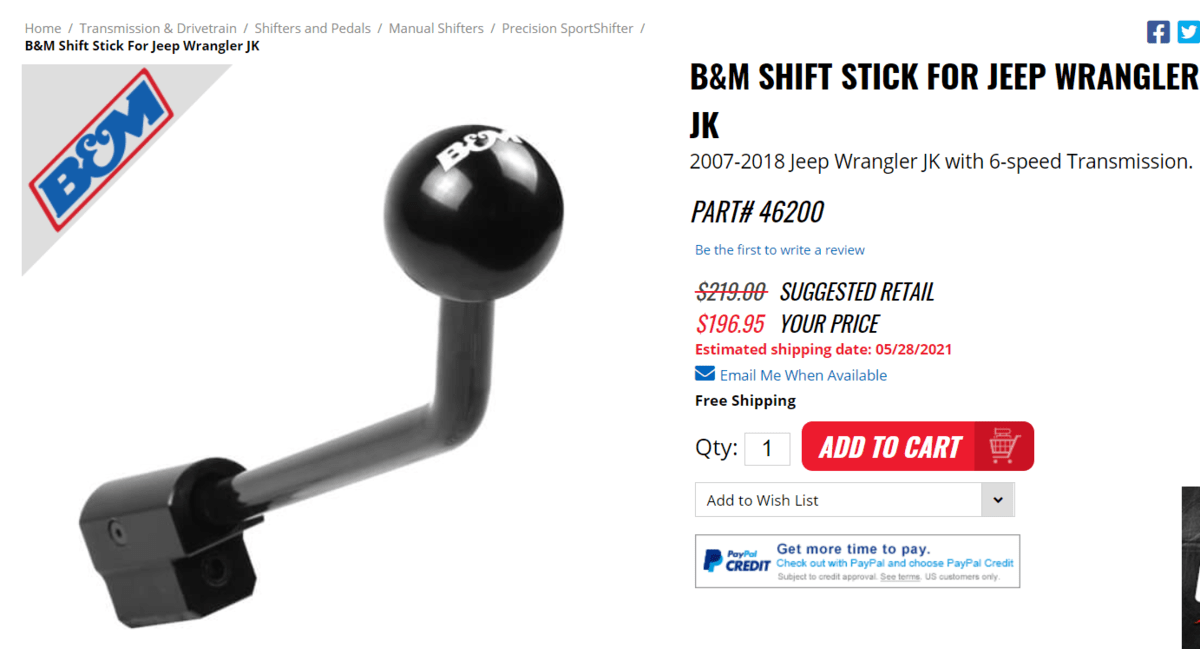

My '07 6 speed used to bounce all around like that. Then I installed a B&M Shifter, part# 46200 . Seriously, get one of these. I'm a little pissed that I had my jeep for about 7 or 8 years before I installed one of these. It shortens the shifter a little, puts a nice bend in it and, most importantly, eliminates a stupid little rubber bushing that is between the shifter that you see and the stub coming out of the top cover of your tranny that it attaches to. Should be OEM.
