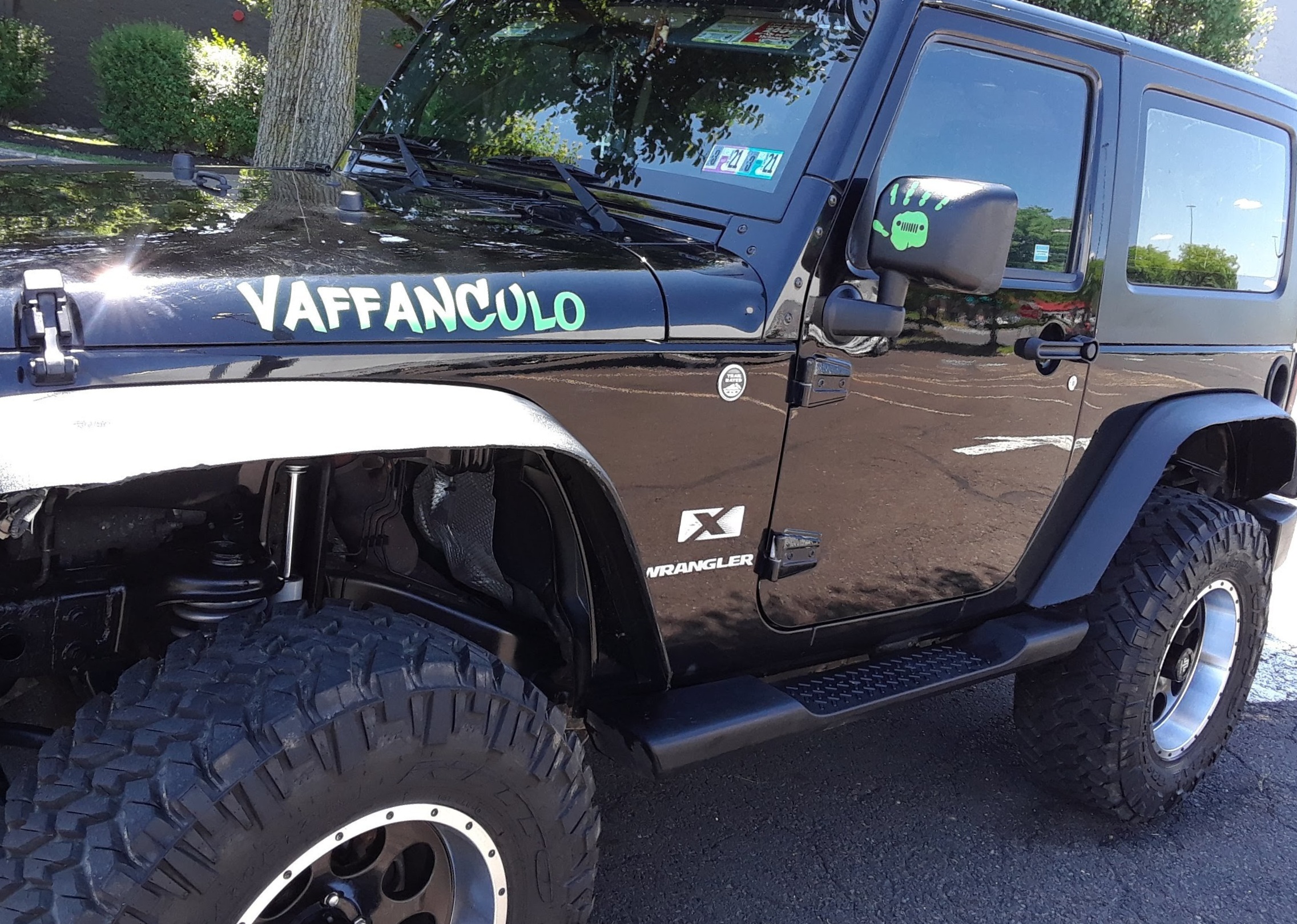

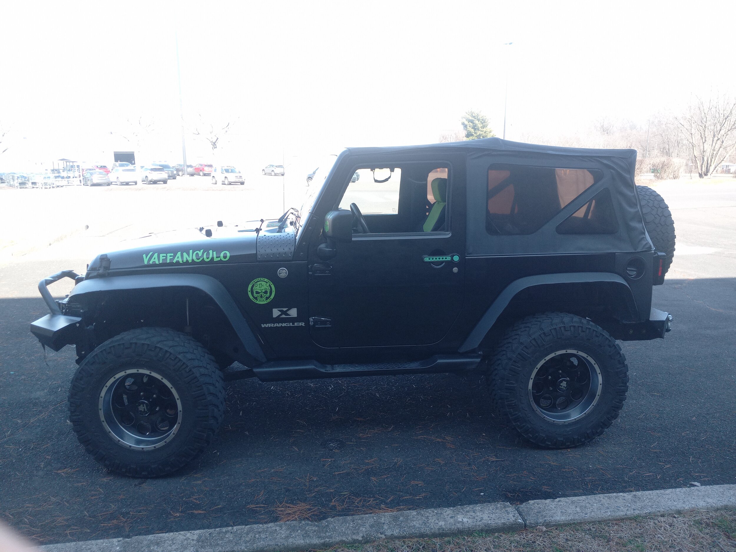

My experience is limited to my 2016 JKU with 3.5" lift and 35s. I swapped flares and liners out for the pictured ones. In my defense, I did wrench for a living and didn't have one hole to drill. I did install rivnuts in all the holes to really simplify the install. No trying to get a wrench on a blind nut makes it very easy to pull them when needed. They DO NOT rub at full flex.

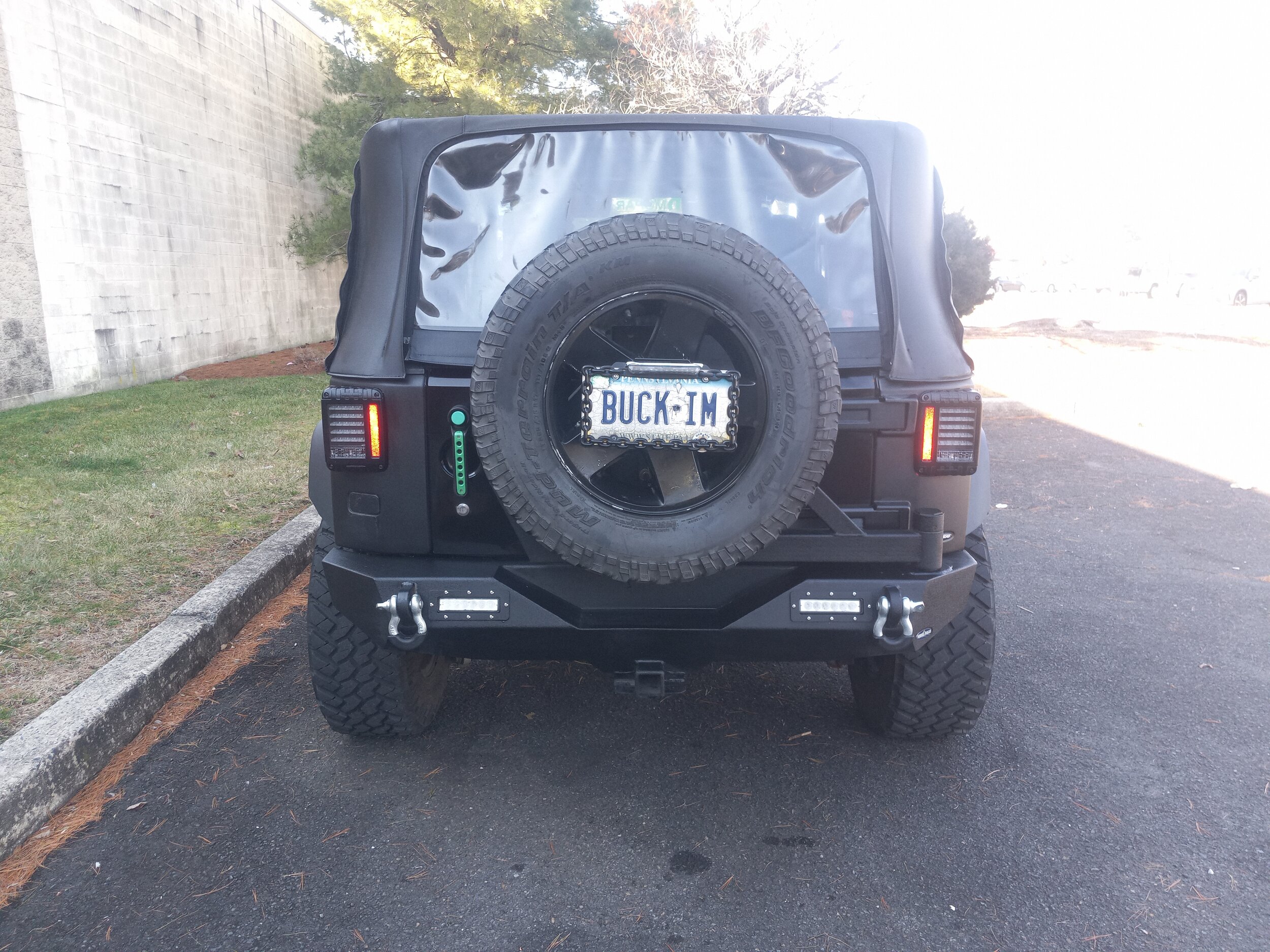

Wasn't sure I'd like the flare's running lights, but they are a godsend in the pitch dark. They are wired direct to the front and rear running light harness.
Flares and liners are an Amazon buy.
https://www.amazon.com/dp/B08QVCQBC6?tag=jkforum-20 are the liners
https://www.amazon.com/dp/B07RTN38SF?tag=jkforum-20 are the flares

Here's some better pictures plus the wire that you will unplug from the side mount lights are a quick connection if you ever want to connect rock crawler lights
