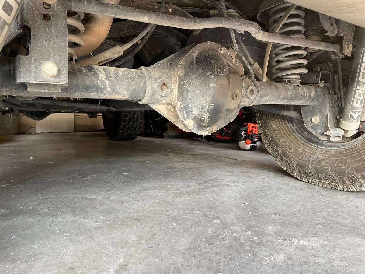

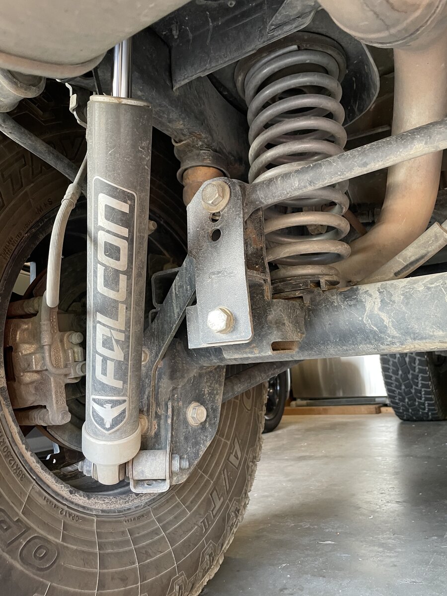

I checked with Rough Country - top hole is for 6" lift (middle is 4"), I measured spring height just to confirm its a 4" lift, NO idea why it was moved.
Again, maybe the PO was just chasing solutions as he was not happy with the handling of the vehicle.
