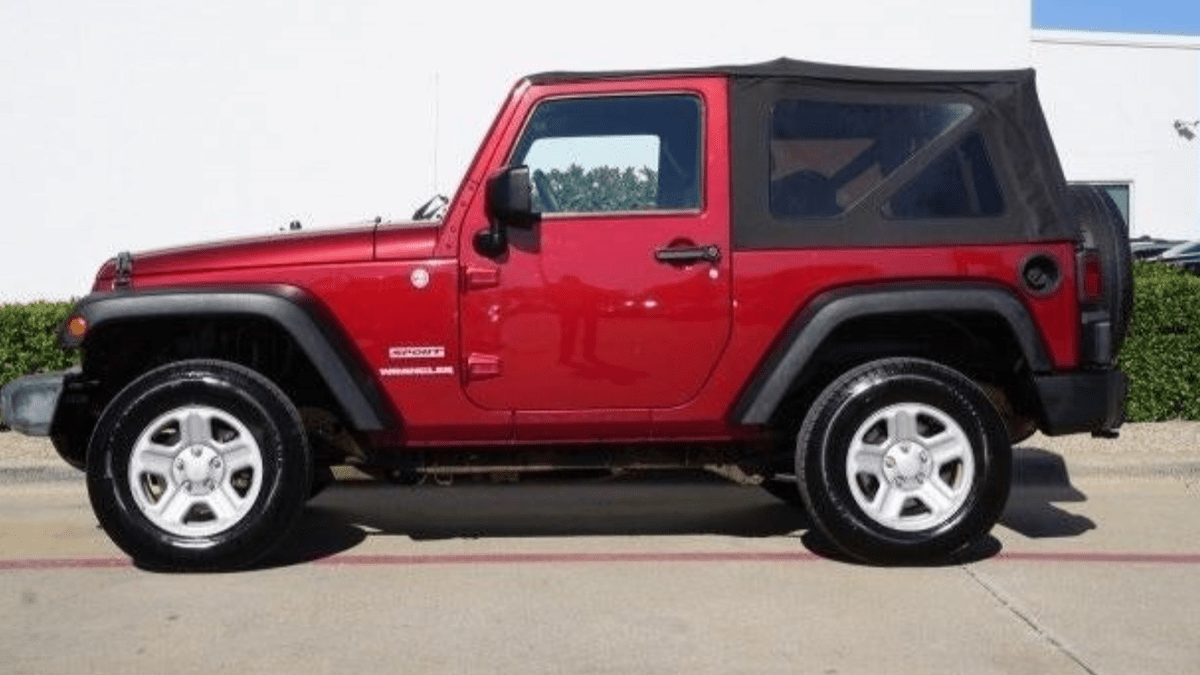

Recently bought a stock 2011 JK. My 16 yo daughter will be the primary driver, so I’m not planning on doing any major mods. I would like it to sit just a bit higher and level (w/out the front rake). I’ve looked around and there are a variety coil spring spacer kits. I‘m think of either a front end only level kit or a combo, but have several questions.
If we keep the stock bumper and do front end only, is the 3/4” kit sufficient to produce a level stance or should I go with a 1”? I know we’re only talking about a 1/4” difference, but I’d refer to not end up with it looking like the front is higher than the rear.
Same basic question with the combo kits. They have 2” front / 1” rear or 1 1/2” front / 3/4” rear.
It’s my understanding these minimal kits don’t require new shocks or other changes to maintain suspension geometry; your thoughts?
Finally, what material do you recommend, poly/rubber or metal/aluminum. I’ve heard the metal spacers, while more durable, create a rough ride and can have squeaking issues.
Oh, and one other thing, I’ve read about lifted Jeeps experiencing a “death wobble” when hitting a big bump at highway speed. Again, my daughter will be the main driver, so I don’t want to do anything, if it’s going to introduce that possibility.
Thanks for any help you can provide. BD
