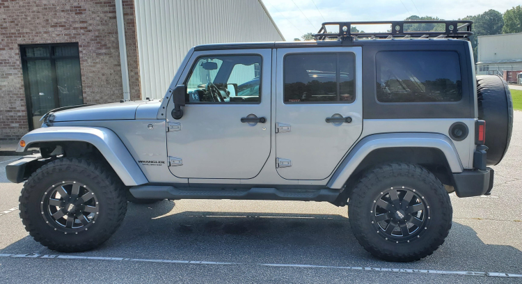

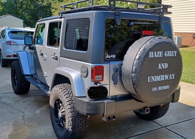

Say hello to the SmittyBilt Defender rack, Model 45555. It has a 500lb weight capacity and it has served me extremely well for almost 6 years now.
The mounting kit for the JKU includes gutter mount over the rear windows and hinge mounts which require the rear window hinges be loosened, not removed. I am 6'6" and weigh close to 300lbs. When I load the rack, I open the rear tailgate and pull myself up on the rear bumper holding onto the rack. I access the sides by climbing on the step and onto my back wheel, again pulling myself up by the rack.
I occasionally check the mounting brackets to see if they've loosened, which has occurred once after a trail run. I have a Reese rooftop cargo bag which fits perfectly and I use the adjustable rubber straps equipped with the S-hook for securing the bag or other stuff.
I've had upwards of 200lbs on mine, not to mention me putting my 300 lbs of pull on it when I climb up to use it.
Rack was around $400, mounting brackets kit another $100. Took me about 2 hours to install alone. Much easier of you have an extra set of hands to manage it from either side of your JKU when mounting.

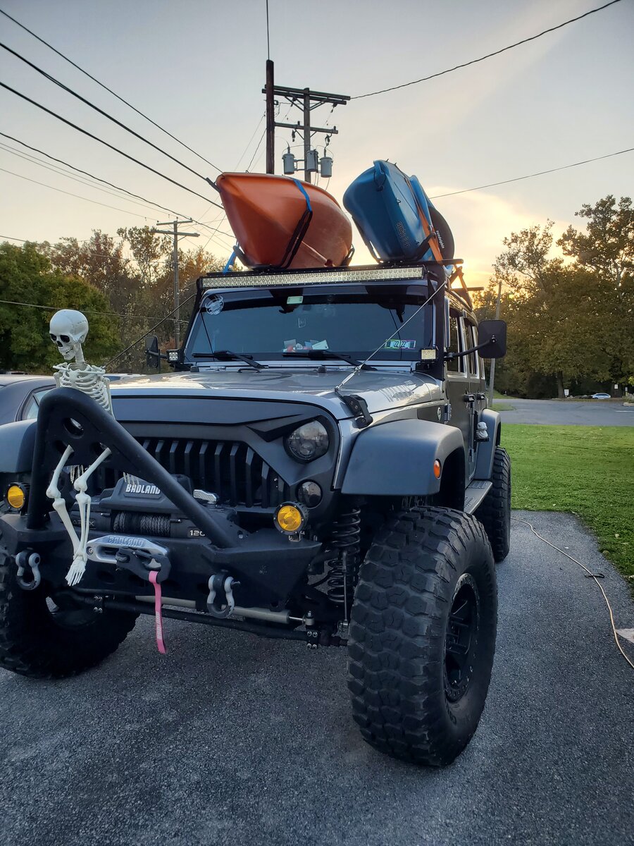

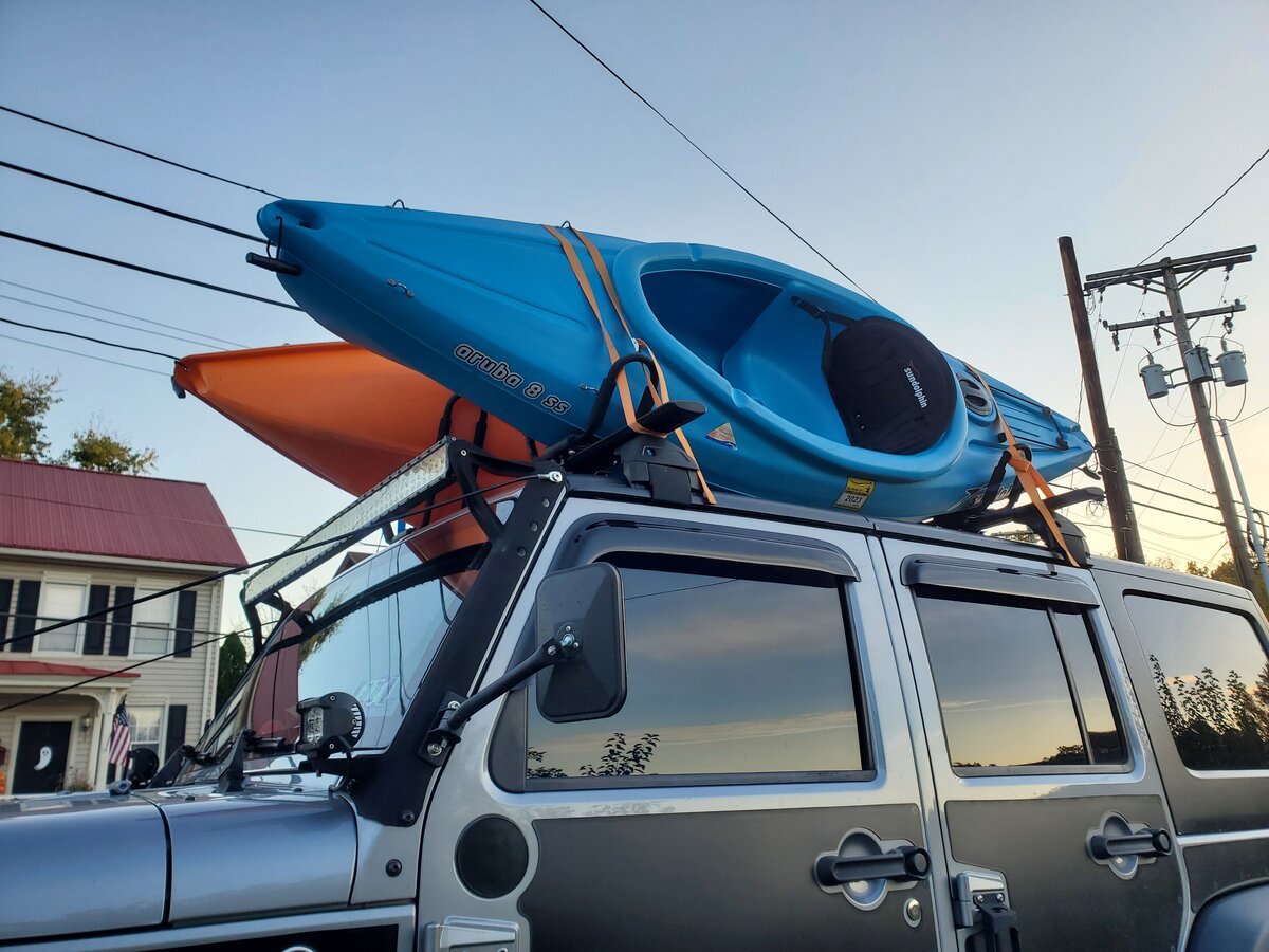

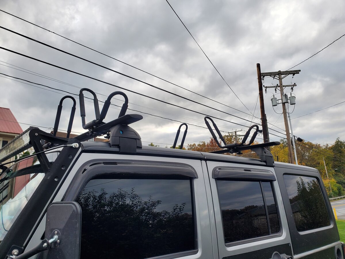

Here's my setup. Zero issues! I've had 3 kayaks up top doing 65. 2 in the J hooks and 1 in between. I'm supposed to be going on a kayak camping trip this weekend. I can try to take some pictures with kayaks up top if ya want.
That’s exactly the setup I’m talking about. Looks like yours connects to the gutters too. Have the cross bars ever shifted after a trip? Do you have to frequently retighten them?
They've never shifted and I've never had to retighten them either. With a 6" lift and 37's, I've literally thrown the kayaks up top dozens of times.

I honestly don't remember. I got them on eBay. I tried to look them up but it's been well over a year and eBay won't let me view the listing anymore. I know I paid $156. That's all I can see.
Ok . Well you took a good pic of the mounts so will check eBay and see if I can find .

We're only going for 2 days this time, so I loaded up the 8 footers. I use the 10 ft kayaks for longer trips. Plus, the 8 ft kayaks are easier to throw up top too! From the ground to the top of these kayaks measures just over 9ft tall.
