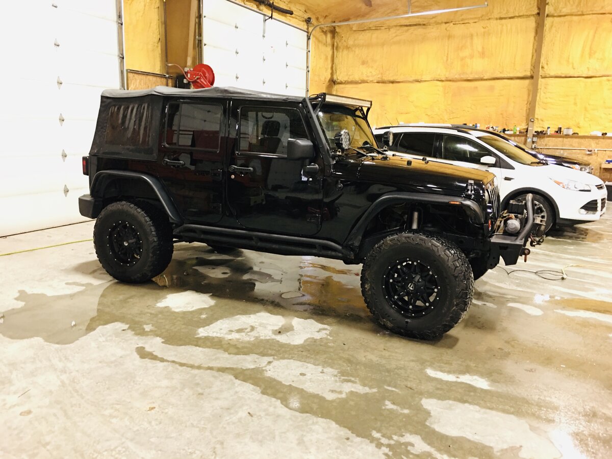

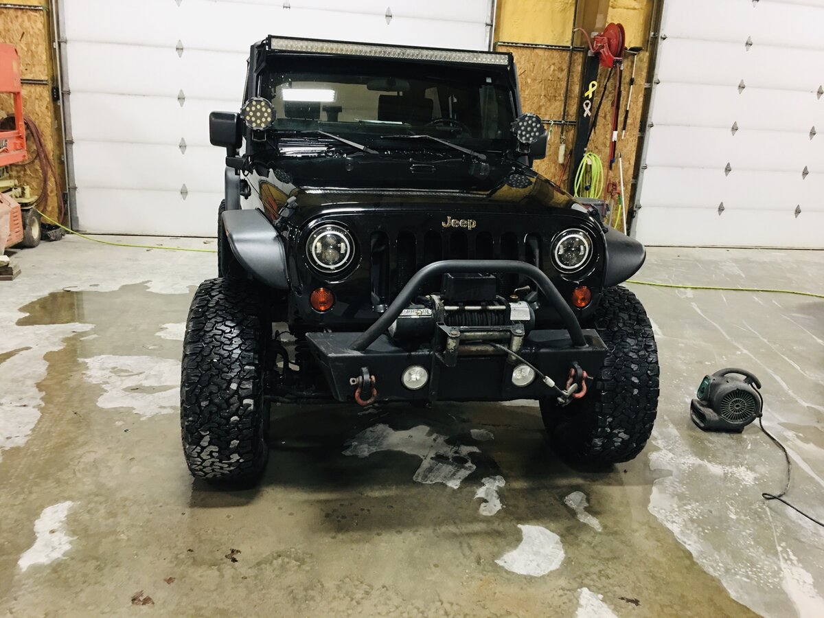

Just bought 2010 wrangler w lift n 35”
Jeepman47804
Feb 11, 2021
Terre Haute Indiana
But I am recovering from surgery n can’t get under it just yet I don’t have a clue who’s lift on it or how many inches has 35” tires on it drives so bad any idea how to tell how’s lift on it

that looks to be a 3.5 inch at a minimum, maybe 4.5 or more.
3.5 is where you start needed to change the geometry of the suspension system. As mentioned adjustable track bar (You could see if you have one by sanding in front of the vehicle and seeing if the wheels stick out farther on one side than the other. Even with my 2.5 inch lift it is a bit noticeable) and longer control arms. The wrong length of control arms can create problems.

Just by looking at it it has been modified in many ways. You will have to do a complete look at everything (ask the previous owner) to figure out what has been done. So many things get done to jeeps and before doing more, you need to know what you have.
