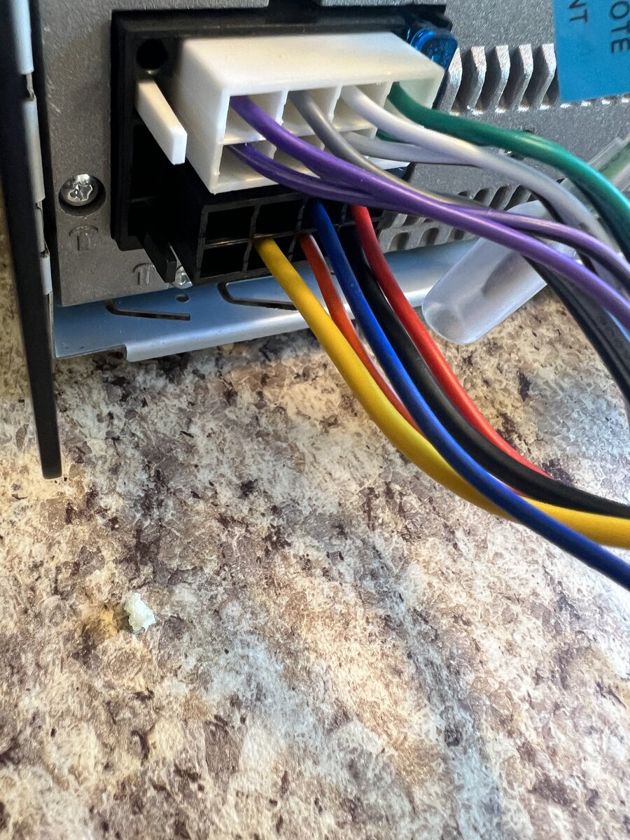

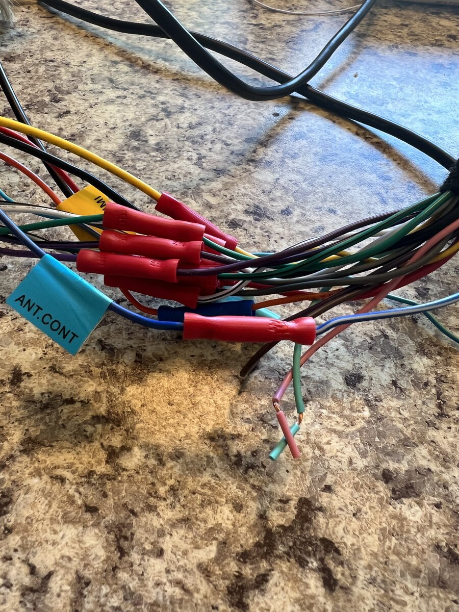

Okay so I'm back at home and took a look. I'm not seeing a blue and white from the deck.
It's currently connected to the blue wire which I'll disconnect now
Weird that it doesn't have a blue/white wire from the deck. Definitely don't use the solid blue antenna wire. I would use your ignition solid red wire to turn on the amp.

Okay so checked with it and getting 12v out of red yellow and blue.
The one thing I'm noticing between this harness and the iDatalink one is that this one is missing the white and green amp connectors. I'm assuming this will make a difference?
Nope. I'm starting to think it's an amp issue. Maybe the amp is bad? I took it to an install shop and the guy said I had everything hooked up correctly, except that the harness in the jeep has no access to the amp via the harness. That I needed to hook into the ODBII port for digital? I tried that still failed. I'm reflashing the Maestro now and unplugged the battery for the time being to see if that makes any difference.

Okay, so I went through Crutchfield and ordered the HRR-CH1 harness. This time it worked perfectly after hooking everything up. Going to chalk this one up to a bad harness(?). Thanks everyone for the help though! I really appreciate it!
