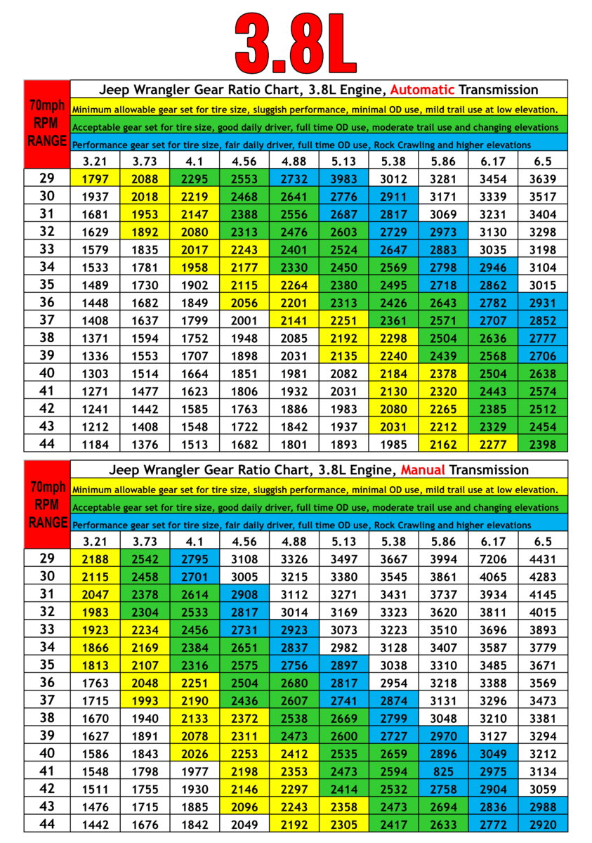

My issue just got more complicated. I thought I had 3.73 gearing, but went to confirm and it turns out that I have 3.23 (Dana 30 in front, Dana 44 in rear) Ugh. Now, I have to decide whether the project is worthwhile. And if I regear, do I go 4.10 or 4.56? And what else do I need to consider with this? Other parts that need to be upgraded or changed?
If you do a tire size change and gear change you have to recalibrate your speedometer. You could probably go the next size taller tires then stock without doing a gear change.
My Jk had 35's on it when I bought it and with my 3.21 gears it wasn't a good combo at all.
I have 255/75's on there now, which are 32". I'm planning on going to 33". Looking at the Jeep gear chart, with the 3.21 gearing and 32" wheels, I'm already in the yellow (suboptimal range) and the 33" tires would put me in there further. A 4.10 or 4.56 gearing would move me into the green or blue acceptable or optimal zones.
Interesting. with my rubicon 4.10 manual trans I can apparently go up to 35s with no issue. I'll look into that when it is time to get new tires. Got many miles before then.
I feel for you. I'm unsure why 3.21 is even an option.
