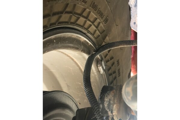

Not all wheel speed sensor wire problems are this obvious, but clearly, this one was causing the pretty light festival on the dashboard. When you modify your suspension, brake lines and wheel speed sensor wires must be long enough to allow for the extra wheel travel but carefully placed out of harms way when compressed.

For liability reasons, we ground rental Jeeps that have an ABS light on. Usually, this is a wire to a wheel sensor that has been damaged, not actual brake malfunction, so you can visually inspect at each wheel to see if a wire is rubbing. If you don’t have brake fluid leaking somewhere (you will know quickly, as your brakes will stop working), just know that your anti-lock brake and stability control system will likely be offline until you can get it fixed.

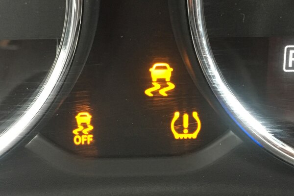

The ESC Off light is the bottom left. It will be on normally when you are in 4L. The top right ESC light (also known as the “snakes chasing Jeep” or “bacon road” light) will flash when the ESC system is activated, but it will be solid when the ESC system has malfunctioned.

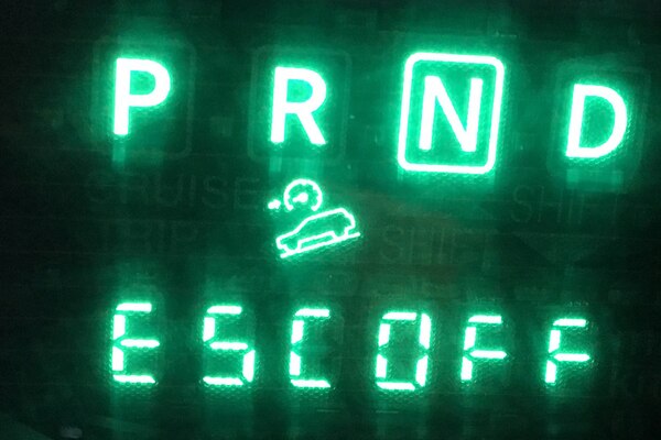

Another indicator light that will likely illuminate when you have a faulty wheel speed sensor wire is the hill descent control, as well as the ESC OFF message. Different model-year JKs have the HDC light in different places on the dash board, and very early JKs used ESP (electronic stability program), not ESC (electronic stability control).

This is the “snakes chasing Jeep” light, not the “ESC Off” light, which will normally be on when you are in 4L. Though the electronic stability control will not be operational if that light is on, it is not necessary to park the Jeep immediately, unless the malfunction is causing the braking system to activate constantly while driving the Jeep normally. Usually you either have a bad clock spring or you hit something and bent or knocked your frontend out of alignment. These are the steps we take. First, check tire pressure—all four tires should be within 2-3 psi of each other. Second, check steering wheel—is the steering wheel straight when driving the Jeep straight or is the steering wheel cock-eyed? Adjust drag link as necessary (and get a professional alignment as soon as convenient, and see what else you may have damaged in the process). Third, if you have performed the above, the steering wheel is straight, and the light is still on after driving for 3 or more miles, the Jeep usually requires a clock-spring sensor replacement.

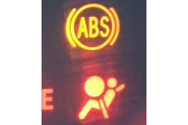

Though the ABS light (top) is usually caused by a damaged wire or wheel speed sensor, it still means that your stability control and ABS may not function. The airbag light (bottom) is not related to the ABS light. The airbag light is most commonly a malfunctioned clock-spring sensor. Those two systems are not interrelated.

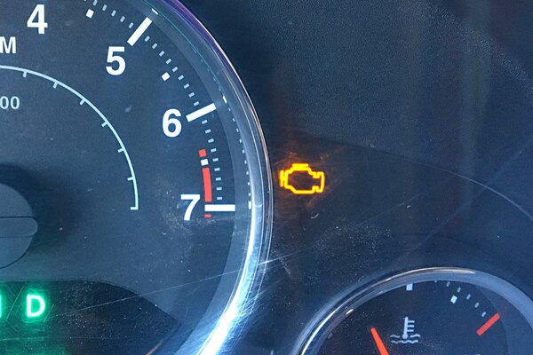

Though a solid engine light is usually not a dire issue, it should be dealt with at your earliest convenience. If it is flashing, do not ignore it. Stop driving as soon as it is safe to do so and call a tow truck.
ENGINE
If you have owned any car manufactured since the early ’80s, then you have seen this light and probably been conditioned to ignore it. However, a flashingengine light is extremely bad. Park the Jeep immediately and call a tow truck to take it to the dealer. It means the engine is sensing a misfire and there could be dire consequences if you continue driving. A solidengine light can be a myriad of sensor issues, and we consider it OK to drive for a while unless it is running “funny.”
So, in summary, a flashing engine light is bad, but a solid engine light is OK. A flashing ESC light is OK, but a solid ESC light is bad. An ESC Off light is normal. An HDC light is normal, unless you are not in 4L and the ESC Off light is also on. Clear as mud?
