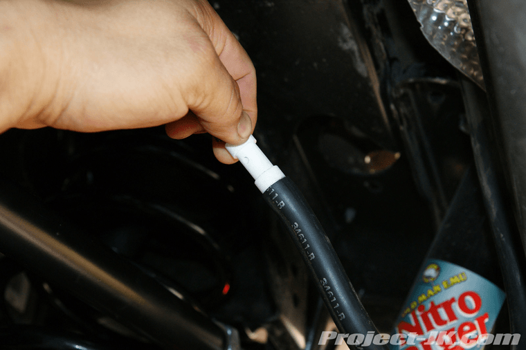

1. Here’s a shot of what you will need in order to extend your axle breather hose. As you can see, I chose to use a universal vaccum double male hose connector and 1/4″ fuel line for this mod.
2. Determine the size you need the universal double male connector to be and cut off the excess with a pair of scissors or utility knife.
3. Insert one end of your double male connector into your fuel line hose.
4. Climb under your Jeep and pull the breather hose off the brass nipple on your axle.
5. Insert the opposite end of your double male connector into your Jeep's breather hose.
6. Loosely zip tie the breather hose to the cross member above your rear axle as shown.
7. Plug your newly extended breather hose on to the brass nipple on your axle.
