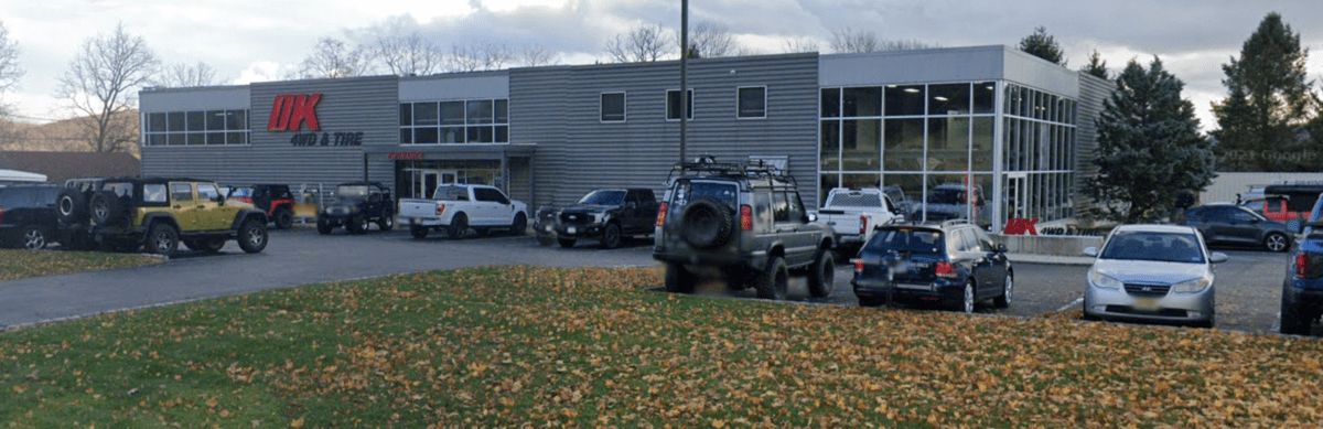

My brother in-law has a JKU and gets all his tire work done at:
OK 4WD & Tire
2621 SR 57
Stewartsville, NJ 08886
908-454-6973
All they do is alignment, front end, tires etc.
