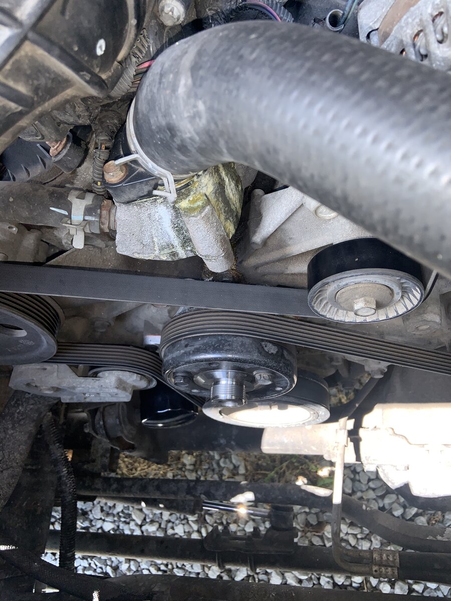

Had an issue with my jeep last week Of it over heating. Changed the radiator water pump and thermostat and all was good until last night I seem to be having a new problem. Not sure if it’s related at all but the Jeep made a loud noise like something getting stuck in a fan and the brakes stopped working and now the Jeep won’t turn on. Any ideas ? Also, when I checked under the hood it now looks like corrosion on the new water pump and thermostat or like something was leaking onto it.

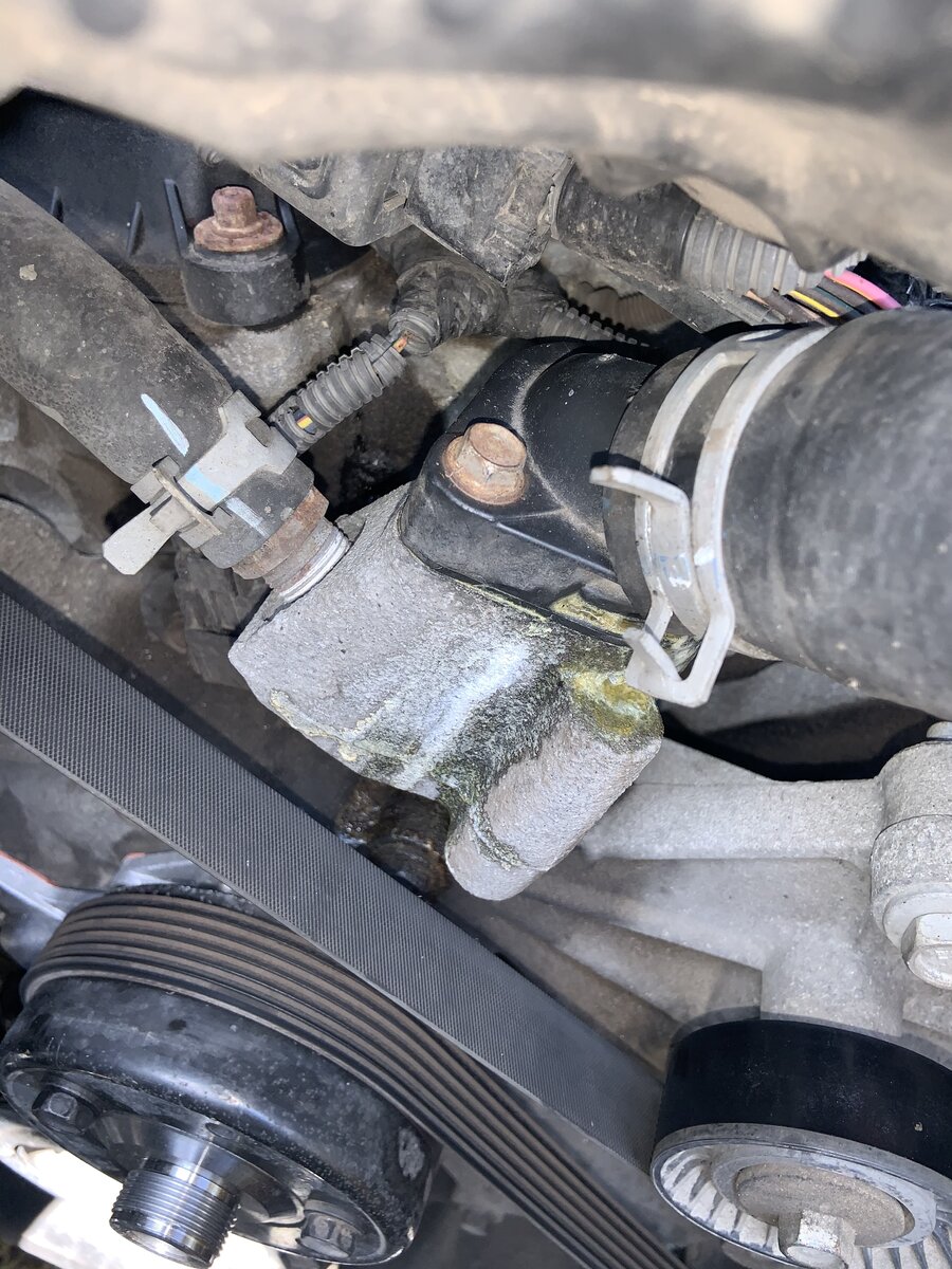

Edit: just checked under the hood yet again and I can see coolant dripping from the thermostat

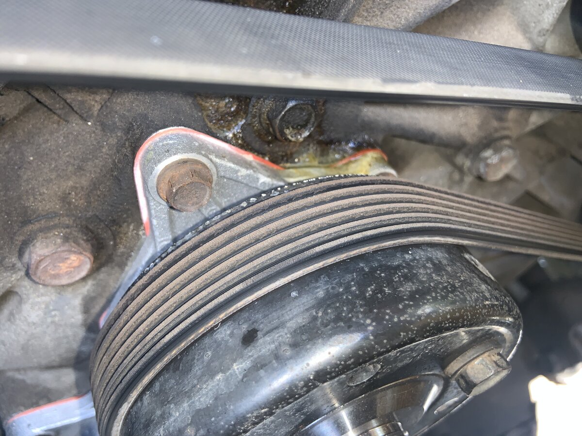

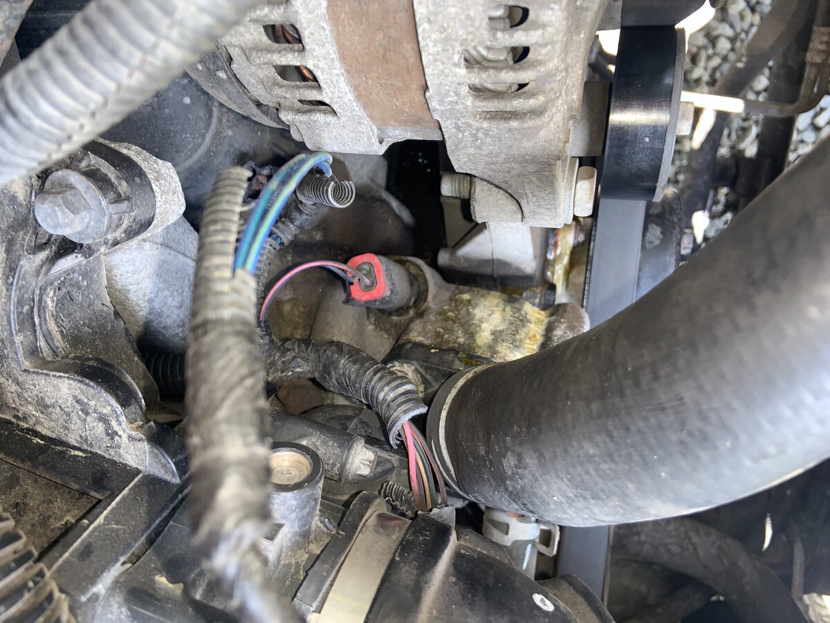

It sounds like it is trying to crank over to turn the engine on but gets stuck when doing so it just keeps running and running. I’ve checked all fluid levels and they seem pretty fine, this actually happened last night on my way home from having my oil changed. Also I edited the original post with pictures of it leaking. I can now see that it is coolant that is dripping from the thermostat onto the water pump.

So is the starter stuck on then? It runs but starter stays engaged or it won't start? Also if it just cranks over but won't start, there could be a sensor out of adjustment or not working that keeps the engine from starting. Does it sound like the engine starts to fire but then doesn't and keeps cranking?
You may need to borrow a scantool to plug into the OBD II port under the dash from autozone or something to see if there is a trouble code stored.
Also the gasket seal at the thermostat housing or the hose may be the trouble with your leak.
