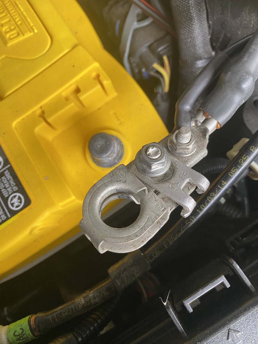

That clamp design isn’t great at all.
Instead of effectively tightening the clamp around the post when the nut is tightened, it bent the tabs.
I was able to lift the clamp off the battery without even loosening it!
Disassembled the clamp, bent the tabs, put it back together. Cleaned up the post, reconnected and problem solved.
That is a terrible design! I had not paid any attention to the design, so I just went and looked. Ours are like yours. Yuck!
I use clamps like THIS on the Vette. I'll have to order some and swap them onto the Jeeps too.
