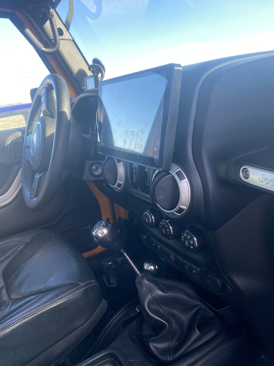

No, the sizing is off for any aftermarket option that I could find.
This is why I bit the bullet and opted for the 10.1” Android version from Amazon.
It came w/ new dash panels that look great and fit as well as one would expect from an aftermarket maker.

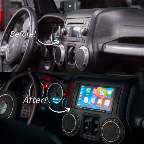

The Jeep dash panel opening is a really odd size, so there's little that will fit it directly.
There are "floating" units, like the Awesafe options that I used on our Wranglers. Their base fits in the OEM dash opening and the head unit "floats" in front of it. They cost about $260 on Amazon.
There are also units like the Stinger that replace dash panels to create a larger opening. They cost about $1150 on amazon. Are they worth quadruple the price? Not to me, but you're the only person who can decide for you.
