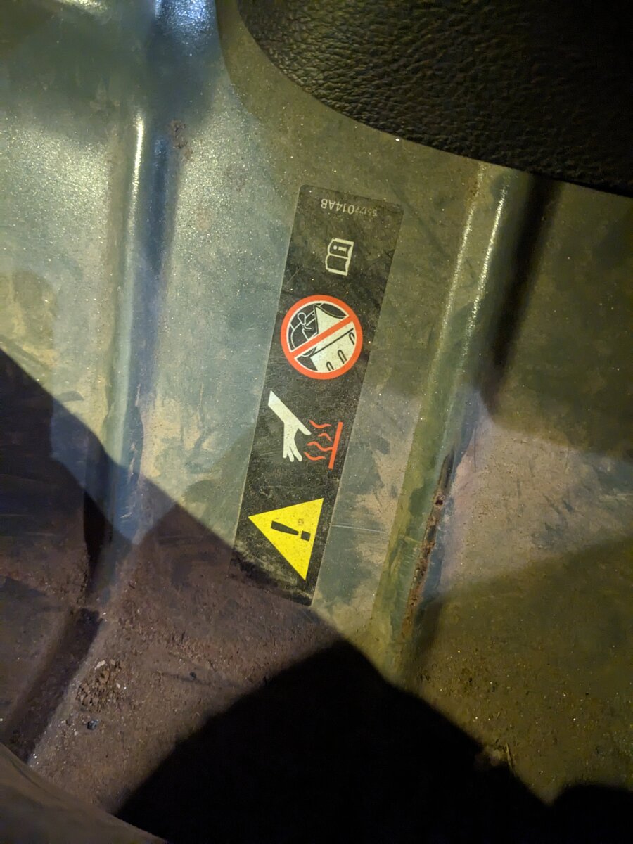

Are the carpets removed? The floors do get hot. I ripped all the carpet out of mine and found some warning stickers underneath about that so they do expect some amount of heat in that area.
No, in fact I've also have a carpet floor mat so that's double the insulation. But the heat's not coming from the floor, rather it's from under the dash and steering column area.
