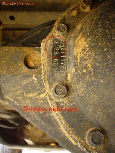

You should be able to.. provided somebody didn't remove it, look at the tag on the diff cover. crawl down there with a rag as it will probably need to be wiped off to read it.
@Chris has a post from a while back with a how to on the subject.
