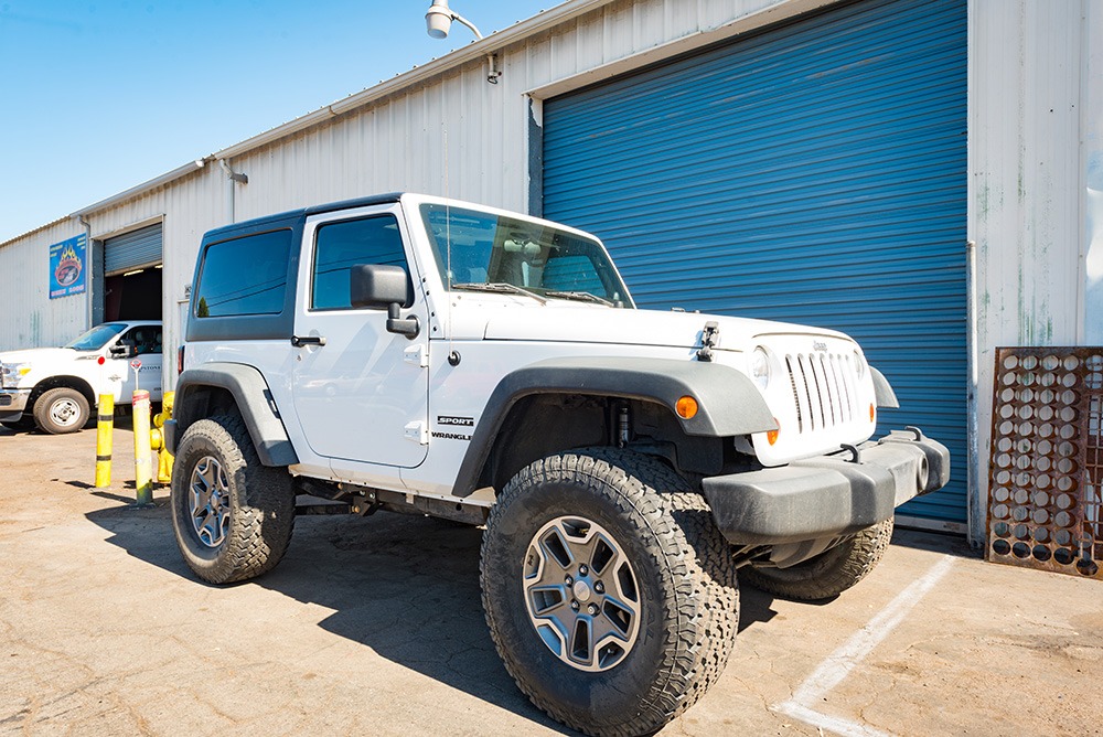

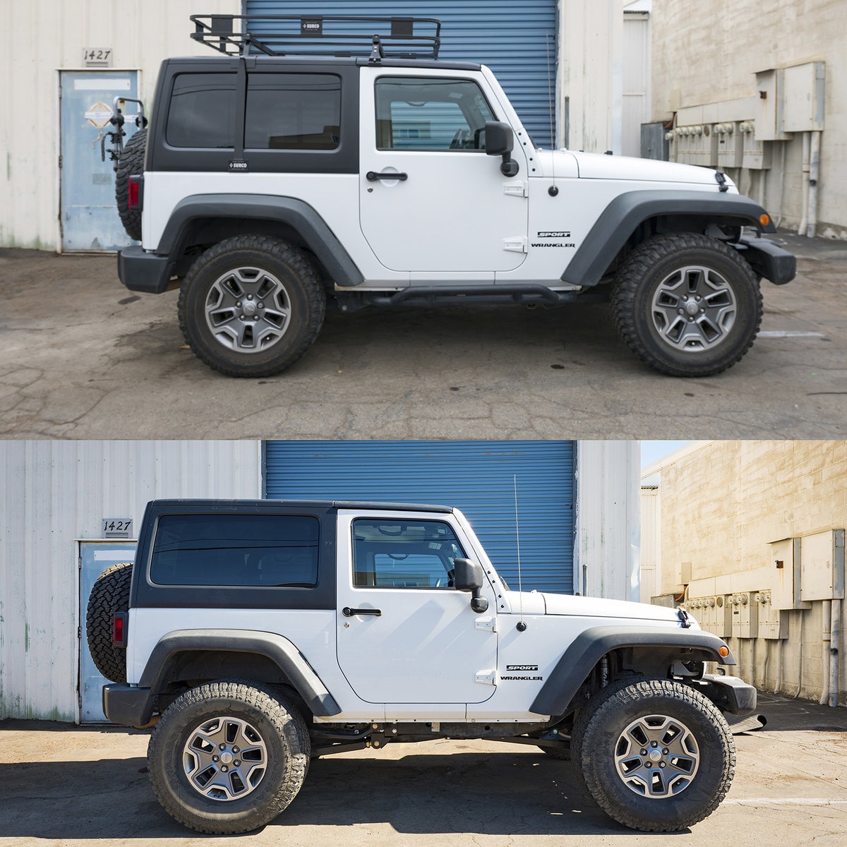

The 3.5" kit we make for the JK was made to fit 35" tires, so I would think 4" of lift from whatever manufacturer you're looking at would be able to clear 35's no problem. As for your backspacing question, truthfully I'm not sure how 15" wheels would work, as I know even Jeep themselves doesn't recommend using anything under 16", but for a traditional 17" wheel we recommend 4.75" of backspacing when using our lift kits, so hopefully that helps you out a little bit! I'll include some pictures of a JK with 3.5" of lift running 35's so you can see how it looks.
Before and after:
