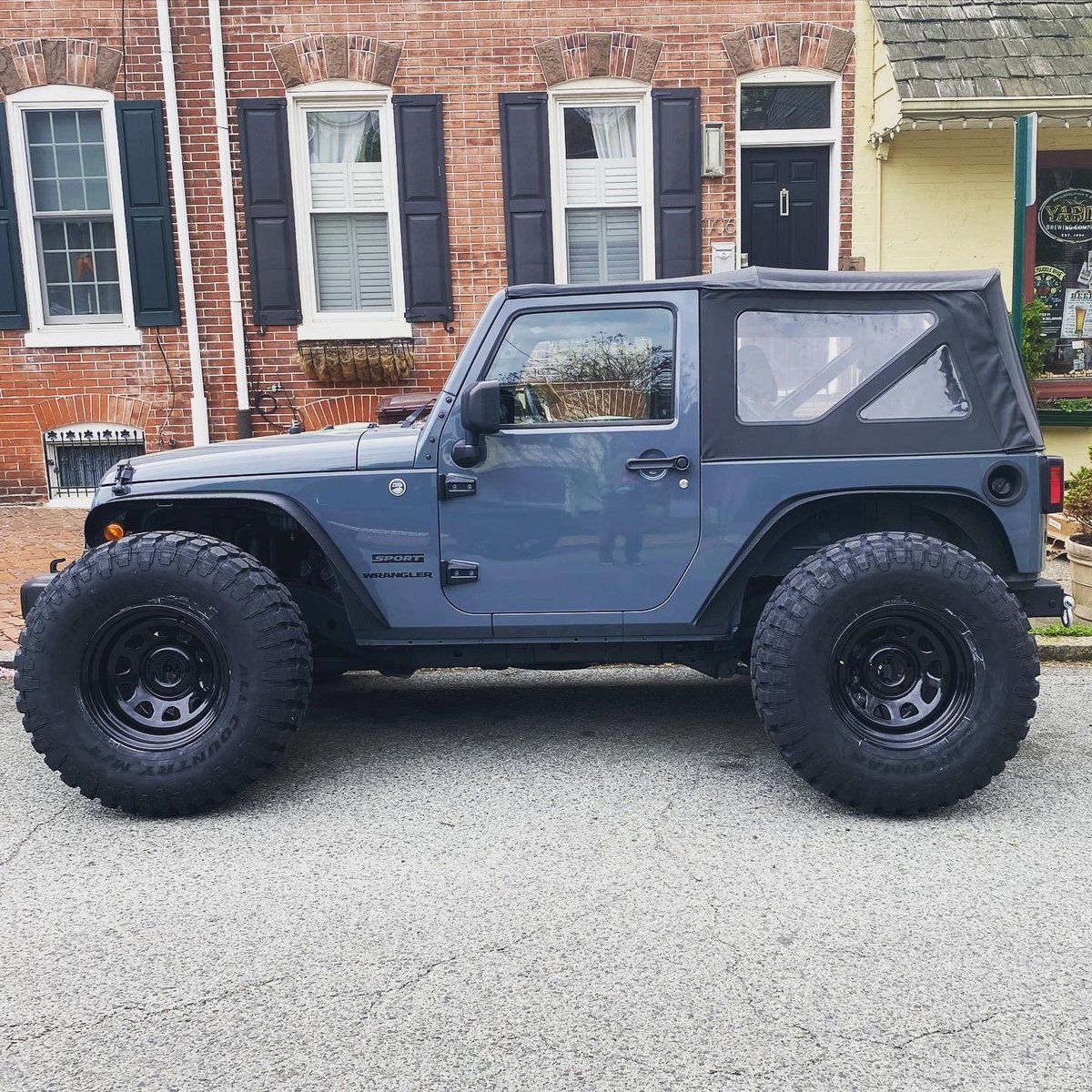

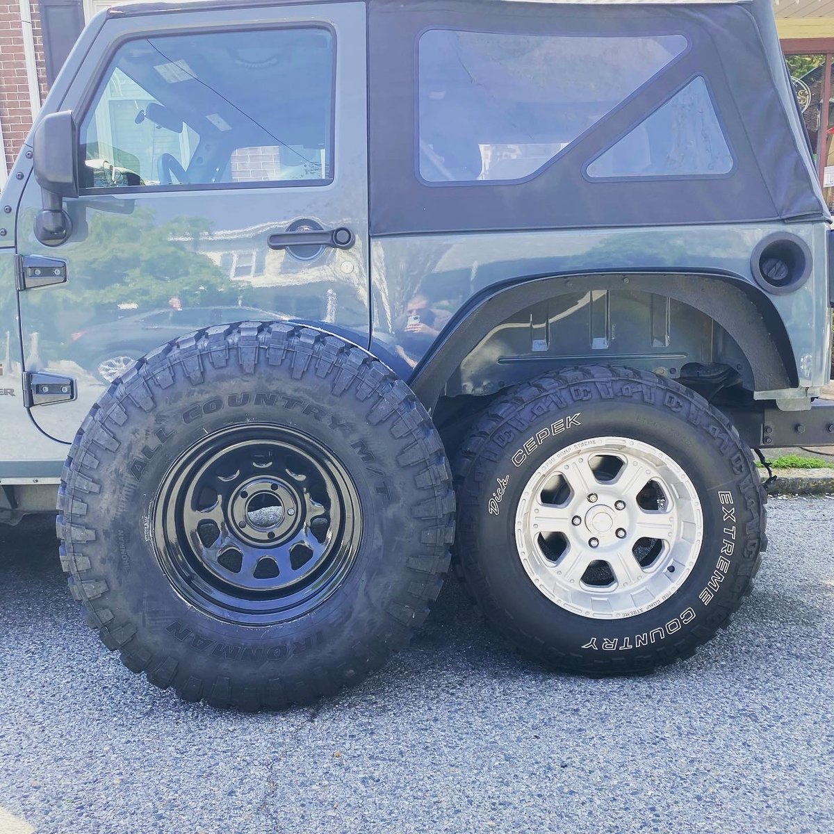

Holy moly....that’s high! You could definitely throw a winch on there to get the front to drop a little.@Maximus What lift did you decide on. I installed a 2" Mopar lift on my light 2dr JK and saw a 4" lift up front and 3" rear. My 33's looked tiny so I ended up replacing them with 35's. I want to install some MCE flat fenders so I may consider downsizing my springs so for better scale (in my opinion).
Yeah definitely looks silly with them placed like that. I can’t wait to see it eitherLooks like the new offroad lowrider styleThat will look good. I'm partial to Anvil though as we have a 4 dr in Anvil. Looking forward to seeing the end result.
