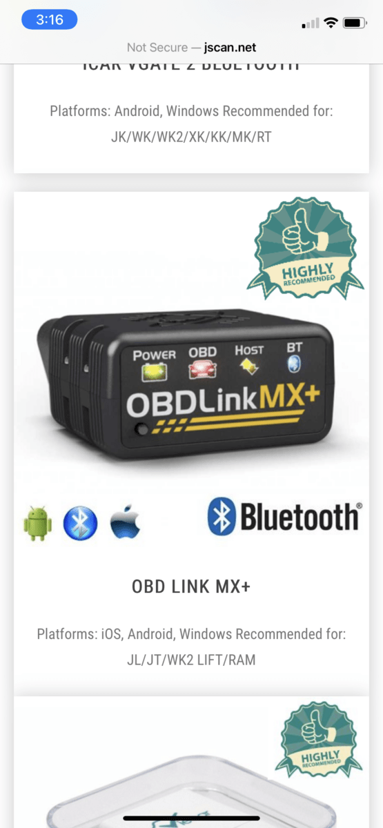

I just ordered the Icar pro from Amazon. The ODB Link M+ will not work for JK's. That what it says on the list of supported OBD's
This is the one I was referring to. The screen shot is from Jscan. Works fine with my '17 JK.
