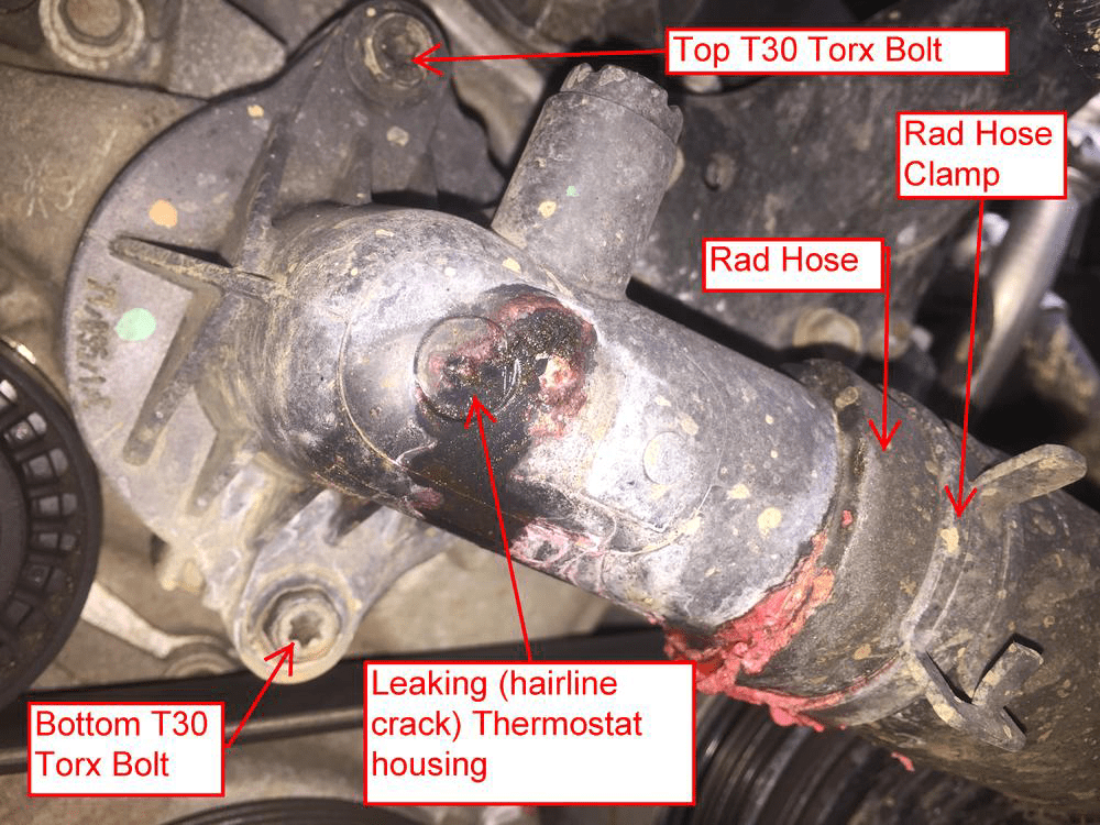

  6. After some searching/digging around under the hood, I found dried up coolant residue on the thermostat housing.

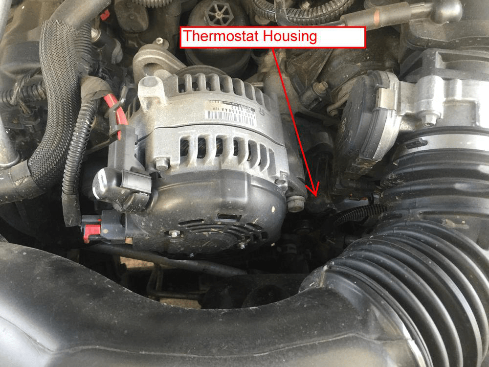

Make sure you are parked on level ground. Open your hood and remove the engine cover. Also...your engine should be cold when doing the initial housing replacement.
Step 2:

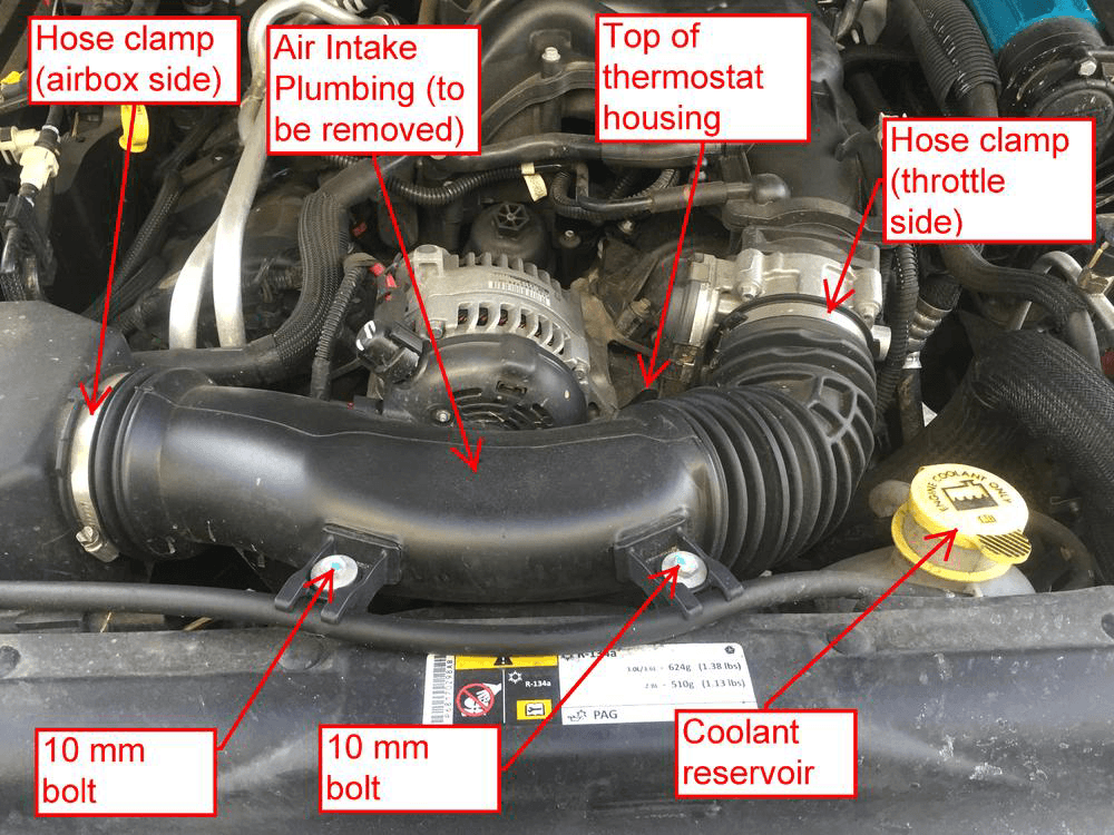

Using your socket wrench and 10mm socket, remove the two bolts holding down the air intake plumbing between the air box and the throttle. Then using your flathead screwdriver, loosen the hose-clamps at the airbox and the throttle. Also pop out the thin hose from the clips that is held in near where the 10mm bolts come out. This small hose stays in place, but just needs to be removed from the clips.

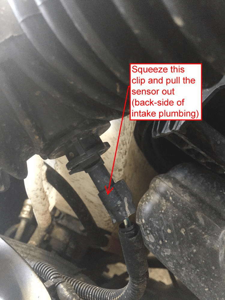

Step 3: Disconnect the sensor on the back-side of intake plumbing.
Step 4: Remove the intake piece and set it aside (you should now have better/more access to the thermostat housing)

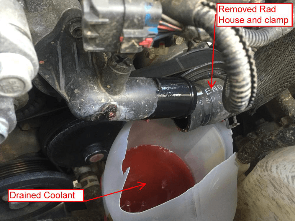

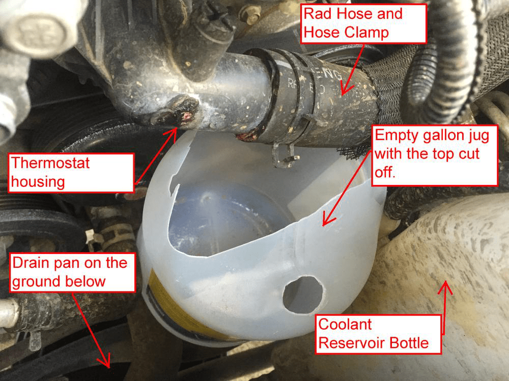

Step 5: Place a small bucket/jug below the thermostat housing, and a drain pan on the ground below that to catch any coolant that may leak out in the following steps. Make sure that the jug can be placed in and removed in a vertical orientation. If you need to fish it in there, it may end up spilling the drained coolant on the way out.
Step 6: Using your pliers, squeeze and slide the hose clamp on the radiator hose going to the thermostat housing over to the right. After the clamp is off slid out of the way, twist and pull the radiator hose off the housing (it may need some coaxing). Note: At this point, coolant will probably start to flow out of the hose and drain into the bucket you put down below it. Also, remove the radiator cap to help the coolant to drain. Radiator cap is not pictured, but its on the left side of the radiator just above the grill as the hood is open.
Step 7: Using your T30 Torx Socket, with socket wrench and short extension loosen the top and bottom bolts holding the thermostat housing to the engine block. Note: More coolant will leak out from behind the thermostat, out of the engine block. It will probably be difficult to get this coolant into the bucket below, which is why I had another drain pan on the ground. A couple of shop rags will help sop up the extra coolant that you can't catch.

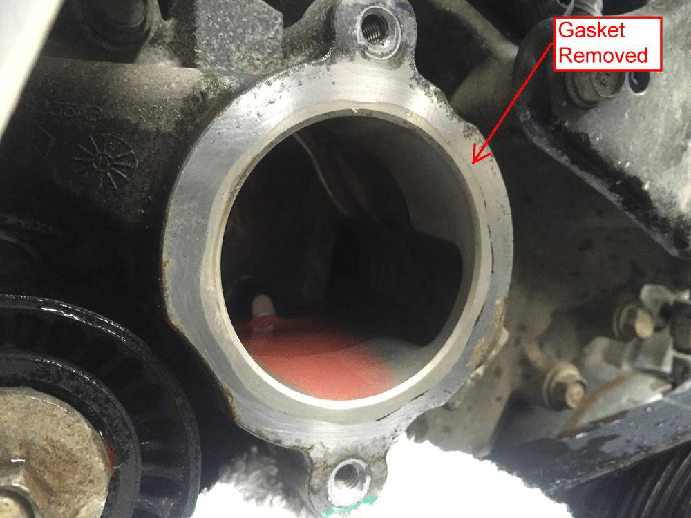

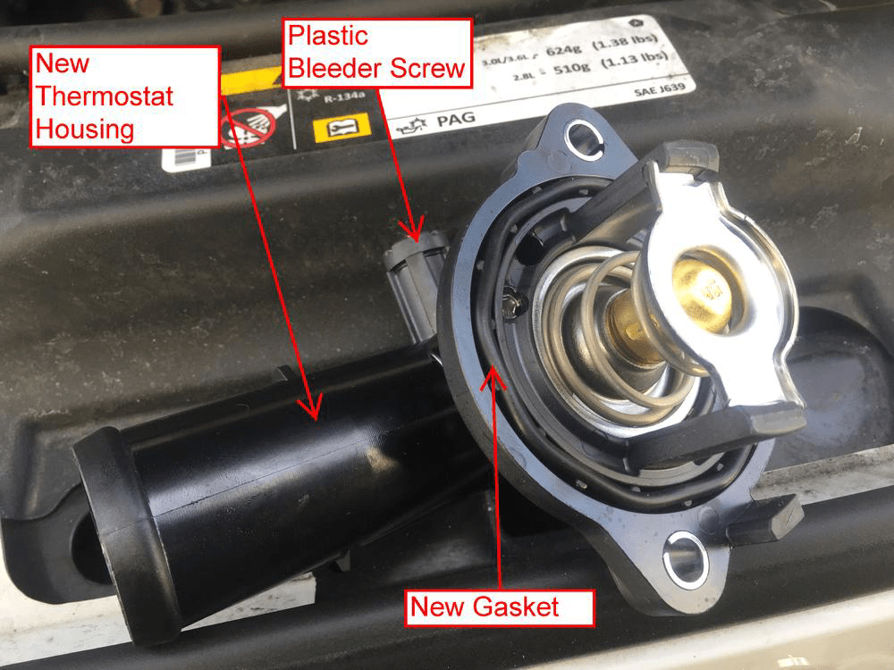

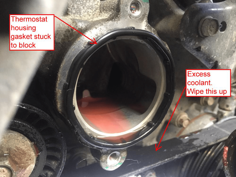

Step 8: Remove the old thermostat housing and take a look to see if the gasket came with it. In my case the old gasket was left behind. Make sure you peel this off as the new thermostat housing has a new gasket already pressed into it. Make sure you scrape away any excess residue or piece of the gasket left behind. Start with a plastic scraper (old credit card?) so you don't mar the mating surface (which may end up causing more leaks).

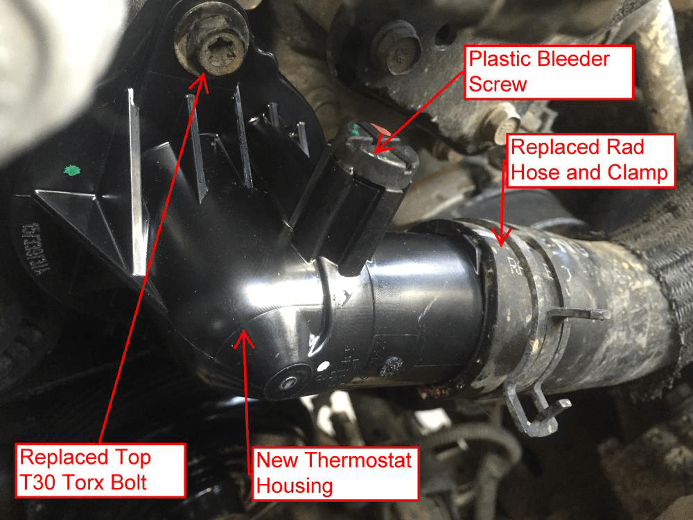

Step 9: Install the new thermostat housing in the same orientation as the one you just removed. Replace the top and bottom T30 Torx bolts. I believe these should be torqued to 105 in-lbs. If you don’t have a torque wrench, then you should be safe with getting the bolts snug tight, then about a 1/4 turn after that. The key here is to NOT over-tighten them. You can loosen the bleeder screw on the top of the new thermostat housing a bit at this point as well.
Step 10: Replace the radiator hose and hose clamp onto the new thermostat housing. Make sure you push the hose up to the stopper on the thermostat housing and then replace the hose clamp so that it is beyond the "knurled" end of the housing. Once this is complete, add coolant into the radiator until it starts to bleed out of the bleeder screw you just loosened. Then tighten down the bleeder screw (hand tight, I used a pair of pliers because access was pretty tight, but again do not over-tighten.) You can now remove the bucket from earlier that should have drained coolant in it.
