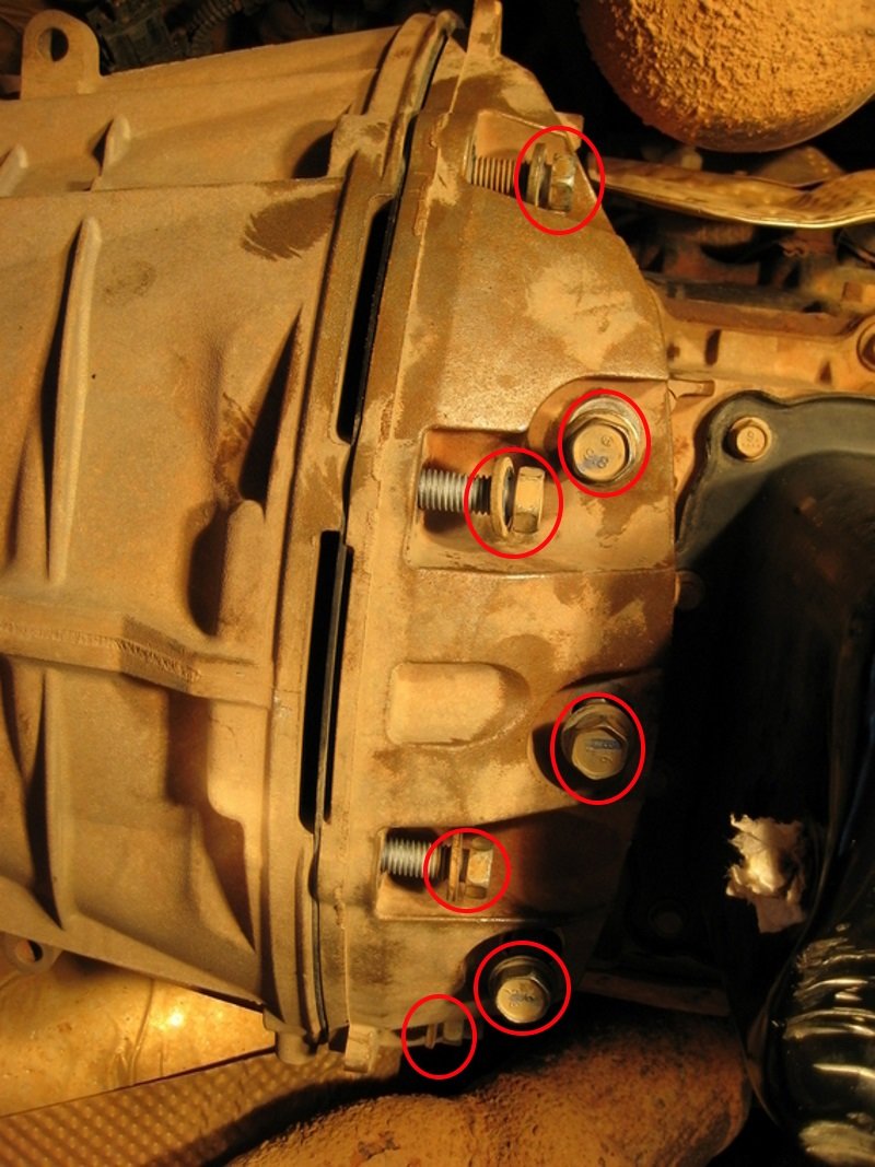

Step 3 – Remove transmission dust cover
Remove all seven bolts from the transmission dust cover. Once removed, lower the cover off the engine/transmission.
Figure 4. The transmission dust cover.
