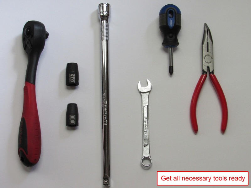

Parts and tools needed:

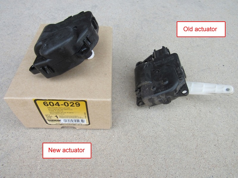

1. Jeep JK A/C Blend Door Actuator by MOPAR, or Dorman A/C Heater Blend Door Actuator
2. 3/8″ Ratchet and 8mm & 10mm sockets
3. 10″ Long 3/8″ Drive Extension Bar
4. 8mm Combination Wrench
5. Stubby Phillips Screwdriver
6. 45-Degree Bent Long Nose Pliers

Prepare your tools and get everything ready before you start the project.

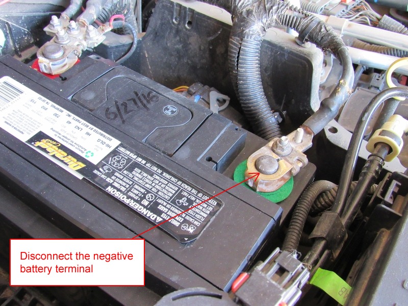

Disconnect negative terminal of your battery. This is an optional step, however you are going to be disconnecting and reconnecting electrical connectors inside your Jeep during this project.

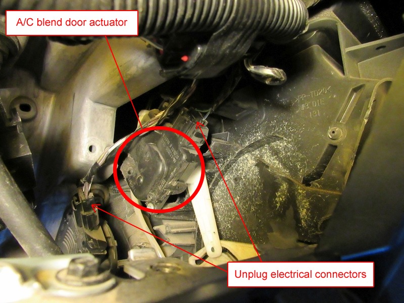

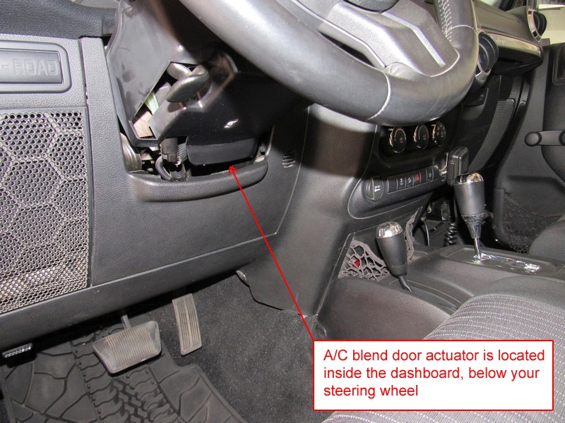

The driver side A/C blend door actuator is located inside your Jeep’s dashboard, below your steering wheel. Removing your driver side door completely will help you with access to the components you’re going to be working on.

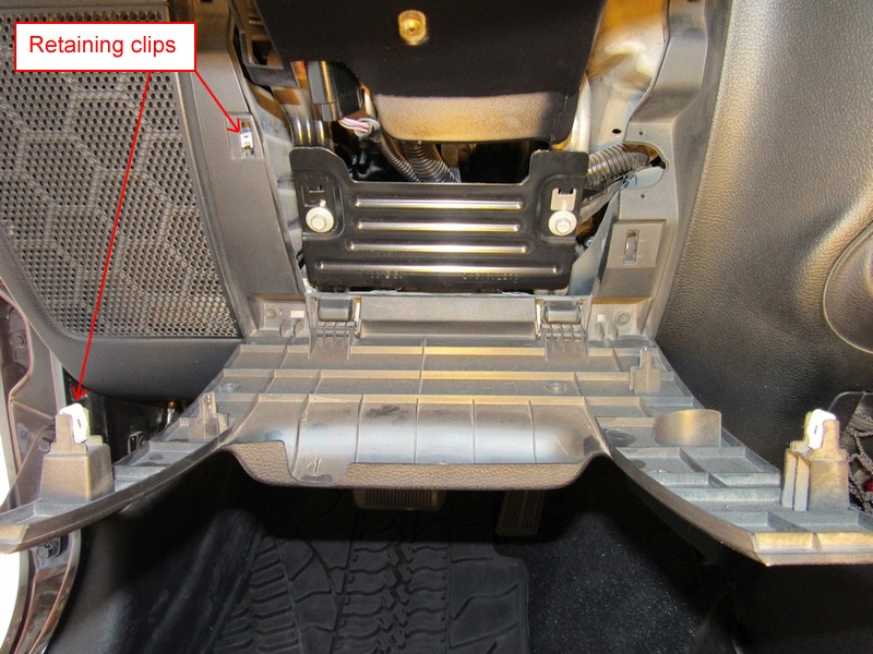

Remove the plastic panel below your steering wheel. It is held in place by four clips. Start from the top and pop it off. It will tilt downward on the two plastic hinges at the bottom. Put the entire panel to the side.

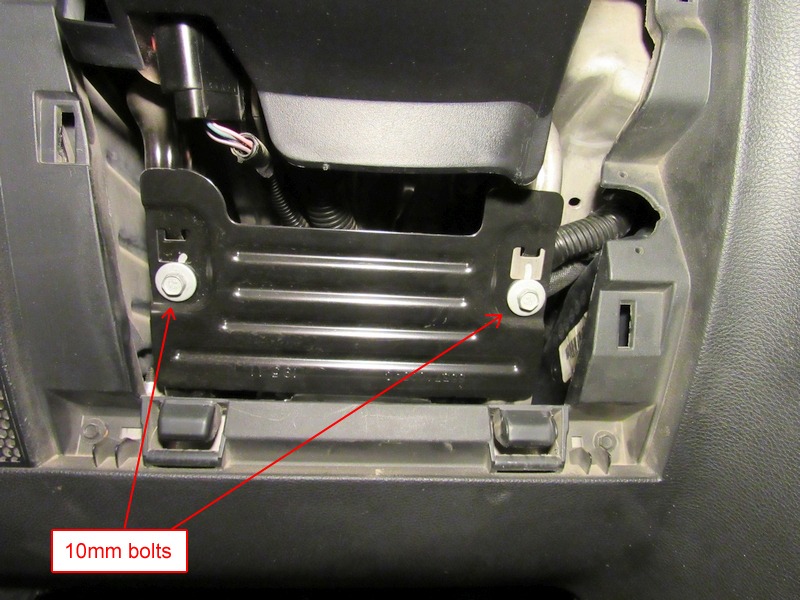

Remove the metal plate by unscrewing two 10mm bolts.

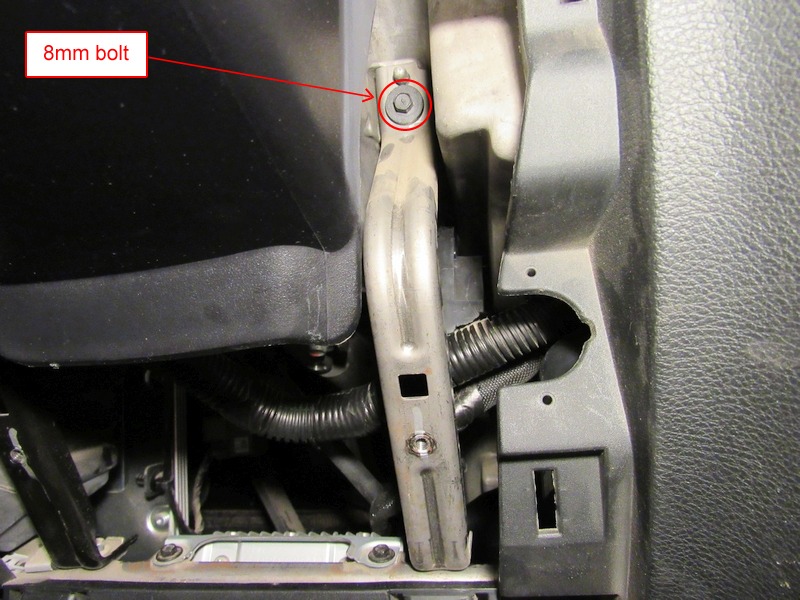

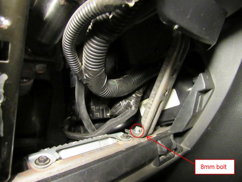

Removing the metal brace on the right side will provide better access to other components. Remove the top bolt using an 8mm socket.
Step 7:
Remove the bottom bolt with an 8mm wrench.

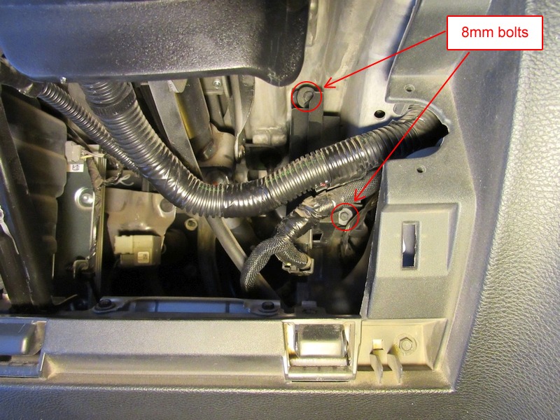

Unscrew two bolts securing the control box, using an 8mm socket with 10″ extension. No need to unplug the box, however you will need to pull it away from the Jeep’s body and twist it, in order to move it away from the actuator and gain better access to it.

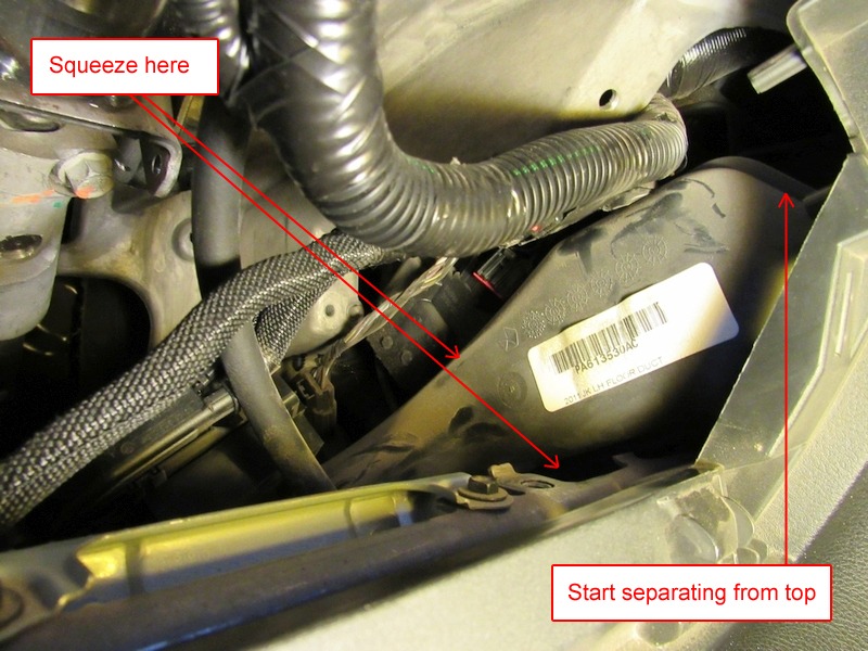

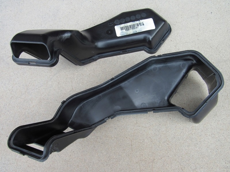

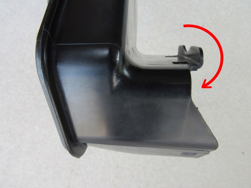

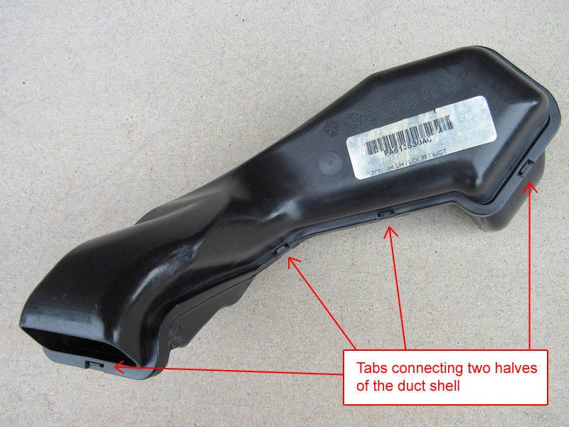

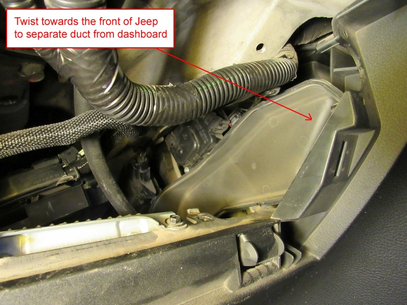

For total access to the blend door actuator, it’s arm and the track, you will need to remove the air conditioning floor duct. The duct is made out of two plastic pieces, held together with seven tabs. Separating the two halves and pulling them out is going to be the most time consuming and irritating part of the entire project. Take your time and be patient. What I found to work best is to squeeze the outer shell of the duct in the middle with one hand, and with your other hand place your finger between the two halves right at the top. Carefully but forcefully run your finger along the edge of the duct and you should be able to feel the outer shell separating. As soon as you get more leverage, the process should become easier. Be mindful of all the wires in the area. When you finally get the outer half of the duct free, pull it out thru the bottom of the footwell.
Step 10:
With the outer portion of your Jeep’s floor duct gone, it’s time to remove the inner half. It is not held in place with any screws, it is only attached at the top by being pushed into an opening in the distribution housing. The duct is held there with a couple of tabs. I found that simultaneously twisting the duct upwards and towards the front of the Jeep, helped with the removal. It is a slow process as the duct seems to come out just a bit at a time. Again, be patient and take your time. As soon as you get it loose, simply pull it out thru the bottom of the footwell. Pay attention to the way it’s coming out, so you can reverse the process later on.
Better view of your Jeep JK driver side floor duct assembly.
Floor duct’s two halves with the tabs holding them together.

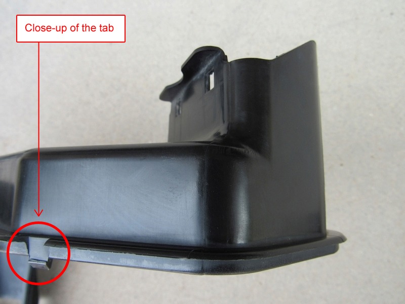

Closeup of the edge and one of the tabs.
Upper portion of the inner shell of the duct, with the holes and bend/tab holding it secured to the dashboard.

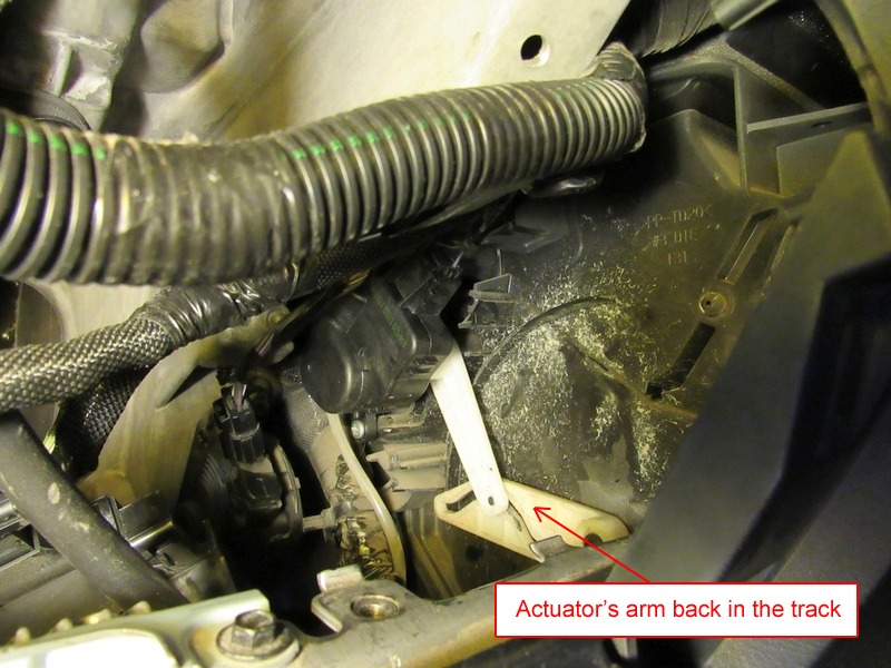

With the air duct gone, you now have full access to the actuator and the track that it connects to. Before you remove the actuator, unplug it’s electrical connector. You can also unplug the accelerator pedal connector, for better access to the two screws securing the actuator in place. Carefully remove the two screws with a stubby Phillips screwdriver, making sure you don’t strip or drop them. Pull out the blend door actuator, with the arm attached.

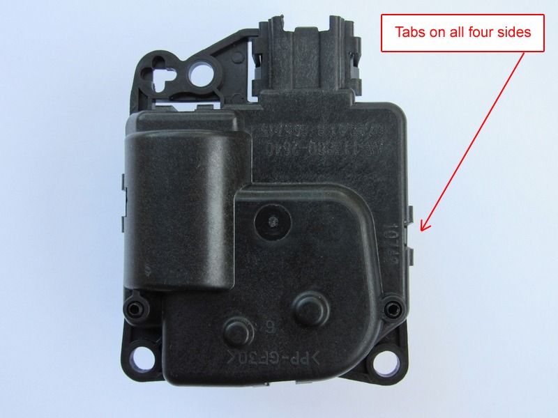

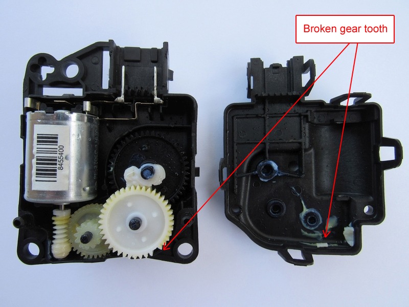

You can open up the actuator if you want to inspect the mechanism inside, and the damage causing it to not work properly.
The most common reason for the actuator to fail is a broken gear tooth. These gears are made of plastic and brake without warning. It would be nice if these gears were metal, however I don’t believe that’s even an option on brand new replacement actuators.

Carefully remove the plastic arm attached to the old actuator and transfer it to the new one. Try attaching it at a similar angle.
Step 14:
Install your new blend door actuator. Position the pin of the arm inside the track, position the body of the actuator in place, and secure with the two screws. I found it helpful to use the 45-Degree bent long nose pliers to hold the screw with one hand and operate the stubby screwdriver with the other hand. Plug in the electrical connectors of the actuator and accelerator pedal. If you wish you can reconnect your battery now, to test your new actuator, otherwise reconnecting the battery can be your last step. If everything seems to work correctly, start carefully installing the air duct back in place. Make sure no wires get in the way while you snap the two halves of the duct together. Secure the control box back in it’s location, install the metal brace and the plate, and finally push-in the plastic panel under your steering wheel.

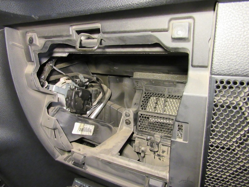

As a reference, here is a picture of the “directional” actuator, located behind the glove box, on the left side and mounted to the center console. The recirculation door actuator is located on the right side of the air dam, behind the right speaker, and not visible without removing the speaker box.

Put your new motor and old motor on a bench oriented the same way. When you remove the actuator arm from the old one, note carefully how the arm is oriented relative to the motor shaft. The shaft has one missing tooth but the arm doesn't; consequently the arm can go on in about 8 or 10 different WRONG positions. The missing tooth on my old motor was about 45 degrees different from the new motor and I couldn't turn either shaft without risking breaking something. So I installed the arm in the new motor so that it was also 45 degrees different. In other words, I made the arm match the position of the missing tooth, but you have to pay close attention when you remove the arm from the old motor since there is no reference on the arm. A smart DIY mechanic might use a marker to draw a line on the arm corresponding to the missing tooth on the motor shaft. I imagine the orientation of the old motor shaft depends on where it was when it died or perhaps where it was when the old gears stripped. In any case, your job is to install the arm on the new motor so that is in the same relationship to the missing tooth on the shaft even if the old and new shafts are in different positions.
