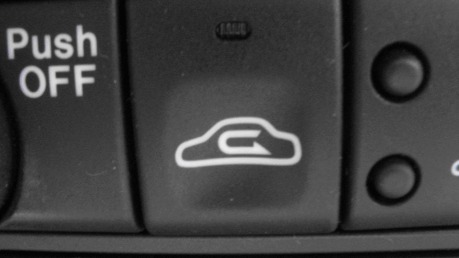

Step 2 – Enter "Recirculation" mode
Place your key into the ignition and turn on your vehicle. Switch your air conditioning system into "Recirculation" mode. This will cause the fan behind the air grate to expand and open. Turn off your engine and remove your key.
Figure 2. This is the generic symbol for "Recirculation" mode.

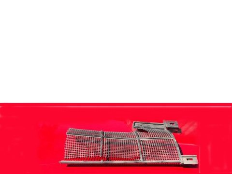

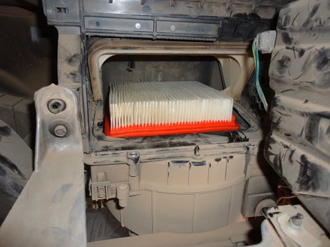

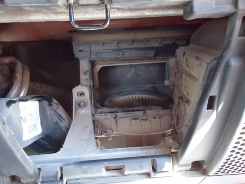

Go ahead and grab your razor or diagonal cutters and cut out the air grate, which should be facing toward the rear of the glove compartment. Discard the air grate in a trash can, and then install a replacement air filter—simply slide it in for a snug fit. You can find replacement air filters at local auto parts stores and online. Quality does not vary substantially from brand to brand; however, you will need to purchase an aftermarket air filter that is an equivalent to your original equipment manufacturer (OEM).
Figure 3. This is an old air grate.
Figure 4. Install a new air filter.
From here, you need to reinstall the glove box and then you are done.
