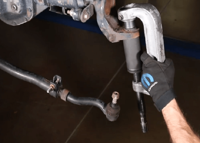

Step 14 – Remove ball joints
At this point everything has been removed to gain access to the ball joints and you can now begin to remove them. This is where you will need the ball joint press. A lot of these special tools are made by various different manufacturers. All of them are slightly different, so you will want to read and understand the instructions for the one you are using to make sure that you are using it correctly for this application.
Figure 18. Press out upper ball joint.
Figure 19. Pressing out lower joint.
