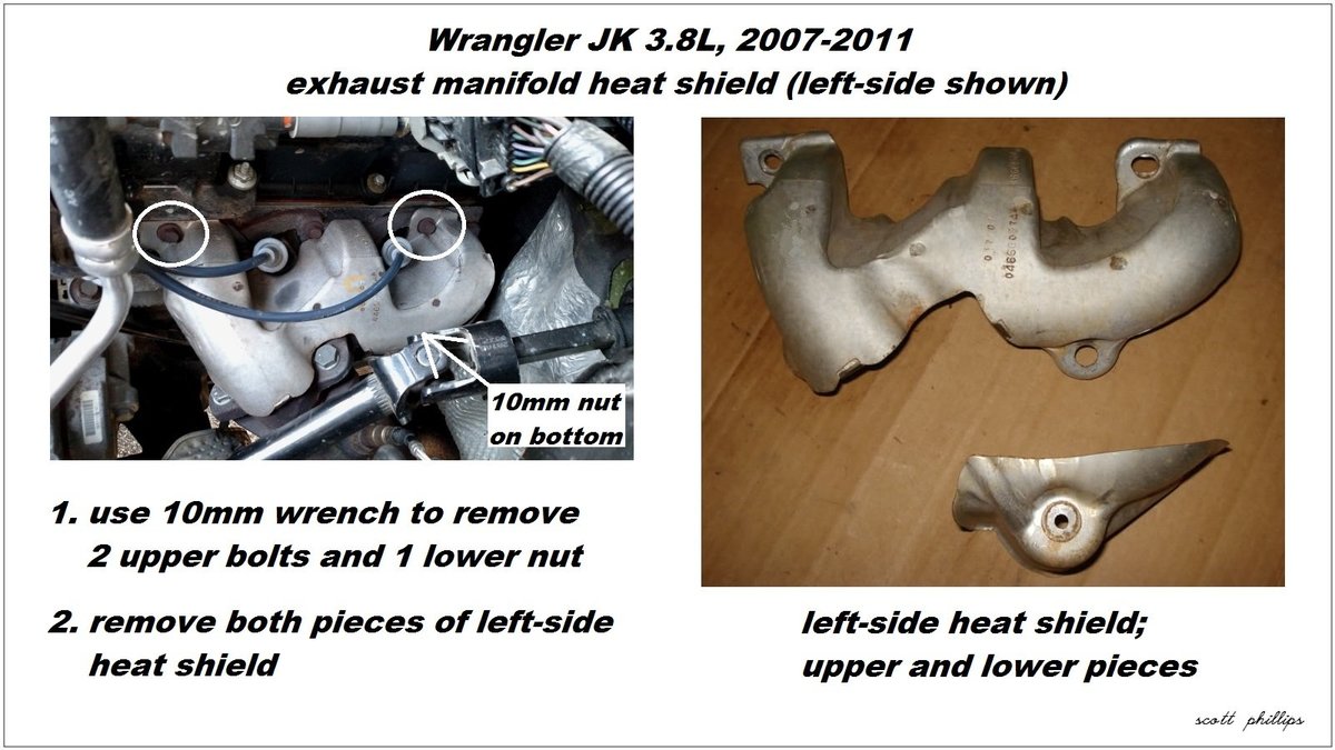

Step 4 – Remove exhaust manifold heat shields
  • Use the 10mm wrench to remove the lower nut and two upper bolts on the left-side heat shield.
  • Remove the heat shield. It has two pieces, as shown.
  • Repeat on the right-side heat shield.
Figure 6. Exhaust manifold heat shields.

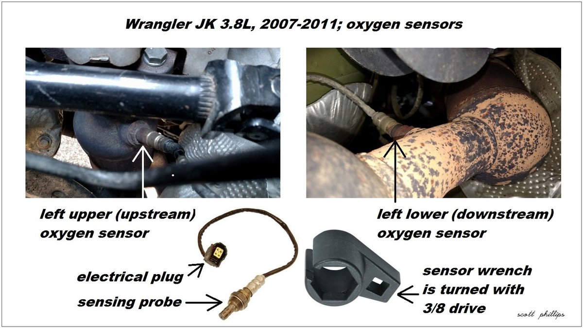

Step 5 – Remove oxygen sensors
The two upstream cats are monitored by oxygen sensors, with one sensor above and below each upstream cat.
  • Disconnect the electrical plugs on all four oxygen sensors.
  • Use the 22mm (7/8") oxygen sensor wrench to remove each sensor.
Figure 7. Oxygen sensors.
