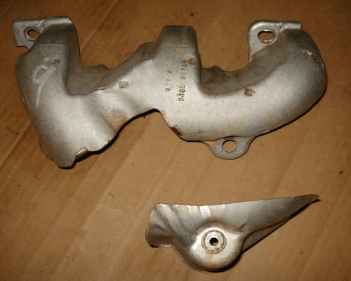

The heat shields cover the crack, so they must go. Remove the two bolts that hold the upper shield in place with a 10mm socket and a very long extension with a U-joint. The lower shield is held on by a 10mm nut. Soak it with penetrating fluid and allow to set before trying to crack it loose.
Figure 1. Exhaust heat shields.
Figure 2. Removing bolt with extension and U-joint.
Figure 3. Lower heat shield nut.
