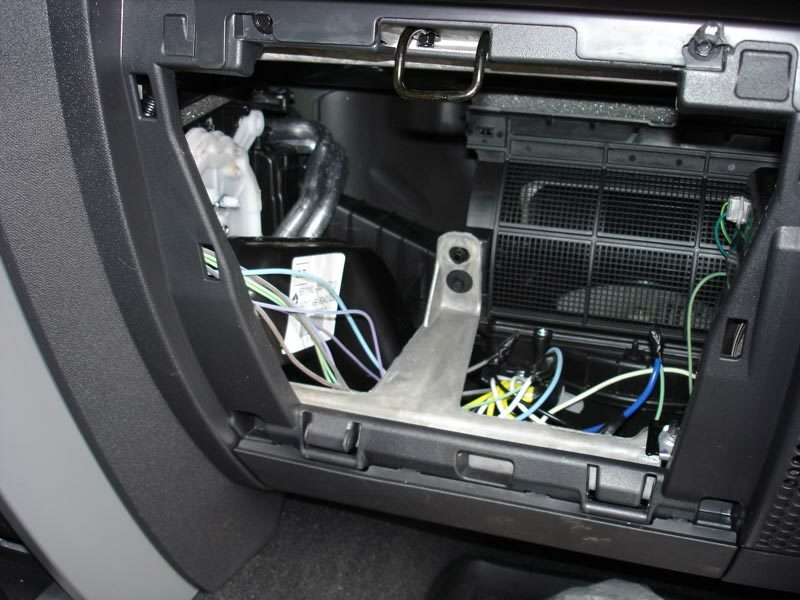

Getting to the blend box door itself involves removing the dash, which is a giant pain in the neck. But getting to the actuator is quite easy, so you can save yourself a lot of time and heartache by checking this first. Before you start, however, make sure that your coolant and R134 are topped off, as low levels can also cause this issue. The passenger's side actuator is located up underneath the dash, and can be spotted by laying on the floor and looking up (see Figure 1). Remove the motor and open it up (it simply slides up). Check the gears to see if they are gummed up. If they are, you can clean them with contact cleaner and it should solve the problem. If it looks clean, you can order a new actuator for around $150.
Figure 1. The actuators are located underneath the dash.
Figure 2. This actuator had seized up because of buildup on gears.
