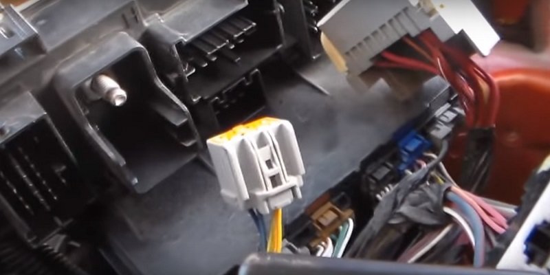

Step 1 – Remove the faulty TIPM
Lift the hood and disconnect the negative (black) battery cable before beginning. Remove the cap of the TIPM with a 13mm socket and ratchet. Remove the lead going into the TIPM with a 10mm wrench. Remove the clips that secure the TIPM to the Jeep using a small flat head screwdriver. Carefully unplug all of the connections on the bottom of the TIPM by pushing in on the small black release in the center of each grey clip with a screwdriver, then rotating the clip downward to release it. Once all of the connections are removed, pull out the TIPM.
Figure 1. Remove the cap and release the clips holding the TIPM in place.
Figure 2. Remove the connections from the bottom of the TIPM and remove it from the vehicle.
