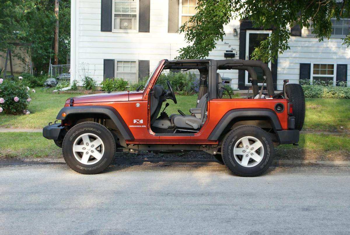

The Jeep Wrangler has a lot of features that can make it a very simple car. One of these features is the ability to remove the doors. This feature is designed based on the old Jeep Wranglers, and it is a nice feature that allows you to experience the outdoors while driving off the road. Even though you are legally allowed to drive on the streets without your doors, it's never recommended. However, when you're doing slow off-roading, it is a great feature that allows you to see the obstacles under you, while enjoying more breeze. Removing the doors on the Wrangler can be done quickly and without too much effort. Read on to learn how you can remove your doors.
Figure 1. Wrangler JK without doors.

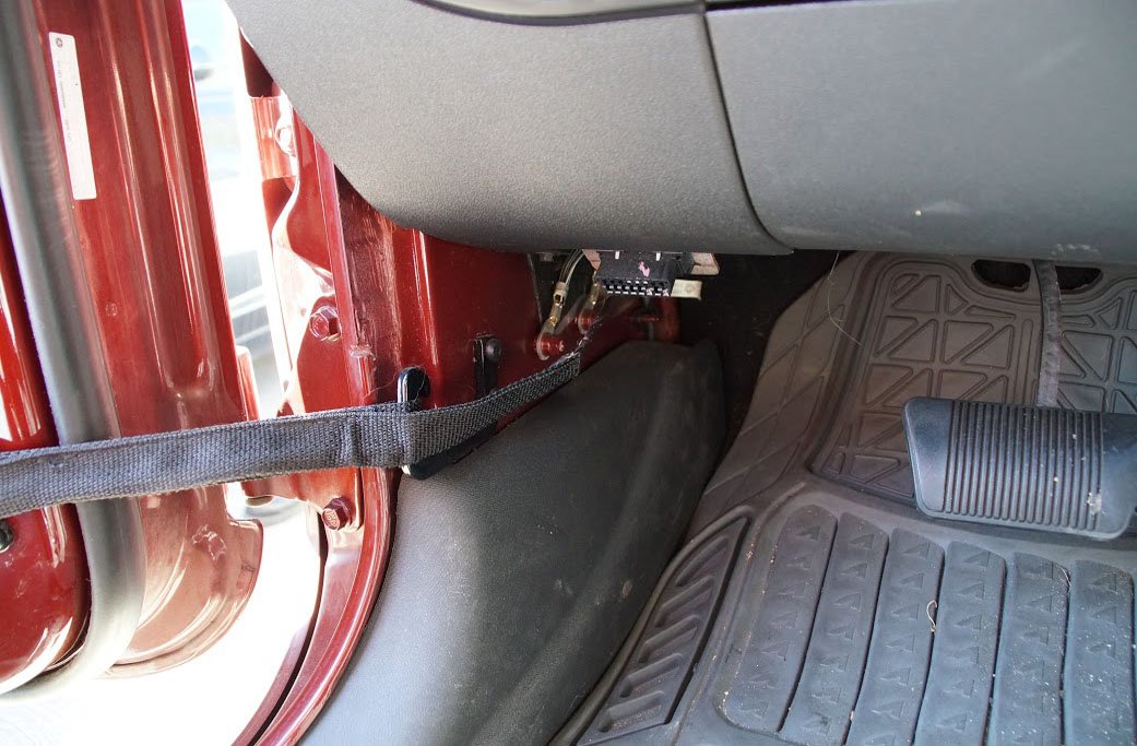

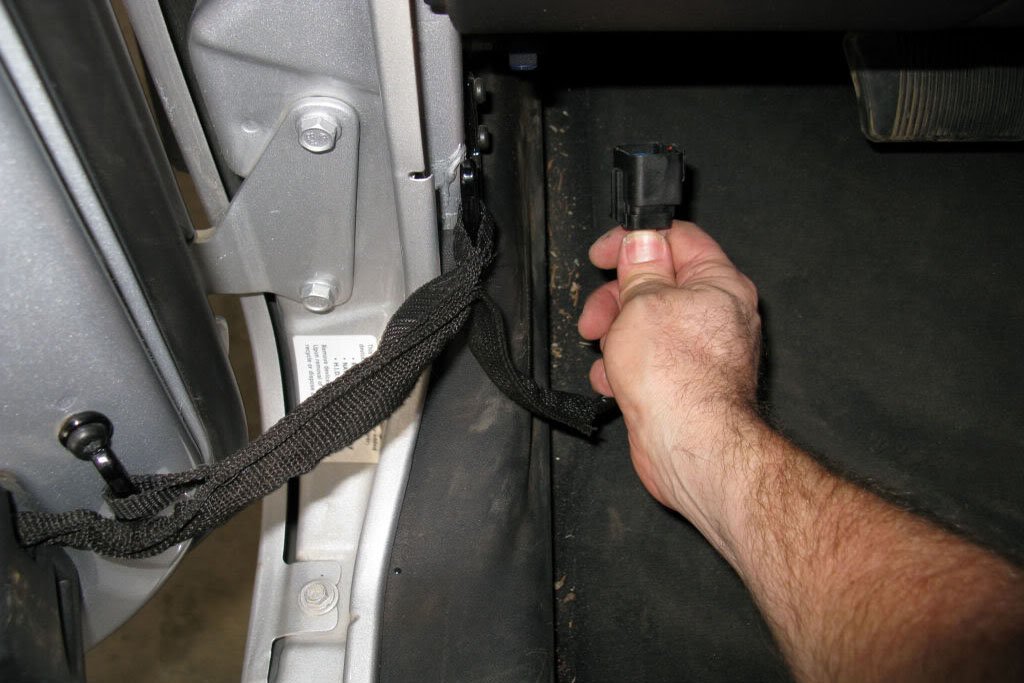

Roll down the window on the door you will be removing and open the door. Remove the strap connecting the door to the footwell; you can do so by pulling it up. Disconnect the electrical harness that runs through the strap by squeezing the tab and pulling it apart.
Figure 2. Pull strap up to remove.
Figure 3. Disconnect electrical harness.

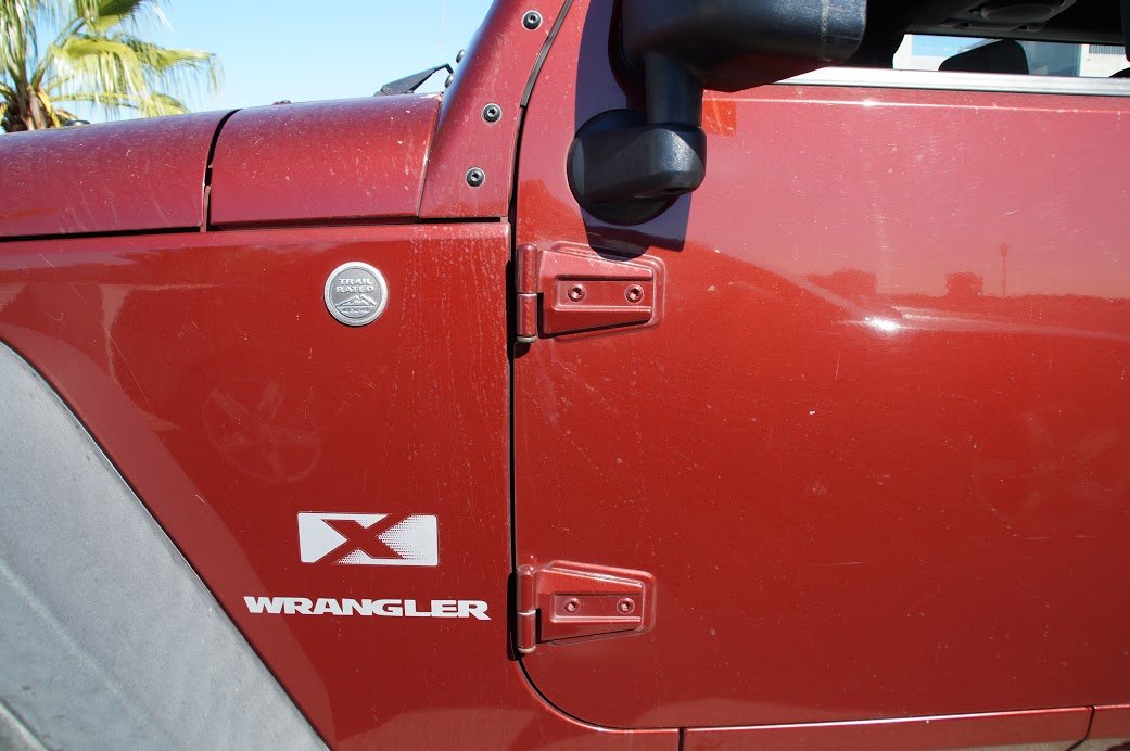

Step 2 – Remove hinges' bolts
The door is held in place with two hinges. Remove the Torx caps from under the hinges, then use your Torx bit to loosen and remove the bolts from the bottom of the hinges.
Figure 4. Remove hinges' bolts.
