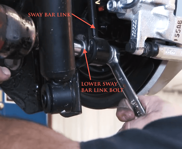

Step 2 – Remove sway bar link from axle
Locate the sway bar on the front of the vehicle and find where it mounts with the sway bar link to the front axle. You want to loosen an remove the lower sway bar end link bolt on both sides and put it aside. You only need to remove the bottom bolt.
Figure 3. Unhook sway bars.
