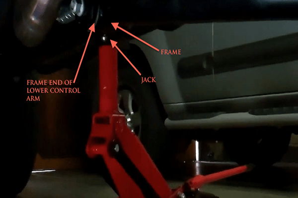

Once you have the frame end of the control arm into place in the frame bracket and the bolt installed, you can then place the axle end in the axle bracket. You will notice that once you get it installed, the bolt hole will be misaligned. That is okay. To align the bolt holes, place a jack under the frame near the frame end of the control arm. Lift up on the frame until you see the bolt holes align and then slide the bolt through the hole to install the nut. Do not tighten the bolt and nut yet.
Figure 6. Align control arm and frame holes.
Figure 7. Jack up control arm to align.
Figure 8. Bolt hole lining up.
