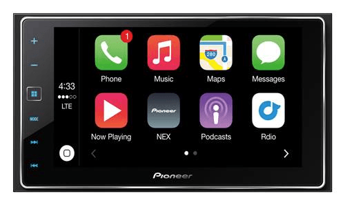

Step 1 – Choose your receiver
For a basic receiver, we recommend installing the AppRadio 4 smartphone receiver by Pioneer. It features a touchscreen display, Apple CarPlay, Bluetooth, Siri Eyes Free and a long list of other applications as well as features. Or, you could go with a more advanced receiver such as the Avic-NEX, which is also manufactured by Pioneer. It comes with a DVD player, GPS, a more sophisticated touchscreen and more.
Figure 1. Syncing up CarPlay.

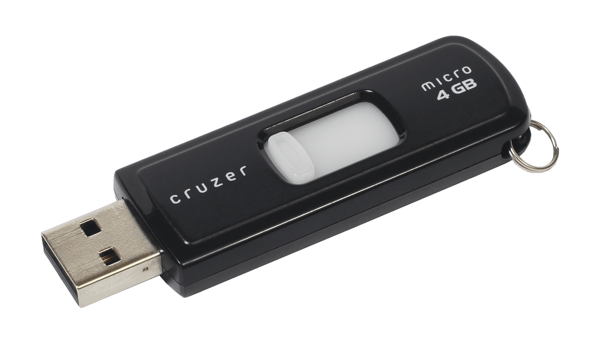

Step 2 – Download your firmware file
  • Save the firmware file to a flash drive.
  • Once you're done, head to your Jeep Wrangler and plug the flash drive into port #1.
  • If you used an SD card, go ahead and slide it into the SD port.
Figure 2. Save the information to a USB flash drive.

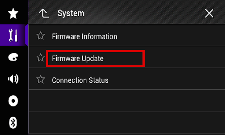

Step 3 – Access your menu options
  • Press Sttings.
  • Go to System Information.
  • Select Firmware Update.
  • Click through all of the on-screen prompts, including the warning screen.
  • Click Start, as directed on the screen.
  • Allow the unit to reboot (this step could take 5-10 minutes or more)
Figure 3. Select "Firmware Update."
