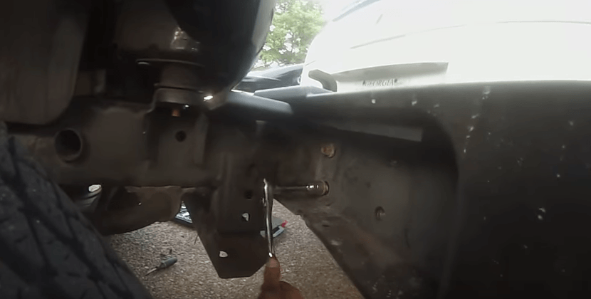

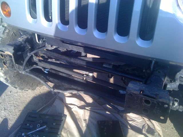

Step 1 – Remove front bumper
Remove the plastic shield from under the car. Remove the plastic clips by turning them counterclockwise with your flat head screwdriver. Slide under the front of your car, then remove all the bolts attaching the front bumper to the frame. There should be four total holding them together. Ask a friend to hold the bumper for you so it doesn't fall when you remove the bolts.
Figure 2. Remove bumper.

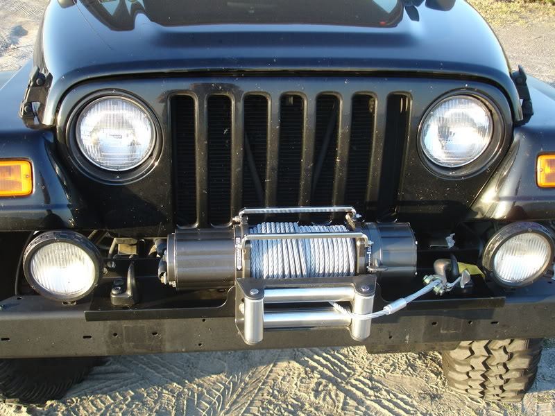

Step 2 – Install winch plate
The winch plate comes specifically for your Jeep Wrangler. It is designed to bolt on your frame, as the holes are pre-drilled in the right places. Use the bolts included with your plate and bolt it onto the frame. Follow the instructions on your specific winch; you will most likely use the same holes that the bumper uses, which doesn't mean it will be supported by the bumper.
Figure 3. Install plate onto frame.
Step 3 – Install the winch
The winch bolts right on the plate. All the holes should align, so use the included bolts, washers and nuts. Then tighten them together before you install the bumper back on.
Figure 4. Install winch on top of the plate.

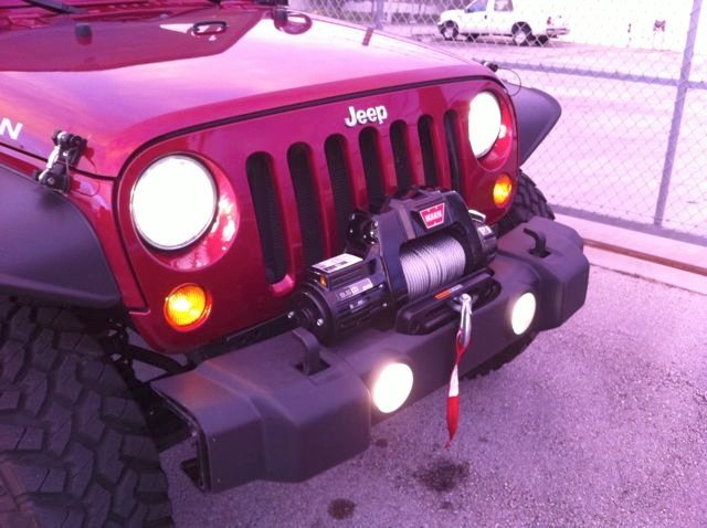

Step 4 – Install bumper
Install the bumper the same way you removed it. If you used the same holes to install the plate, simply align the bumper with the same holes and tighten them together as a whole. If you've mounted it differently, then mount the bumper the same way you've removed it. A friend can come in handy here to hold the bumper while you tighten the four bolts.
Figure 5. Install bumper.

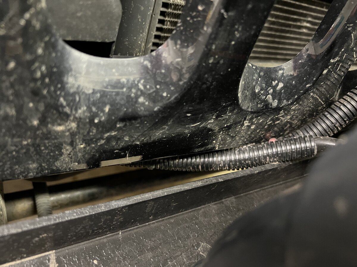

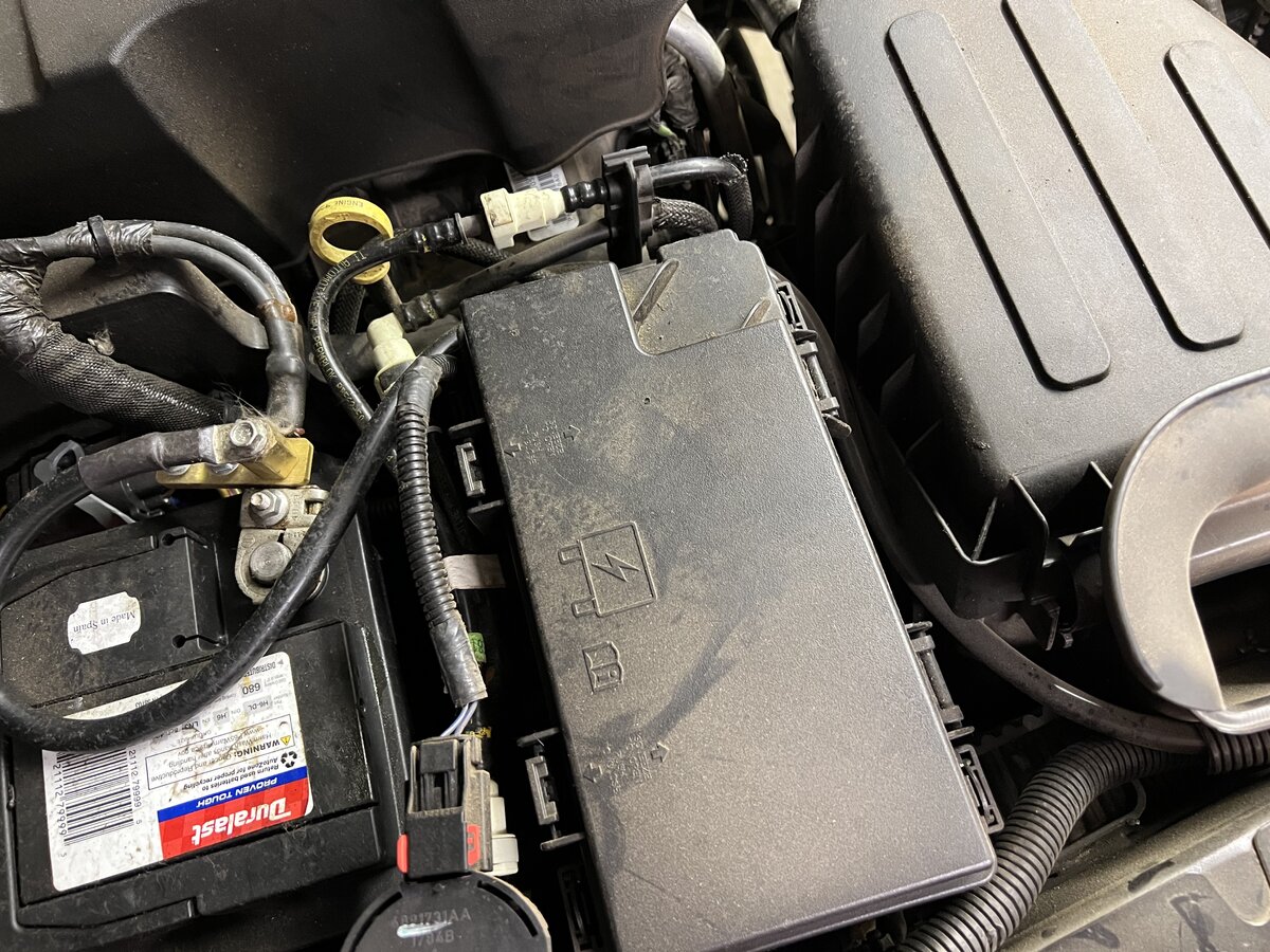

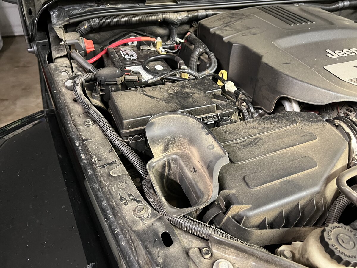

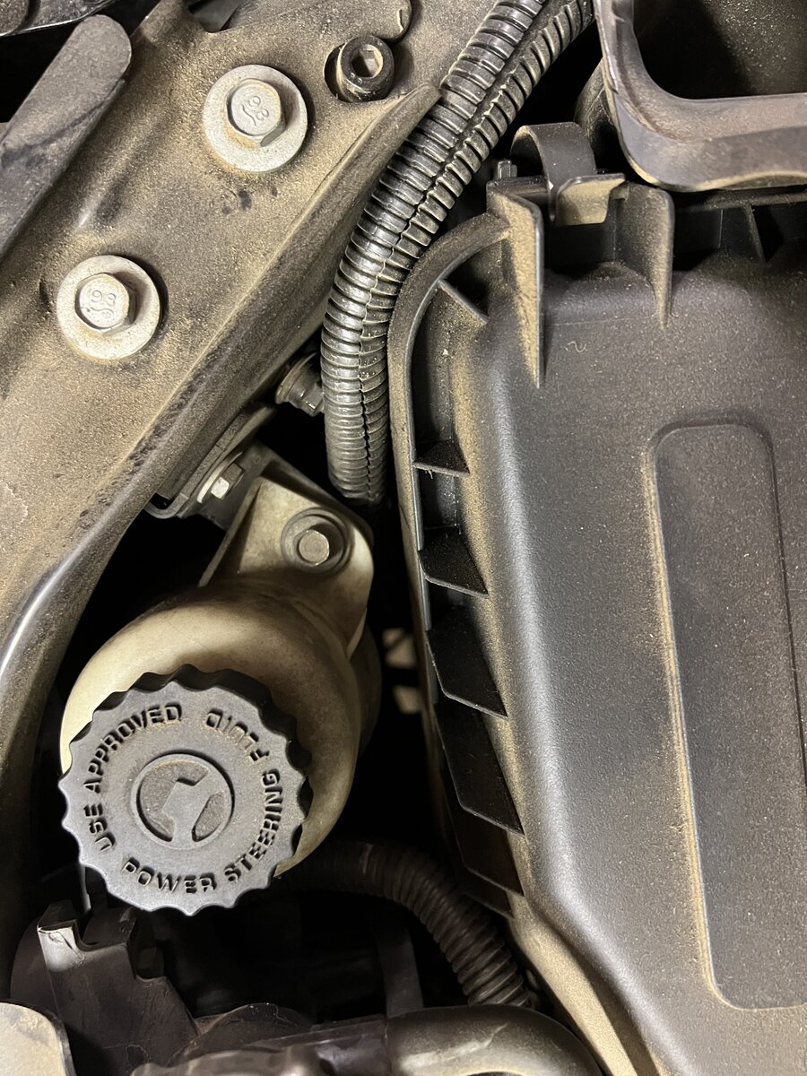

@PellstonJKR I routed mine down under the grill then back up by the headlights and alone the passeng side of the fender to the battery. Let me know if you want any picture. Oops just saw the picture request. Here are some. The negative wraps around the fuse box to the negative post. its hard to tell from the picture but they each are on the passenger side of the power steering reservoir. I put wire loom on them.
View attachment 120264View attachment 120265View attachment 120266View attachment 120267@PellstonJKR I routed mine down under the grill then back up by the headlights and alone the passeng side of the fender to the battery. Let me know if you want any picture. Oops just saw the picture request. Here are some. The negative wraps around the fuse box to the negative post. its hard to tell from the picture but they each are on the passenger side of the power steering reservoir. I put wire loom on them.
that's awesome, exactly what I needed, thank you thank you!!
