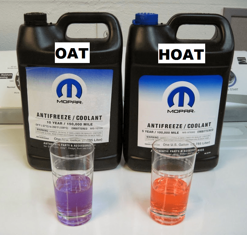

Refilling the cooling system with the correct coolant is of key importance when performing a cooling system flush on your JK. The 2007 to 2012 Wranglers use a HOAT (Hybrid Organic Additive Technology) coolant, whereas 2013+ Wranglers have switched to a OAT (Organic Additive Technology). Chrysler insists that these coolants are NOT interchangeable, and any mixing of the two can result in accelerated cooling system corrosion and overheating. HOAT formulas are a bit more common and are available at local parts stores as well as the dealership. Conversely, the new OAT coolant is currently supplied only through dealerships. In either case, two gallons of concentrate coolant (undiluted) will be plenty to refill your cooling system.
Figure 1. OAT vs HOAT coolant.
Pro Tip
Notice the color difference in the two different coolant formulas. This is to prevent accidental mixing of the two.

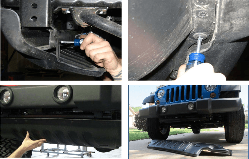

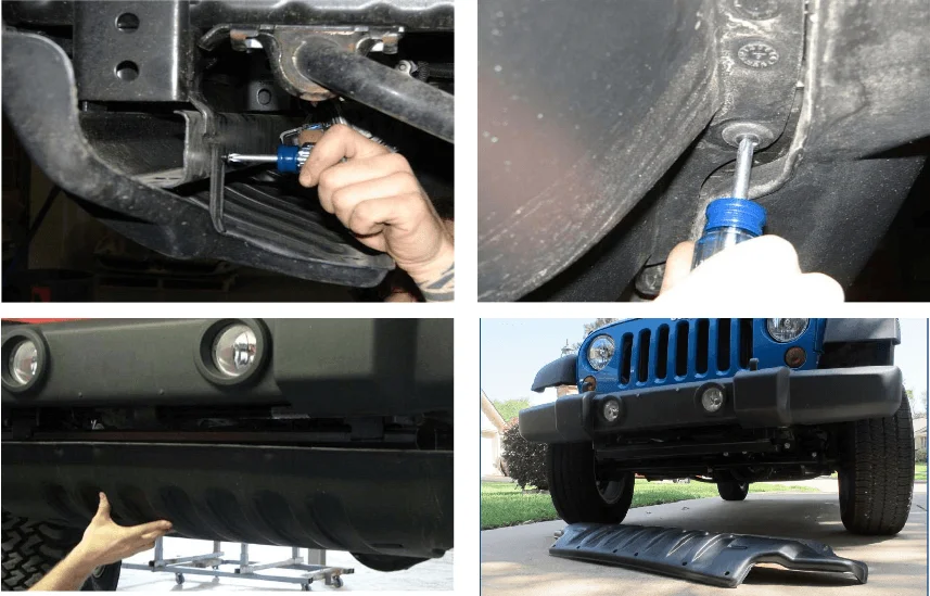

To best access the radiator drain cock, removal of the skid plate is recommended. Simply remove the "scrivet" type fasteners by using a Phillips screwdriver to back out the screws. These fasteners have a tendency to spin when attempting to loosen the screws, so holding a flat screwdriver or similar tool under the base of the fasteners will prevent them from spinning. Newer model Wranglers will have plastic push-pins instead of the scrivet fasteners.
Figure 2. Skid plate removal.

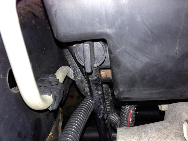

Attach a piece of vinyl hose to the radiator drain cock located at the bottom of the radiator on the passenger's side.
Figure 4. Hose attached to radiator drain cock.

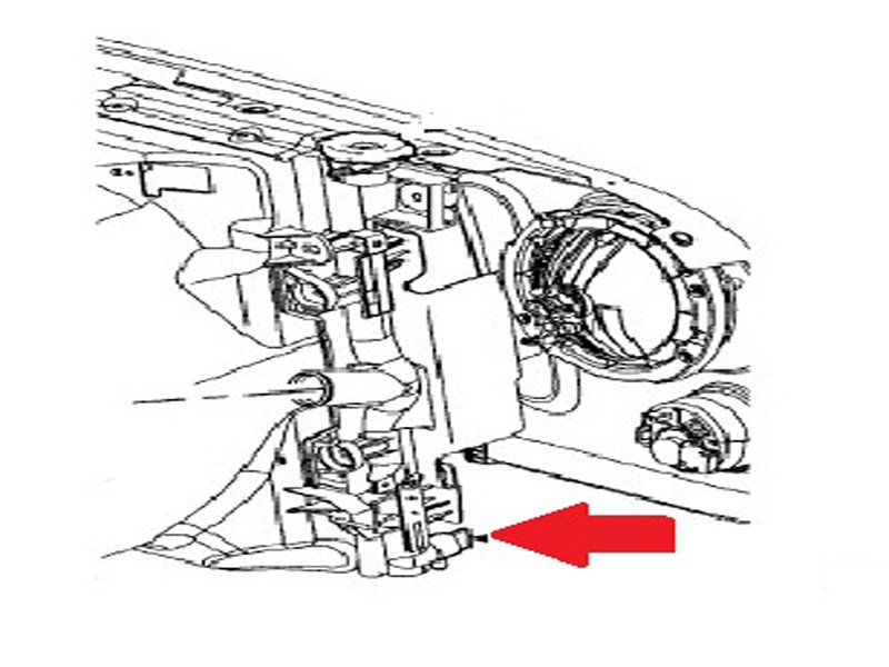

Figure 5. Diagram of drain cock location.

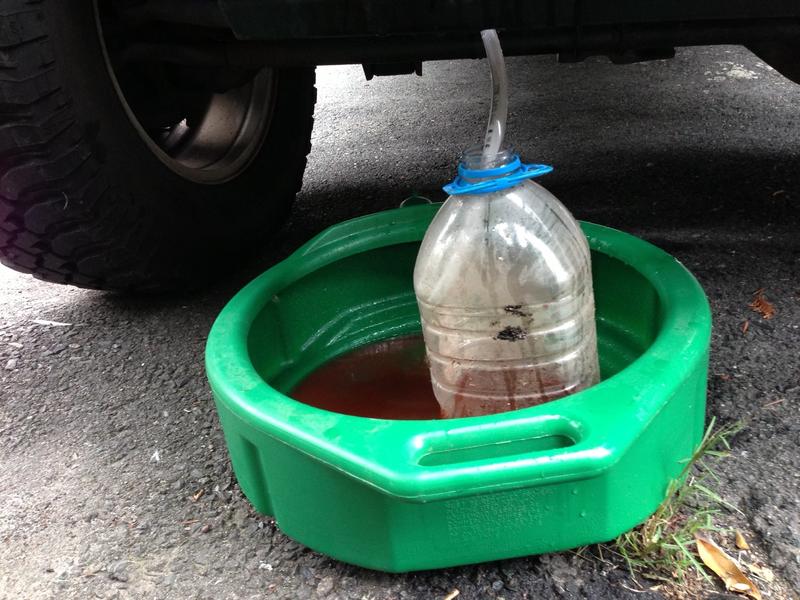

Open the drain cock to begin draining the coolant. The drain cock only needs to be loosened approximately 1/2 turn to allow coolant to drain. Have a catch pan handy to collect the emerging coolant.
Figure 6. Coolant draining into catch pan.

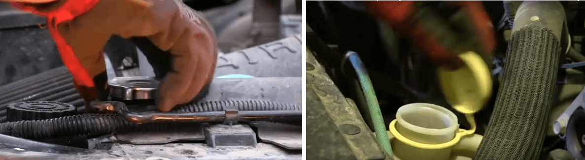

Removing the radiator cap and coolant expansion tank cap will introduce air into the system, allowing the coolant to drain at a much quicker rate.
Figure 7. Radiator and expansion tank cap removal.

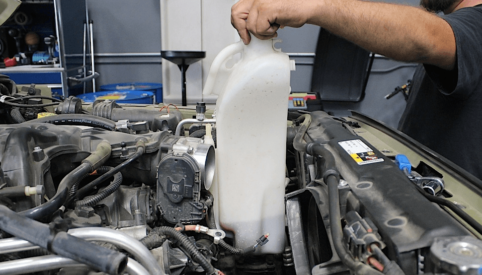

While the coolant is draining, it is recommended that the coolant expansion tank be drained of any coolant. This can be accomplished by sucking the coolant out with a vacuum pump or by simply removing the tank and dumping the coolant.
Figure 8. Coolant expansion tank removal.

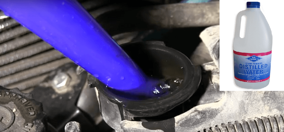

Although the cooling system capacity is just a touch over three gallons, only one to 1.5 gallons (including expansion tank coolant) can be drained from the cooling system. To remove the rest of the old coolant, several flushing cycles will be needed.
Figure 9. Filling system with distilled water.

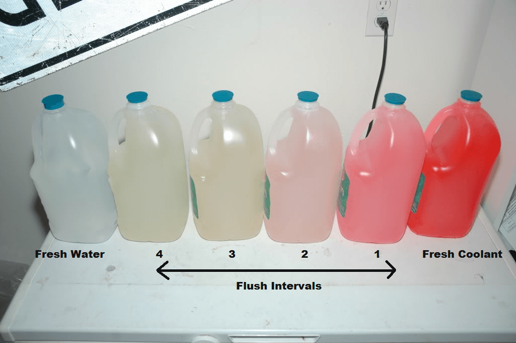

Figure 10. Color of coolant after each successive flush.
Pro Tip

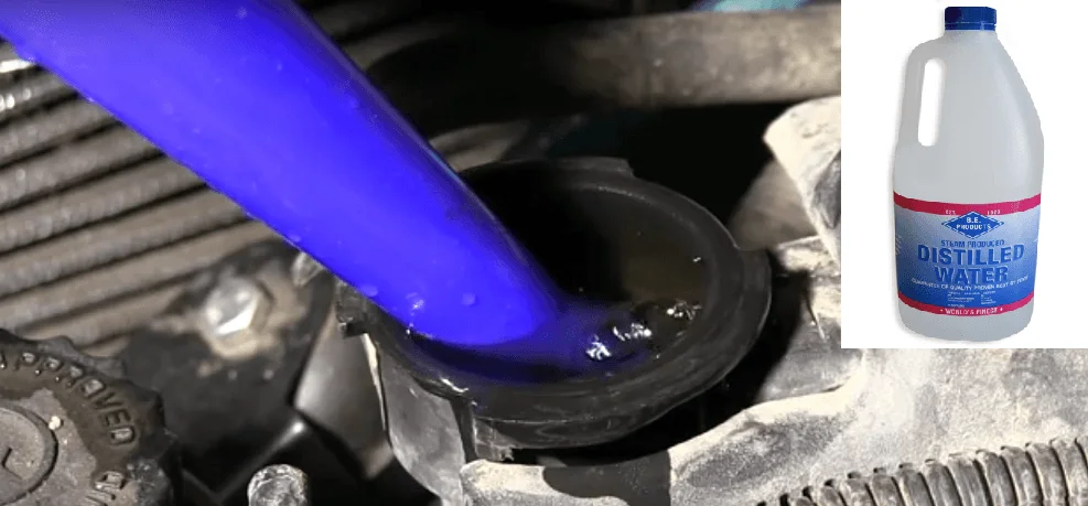

Step 3 – Fill with water and start car
- Fill the radiator with distilled water. While a regular garden hose with tap water can be used, distilled water is preferred as it contains no minerals. Since the system cannot be entirely drained, a portion of water will remain in the system and eventually be mixed with the coolant concentrate.
- Fill the coolant expansion tank approximately 1/3 of the way with distilled water.
- Leaving the radiator cap off, start the vehicle and turn the heater to the fully 'ON' position.
- While the car is idling, top off the radiator as needed before installing the cap.
- Allow the car to run for approximately 5-10 minutes to allow it to reach full operating temperature. Once warm, shut the car off.
- Allow the engine to become cool to the touch before proceeding to Step 4.

- Now that the distilled water has mixed with the old coolant in the system, proceed with draining the radiator as outlined in Step 2.
- Each drain interval will produce cleaner water containing less coolant.
- Once the water has drained, proceed with refilling the system with distilled water as outlined in Step 3 and run the vehicle through another heat cycle. It is recommended that the system be flushed at least two to three times. Some individuals prefer to flush until the draining water is completely clean.
