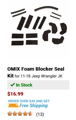

This is an option as well. I had a couple annoying small drips from the Freedom panels and I replaced each piece provided in this kit. No more leaks.
Remove the panels and lay them inside up across a couple sawhorses with a towel or piece of carpet over them so as not to scratch the top paint. If the adhesive from the old seals is a problem, rubbing alcohol or nail polish removers works to get the old adhesive off.
