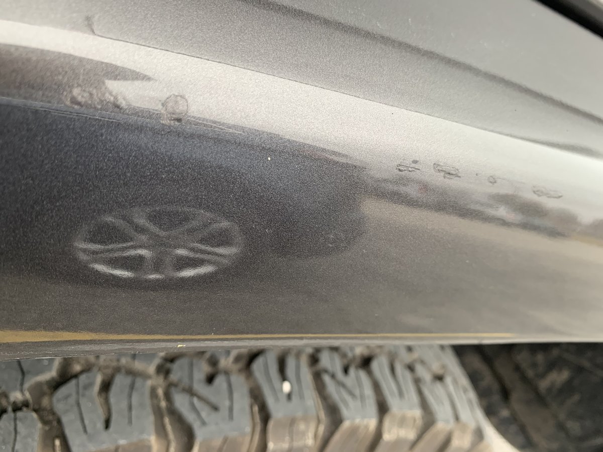

Here is a shot of the top of the fender. Also a few more on the leading edge. Pretty minor so I don’t want to make it worse. If I can sand the bumps from the paint pen down and scuff the clear a little I’m hoping that a new coat or 2 of clear will lay down and make these look mostly invisible. But if it’s going to make things worse, I may just leave it alone. Then again, if I screw it up I have an excuse to buy some new fenders. Haha
Ahh, looks like it was taken down to bare metal and someone touched them up. You could try adding some clear coat to those areas and then polishing it, but it's going to be really tough to get those to look much better than they already do.
