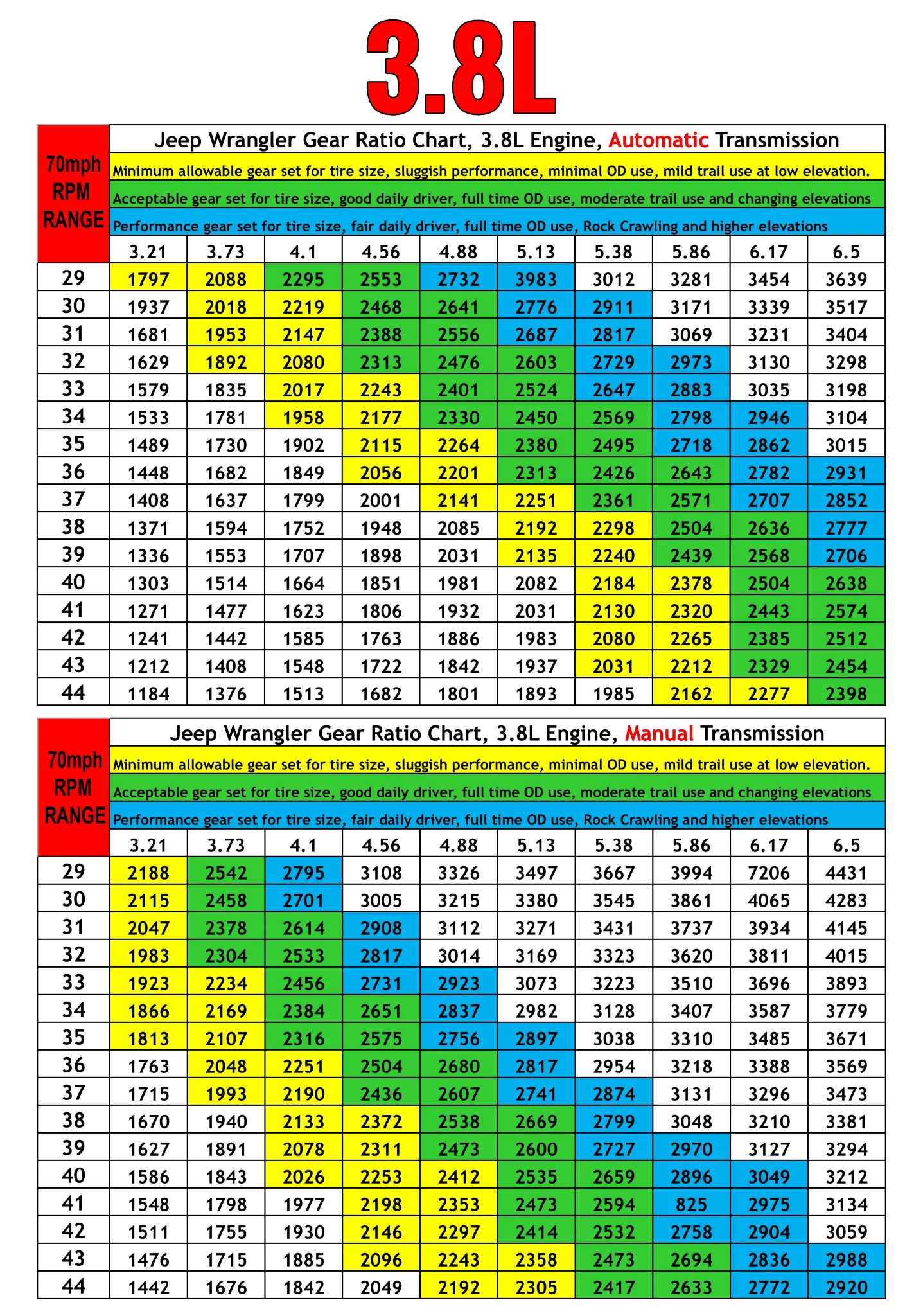

but I noticed the engine RPM was 3000 @ 70-75 which seems high to me
Seems high for OEM gears based on this chart for 70mph. 35s and a 5.86 would be about 3000rpm at 75mph:
