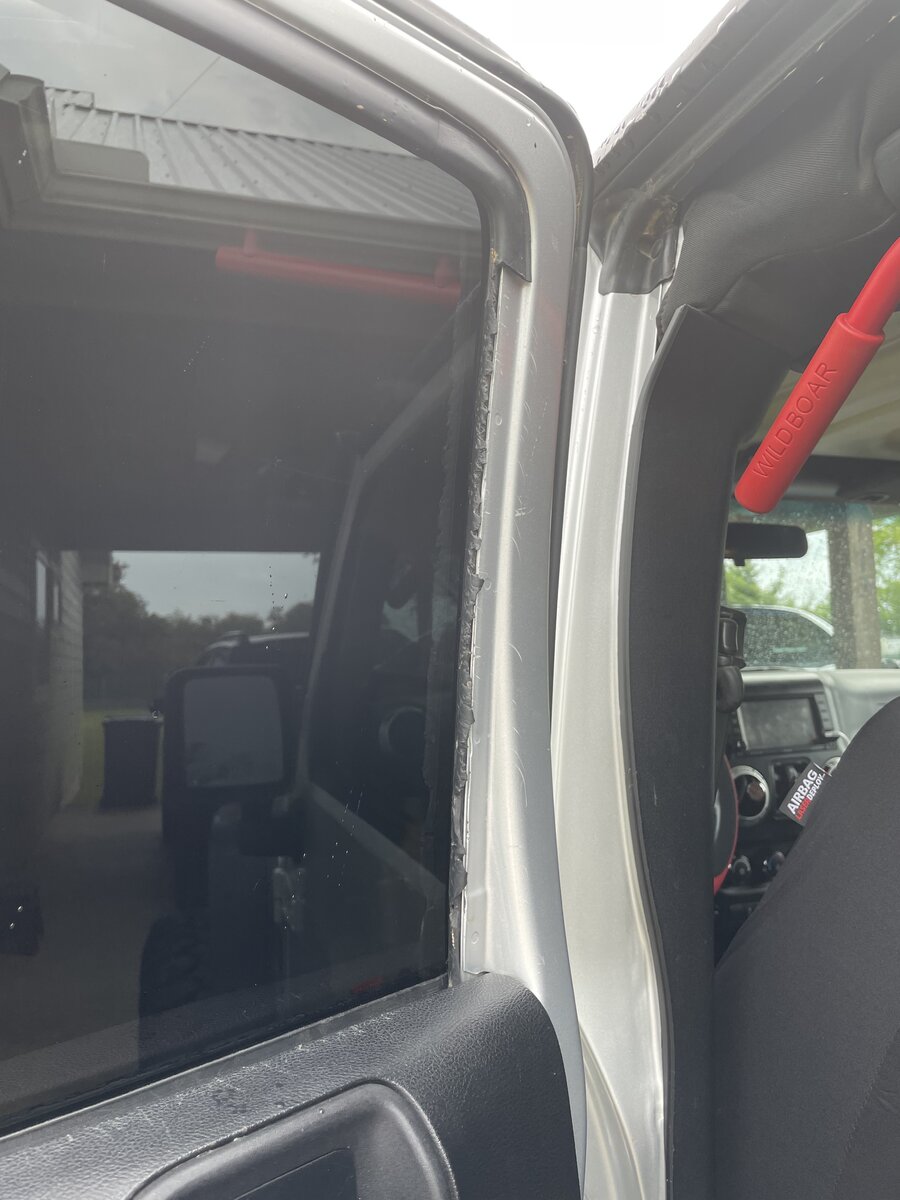

Hello! New to Jeep ownership and I’m looking for help on replacing the seal around the driver rear vent window. The previous owner’s dog chewed one side of the seal and I’d like to replace just that small piece, but I wasn’t sure if I had to buy the entire glass assembly.
