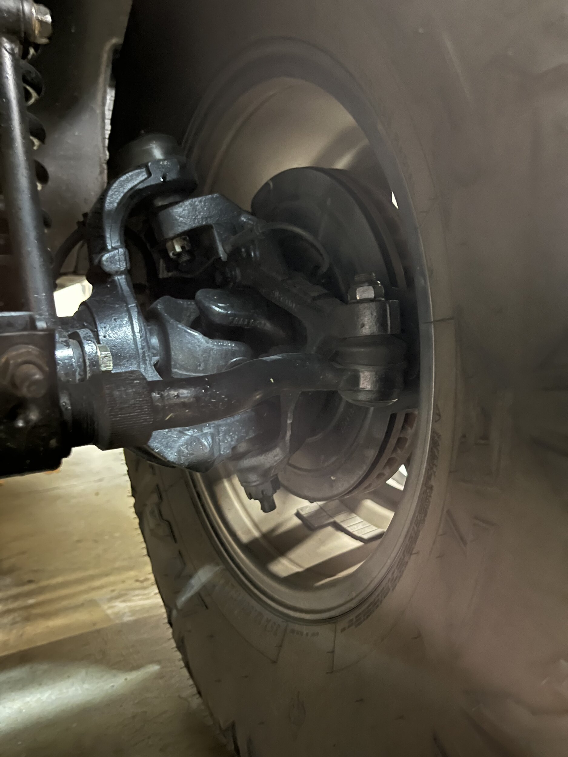

I have a 16 Rubicon with a 3” fabtech spring lift (I inherited) and just had steering inspected. All stock with exception of lower control arm bracket drop and RC adjustable track bars front and rear with rear trackbar relocation bracket.

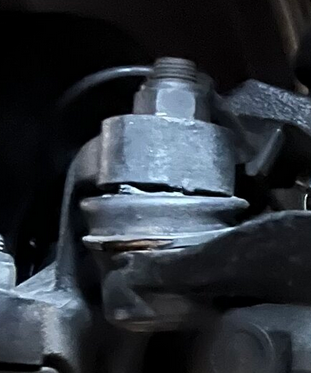

I go over a bump with right tire and wheel shakes back and forth 2-3 times then stops. At highway speed steering tracks well and does not wobble. It does not do this when I go over a bump on left tire. I had offset ball joints installed (at recommendation of alignment guy) to give me lots of caster adjustment. It has been aligned and everything torqued and re-torqued. Still have the bump steer.

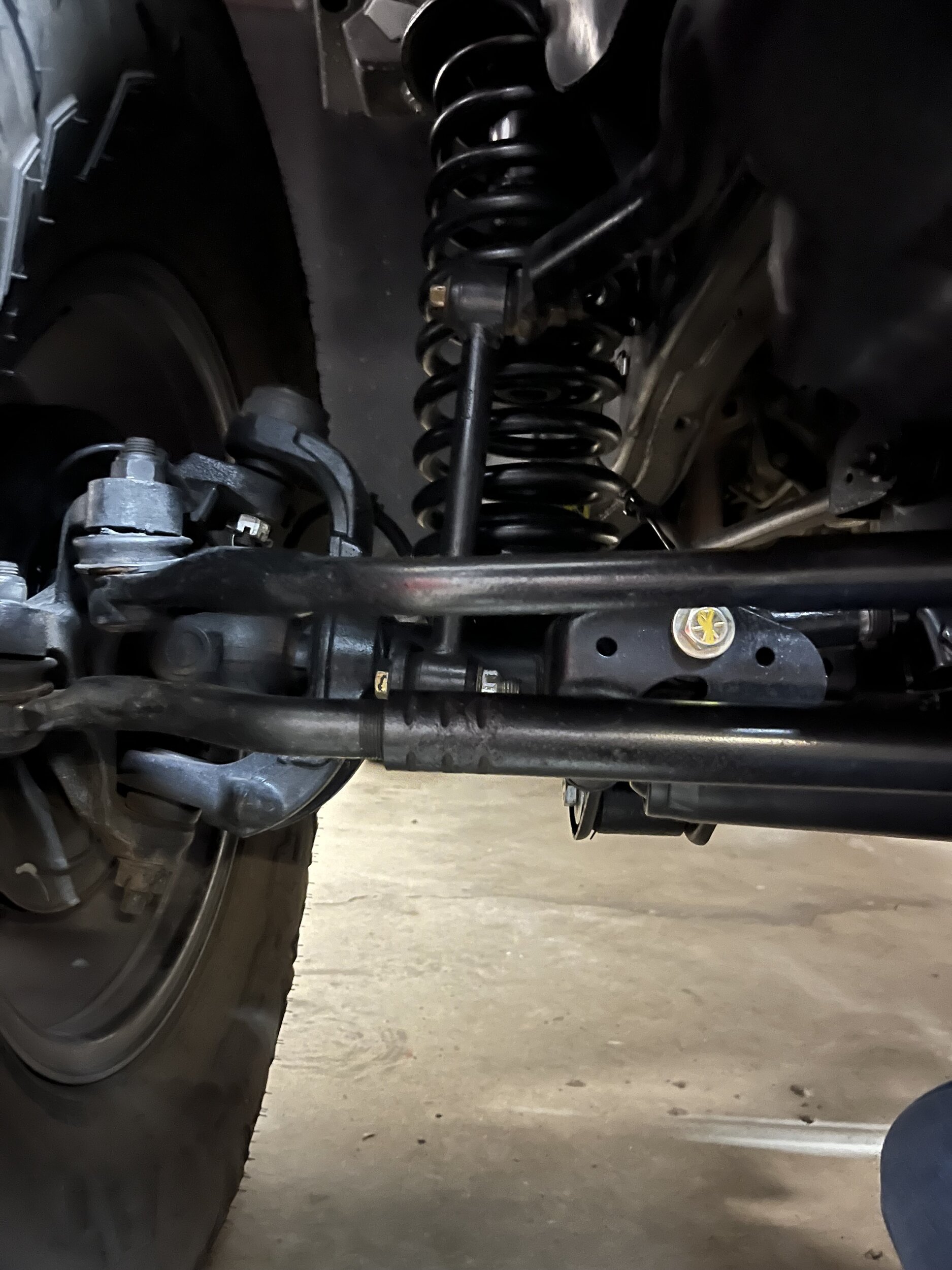

If anyone is able to see anything not at correct angles based on my pics, please speak up. This is driving me nuts. My alignment shop is the most recommended in town, as thst sll they do. Alignment tech says it is all tight and correct, but recommended a double steering dampener setup. That was a red flag to me he is not do great maybe.

Looking at your pictures, your sway bar links are way too short. The tips of the sway bar should be above level, not below. Under full extension with the current ones, they can cause some serious damage. Aftermarket adjustable sway bar links now!

The sway bar end links are what came with kit I believe, and is actually sitting level. I specifically asked alignment tech and he said they are where they are suppose to be. Hmm, he claims they don’t do much anyway. Thought that was an odd thing to say frankly.
Additionally, i have a Rubicon with the swsy bar disconnect feature. Not sure that that matters if they are actually too short or not.

Steering dampeners do not fix anything, they just mask the symptoms. They are the equivalent of me shooting someone full of morphine for their broken arm arm and then sending them home without setting or immobilizing the fracture. And sway bars do a LOT. The statements from your alignment guy suggest you need a different shop. One that does 4x4 vehicles. "Most recommended" by 1,000 people with bone stock cars says nothing about their knowledge or ability when it comes to modified vehicles.
If you're getting even a minor amount of death wobble or bump steer, you've got something loose, worn, or misaligned. It could be in the front or rear.

Bump steering can be checked by standing on the front bumper and bounding up and down some while watching the top of the steering wheel through the windshield. If the steering wheel moves side to side, you do have some bump steer. That's generally caused by the drag link and track bar being out of parallel, which causes them to travel different lengths of arc as the wheels move vertically.

The back and forth movement of the steering wheel when you jump up and down on the bumper now. That should not be there. It suggests the track bar and drag link are too far out of parallel. Quadratech has a couple of good illustrations about this:
https://www.quadratec.com/sites/default/files/knowledge_based_articles/tjsteering(1).jpg
https://www.quadratec.com/sites/default/files/knowledge_based_articles/bumpsteer1.jpg
The photo is of a tj set up, but the geometry issue is the same. The two try to swing different length arcs, pulling the wheel differently, as the diagram shows. The trouble would be that one of those units is too short, or is bent, which shortens one arm with respect to the other, or was not adjusted when your jk was lifted, then that could be your problem.
