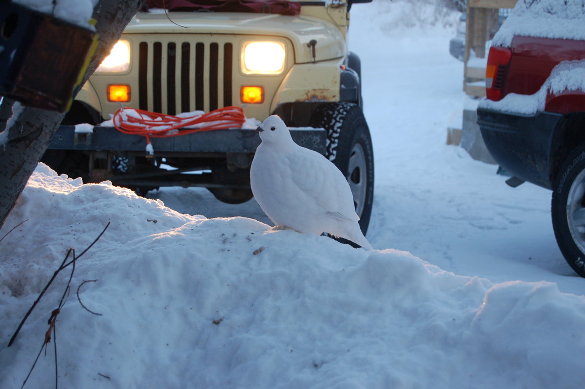

One thing about the NWT, when it dips to -70F which is -57C, there is virtually no wind. Incredibly peaceful. But it was still colder than -45C since both Canadian North and First Air flights were grounded for a few days. Canadian North jets were certified to -40C, First Air to -45C, if you came to Yellowknife on business..... you got an extended northern experience.
And yes, you need a system to start a car anytime it dips below -40. I sold my FourRunner since EFI does not understand that cold temperature. Unplugged EFI would just flood the engine. And when EFI floods with a fuel pump putting out at least 85psi you must change the oil. -40, change the oil you need a shop. And in the NWT it'll cost double what an oil change down south costs so I sold it and bought a 4.2L YJ with a carb. Every morning, pull the air cleaner, dump in some raw gas, pump the pedal like crazy, turn the key. It started instantly every time and by the time I had the air cleaner back on and hood closed the tappets had quit clicking and the oil pressure was reaching the head. I kept a pickle jar of gas behind the brake booster.
We lived in the NWT as snow mobiles were introducing 4 stroke engines. A dozen of us would spend the night at a cabin, in the morning the guys with 2 strokes, pump the primer, close the choke, starts every time on the second pull. The guys with those fancy 4 strokes had to plug into the generator for an hour to start them.

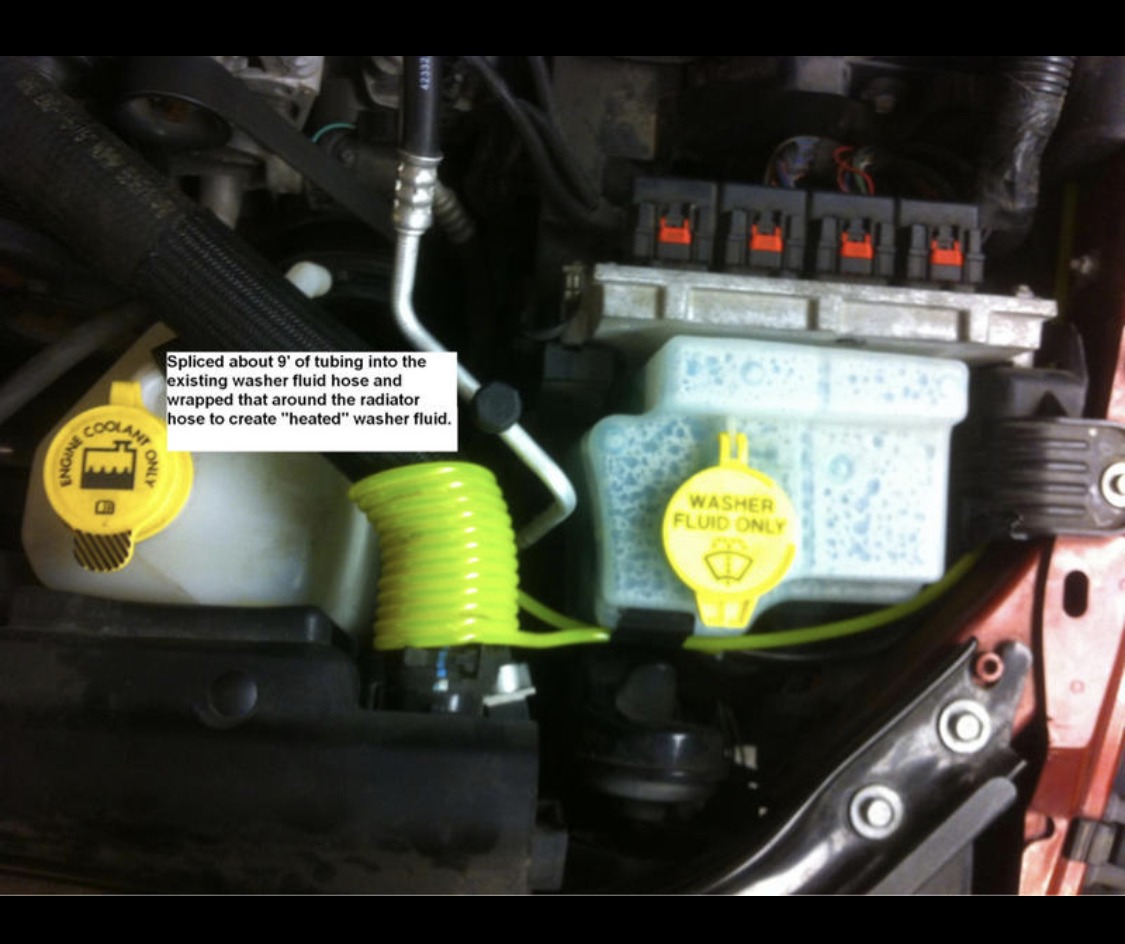

Block heaters heat the block so mostly just the oil gets warmed. Even if the water warms up a little as a side effect, its not circulating so it wouldn't heat the radiator or hoses. I think I'd suggest a heat blanket around the washer fluid res and tie it in with a 120v splitter to the engine block when you plug it in. That still doesn't take care of your washer hoses but I reckon you could run a small heat tape along the hose and tape it all up.

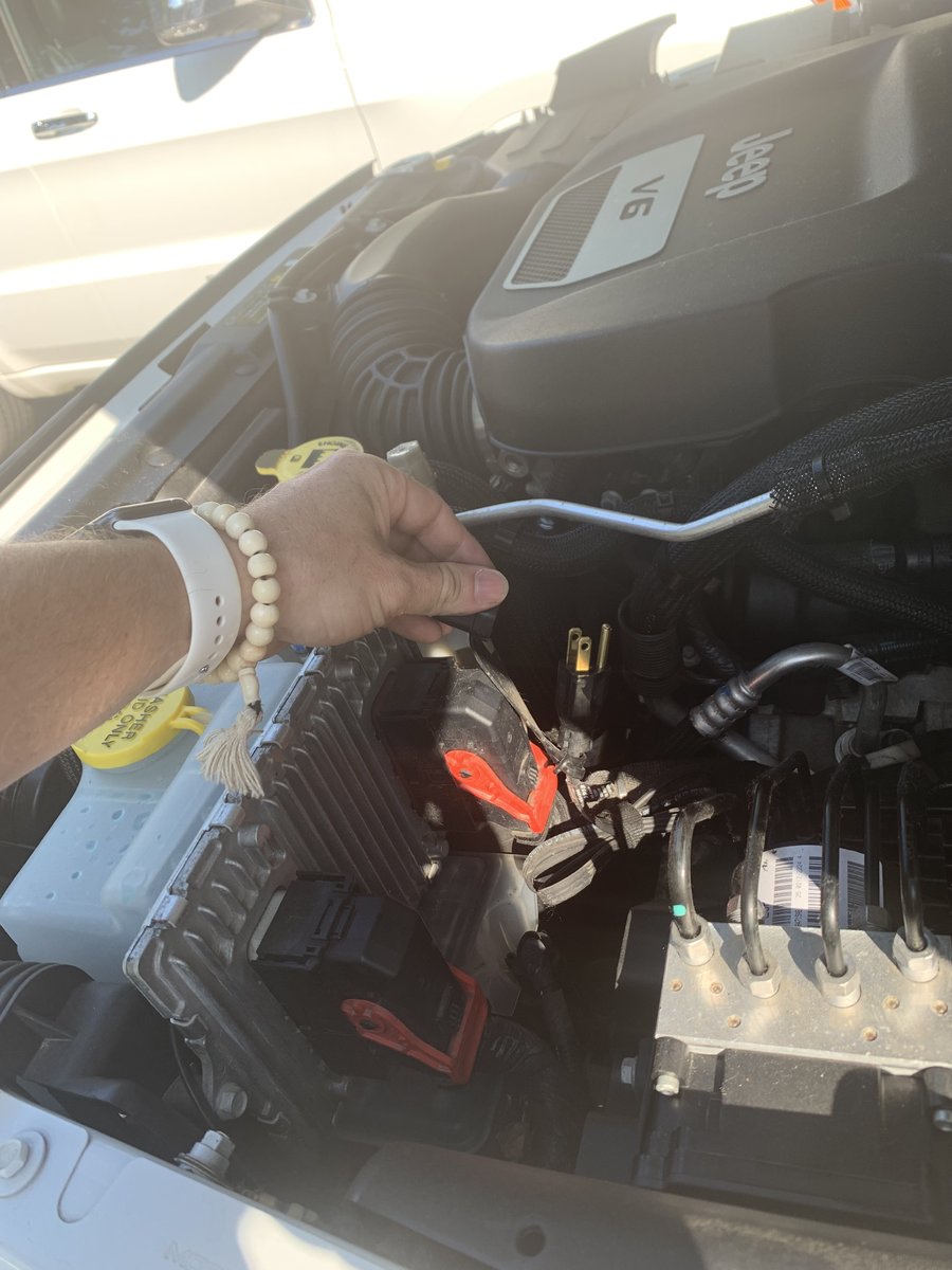

A JK's block heater doesn't go into the water jacket. It simply sits in a hole on the outside of the block.
