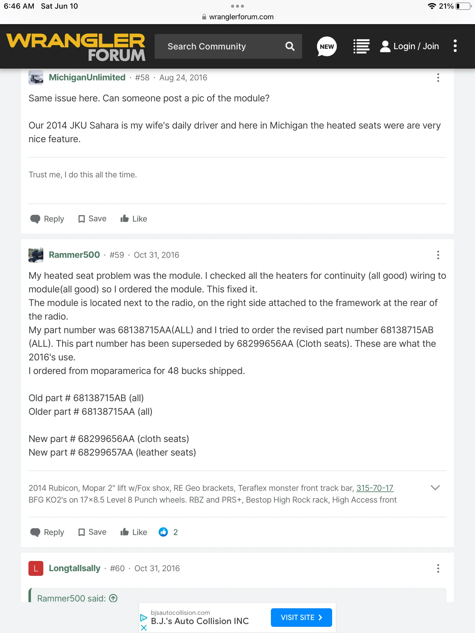

2014 jku rubicon with factory heated seats. So the the passenger seat works flawless but the drivers Seay does not. When you push the button it stays on until it starts to warm up then shuts off. If you push it again it shuts off again in a second or 2. Any ideas or causes?
My guess it would be the switch getting hot and it's shutting down. The drivers side is probably used more then the passengers side.
