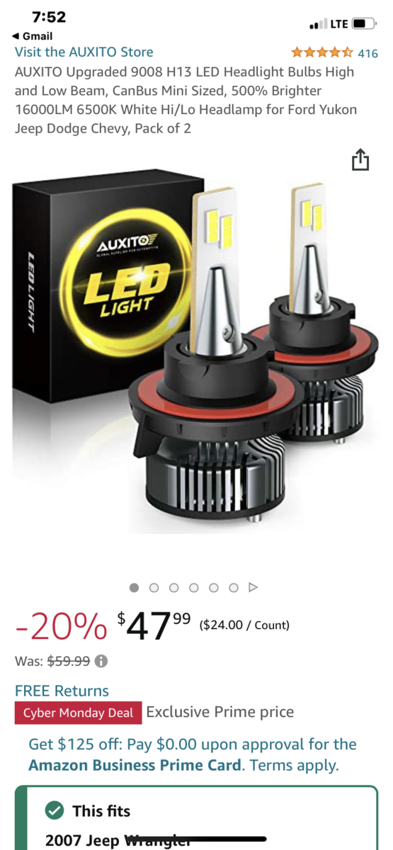

Whats up guys......I was looking into replacing my stock bulbs for my headlight on my JK. Any LED bulb only brands you recommend. I dont want to change the whole housing I just want to do the bulbs. Have never had luck with LEDs in the past but want to give it another shot becaue the stock headlights are so bad. Thanks!

Because of the way the bulb type LEDs work, I don't think there are any that would actually work well. I tried a few with no success. Full replacement is really the only way to go. You can get them pretty cheap on Amazon and it isn't much more work beyond replacing the bulb.
